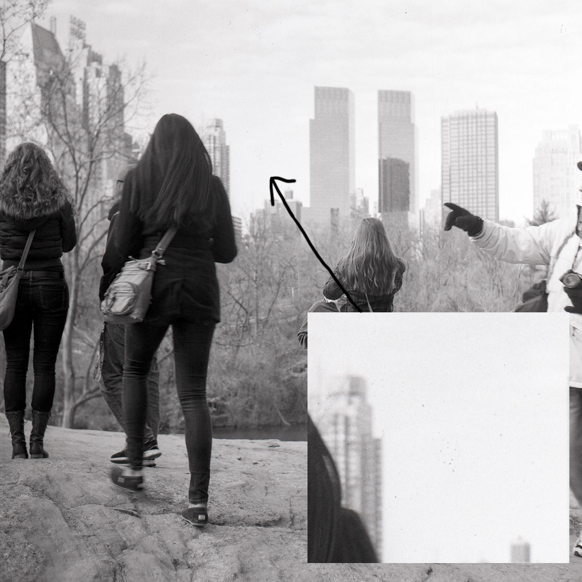

I recently went for a walk in the park and decided to shoot some Foma 200 in my Rolleiflex. I developed it with Rodinal 1:100 stand for a hour with 3 inversions at the half hour mark. When the negatives dried I noticed some had these black spots on them. I've never seen them before with Foma. Any idea what it could be?
They are all over the negatives, I just highlighted one spot.

The 200 is a completely different emulsion and base from 100 and 400, as far as I know, and they did have a lot of start-up trouble with that film. I haven't had any personal trouble with rebranded 400 in 120 format, but it's recent and I've not yet run that many rolls.

Try another roll and don't use stand development which can emphasize defects. Try Rodinal 1+49 instead.

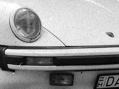

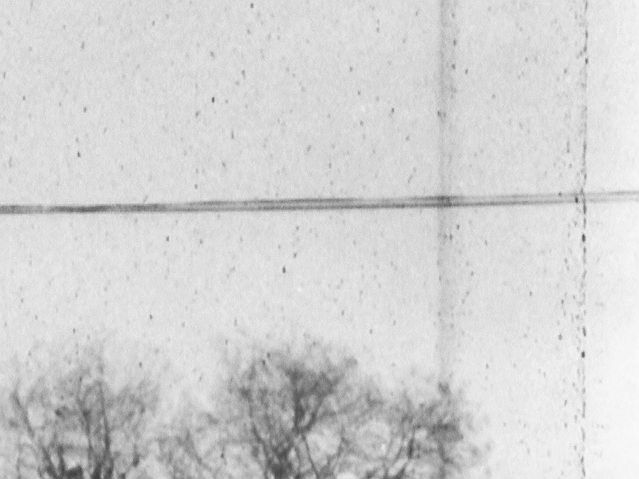

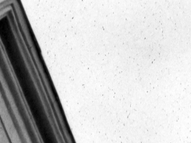

I had problem too with Fompan 200, there were a lot of black spots on the film.
I read that the expiration date of affected films is 12/2013 and the problem has been corrected by Foma, films dated to 2015 are OK.
I tried a roll of 2015 exp. date film but I got almost the same result. :sad:
