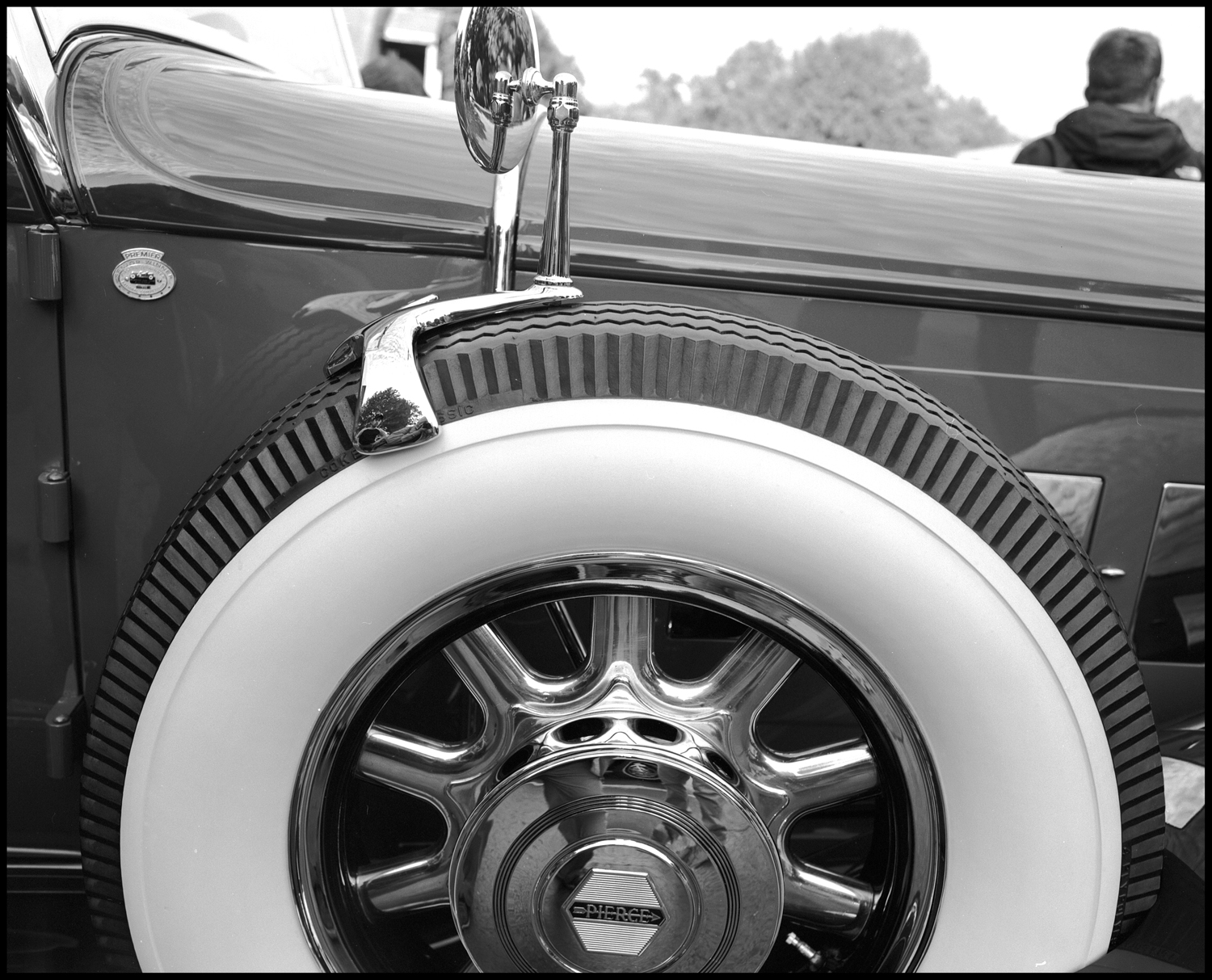

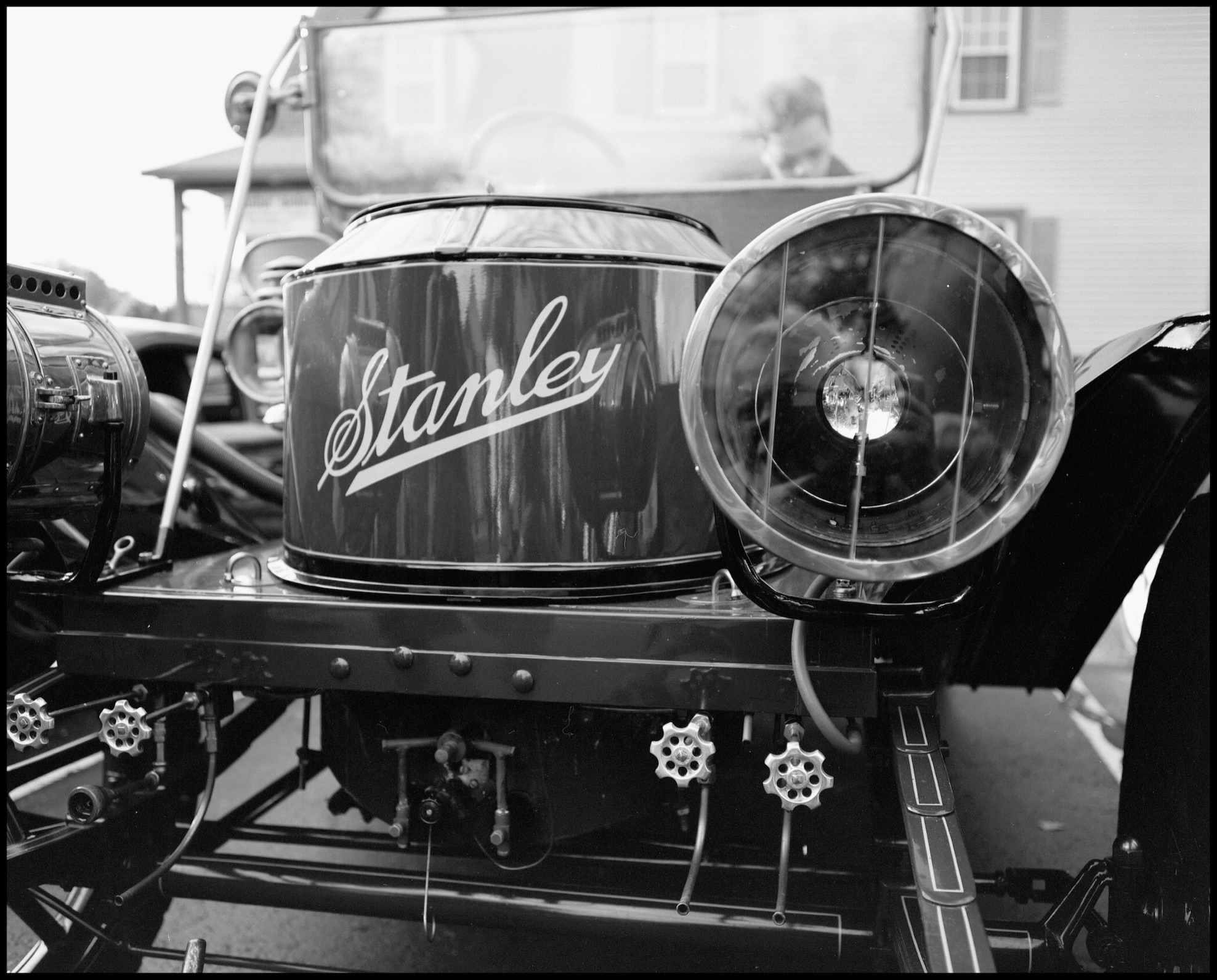

I’ve used UFG on a variety of films, including Acros, over the past few years — it’s quite an interesting developer. I’m attaching a couple of photographs taken on 120 Acros with a Plaubel 67 Wide at a Cars ‘n’ Coffee in 2017. Here are my developing notes made at that time: “Develop in Ethol UFG (3rd use) straight, in Combina narrow 120 film tank, 450ml, 22 Centigrade. No pre-soak. Total development time 5 minutes 45 seconds. Agitate first thirty seconds, then five seconds every 30 seconds — tilt tank at 45 degrees around the four cardinal directions for the first 2 1/2 minutes, thereafter tilt twice forward/back or side/side. Water stop bath, then PF TF-4 fixer 5-6 minutes fixing with intermittent agitation. Rinse, hypo clearing agent for two minutes, then running water (fill/agitate/dump). LFN and PhotoFlo in tap water, hang to dry.” I hope this helps.
0197417A-BB11-4A2E-B187-422598FDFE71.jpeg 0CC4C8D0-C7ED-4627-B918-F7CCF582D5F0.jpeg
