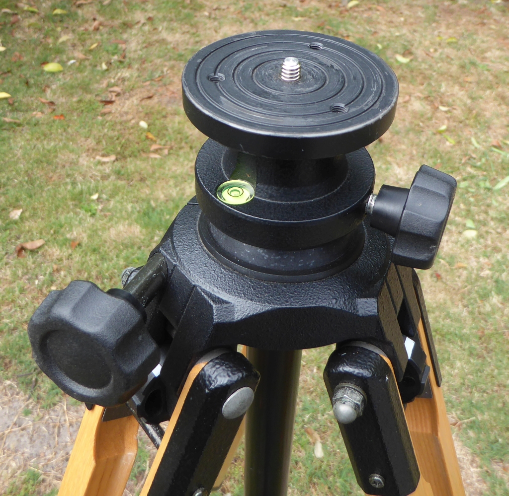

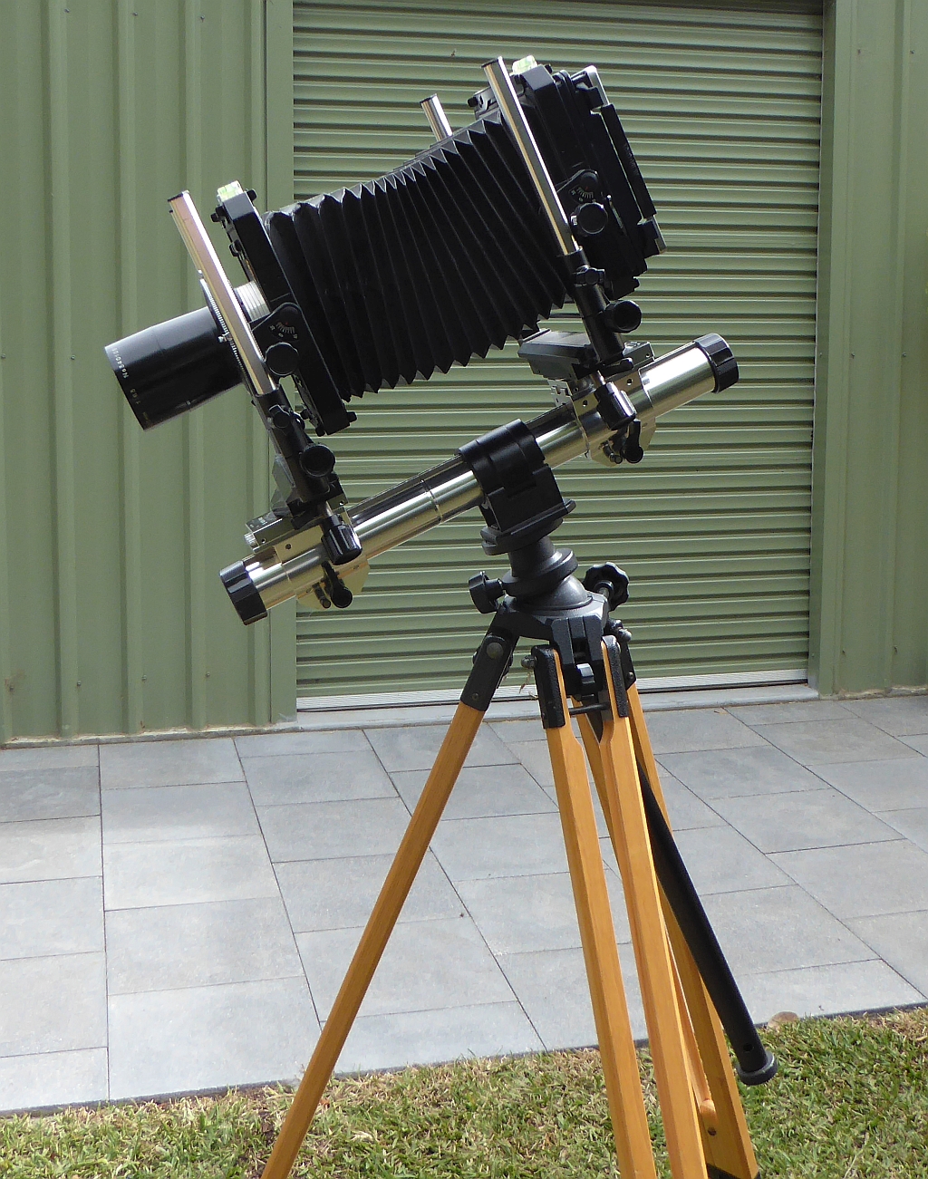

I have the Berlabach Report 3042, which appears to be identical to the current Report 302; I think they dropped the third number on these tripods quite some years ago.
Mine has the centre levelling ball in the head, which to me is really good. It allows me to set the tripod up with the legs in their best position, sometimes in cracks or holes in pavement, then after getting the head more or less even, one then very quickly positions the centre ball to get the spirit level showing level, one is then able to attach the camera and off you go. This is a very speedy set-up system, which in an urban environment can be an asset; it is to me.
One thing I would suggest is to get their steel chain accessory, which simply slips onto each leg. This stops the rubberised feet slipping or sliding in ways you don't need or want. Or, you can manufacture one yourself out of various materials.
I mainly use this tripod with my Shen Hao HZX45-IIA camera, average weight of camera and lens would be around the 3.5kg to 4kg mark. It works very well with this camera size in all situations. I also use it with my Toyo 54G, (shown below) which is a somewhat heavier monorail, it does the job, but with the camera and other stuff somewhere around 7kg-8kg with various lenses the tripod knows its working, but handles the weight well; if you know what I mean.
My tripod came with a 100mm centre column, I have the accessory 500mm centre column, it takes a minute or two to change them over. After about 10 years of use, I decided to leave the longer centre column in as for all intents and purposes, the extra weight was minimal.
For vibration absorption, this tripod is the most vibrationless tripod I've personally owned.
The Achilles heal of this camera is that it doesn't fold up super small, apart from that, I think it is perfect for my usage.

I’ve got a Berlebach Report 9033 (now called a 933) which like Mick’s has a levelling base that’s a huge time saver...no need to fuss around getting the legs juuuuust right for the camera to be level. Especially useful if panning to take several photos or taking slight variations side to side.
It goes a bit taller and is a bit heavier than the one you linked to.
Got it in the darker colour and it’s one of the most beautiful and functionally satisfying bits of gear I own.
