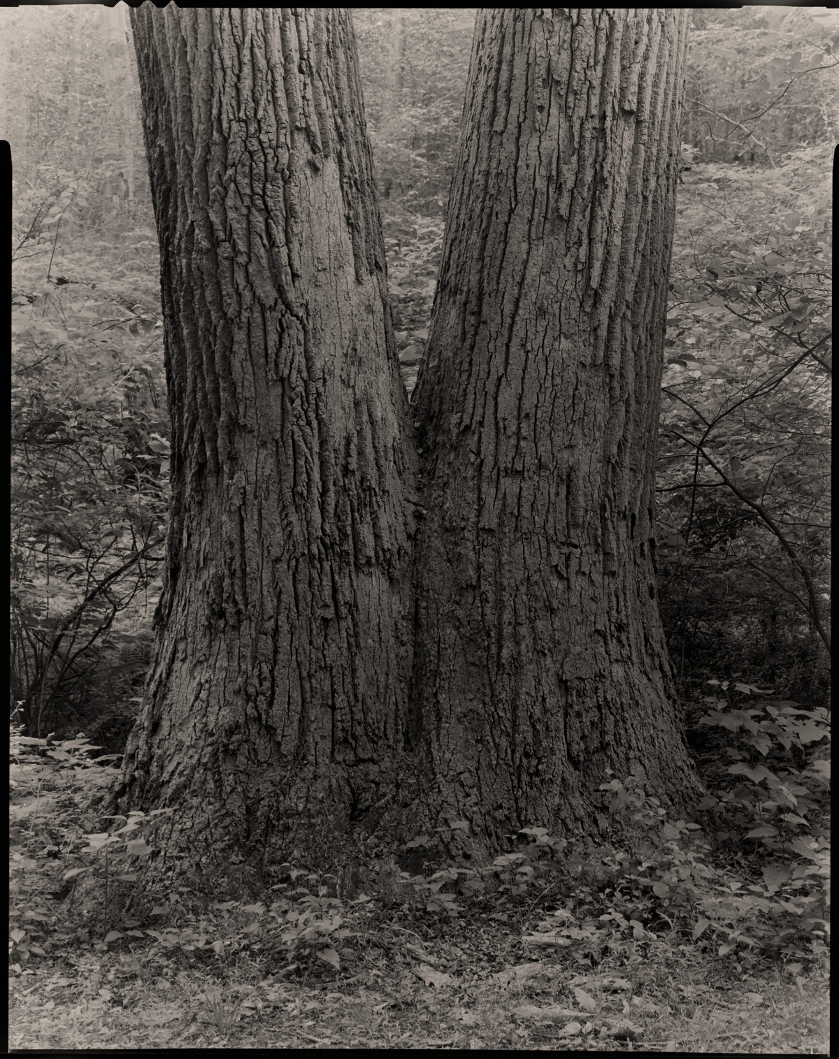

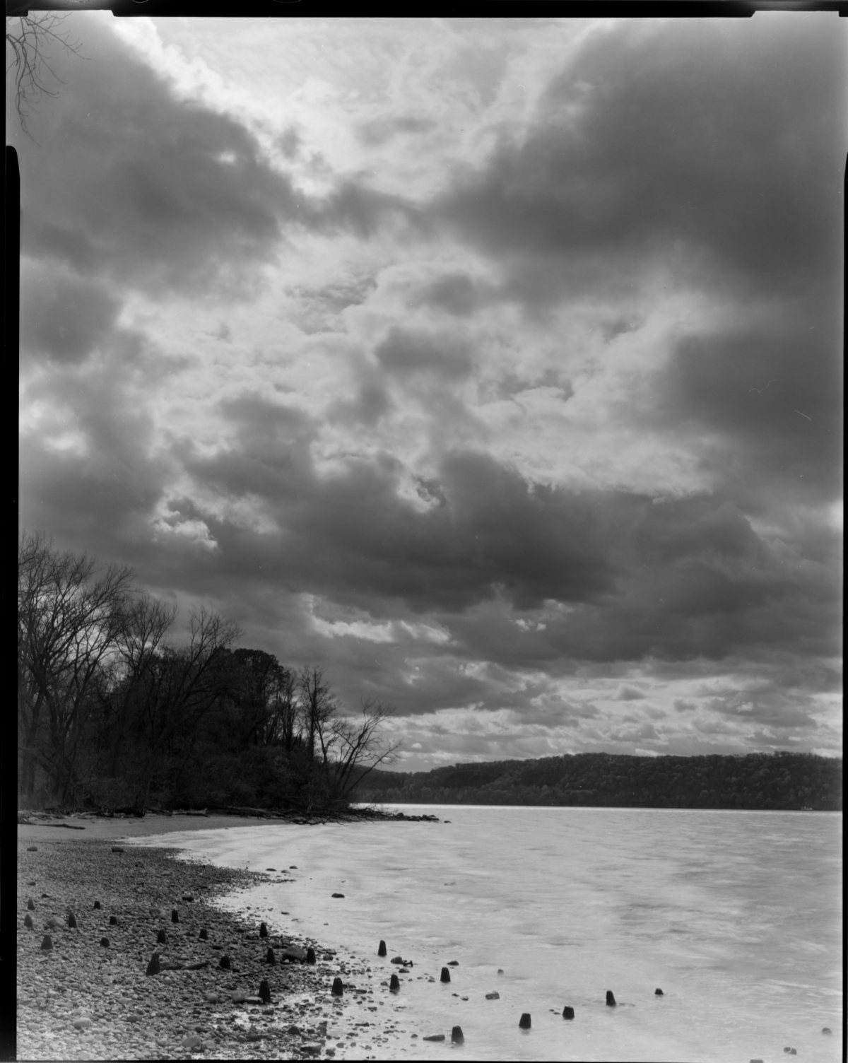

Thanks Paul, I'm finding that cloud detail, backlight trees with lighter leaves in the background and interiors with outdoor window detail a challenge with N-1 or N-2 and overexpose because of the shortened development time.
My primary developers are Adox FX39II and HC 110. I'll be starting with normal strength for the first bath and 50% strength for the second. For me, I have found the FX39II better for shadow detail and slightly sharper.
Have attached 2 images showing the issues
