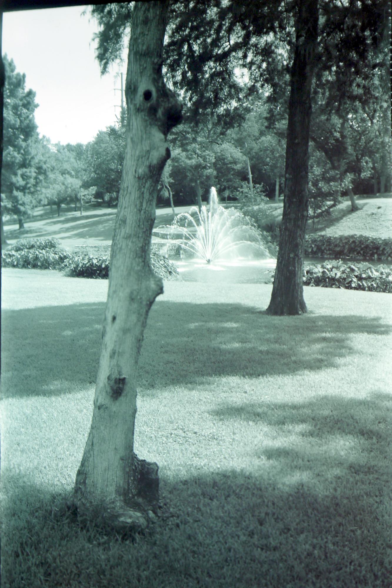

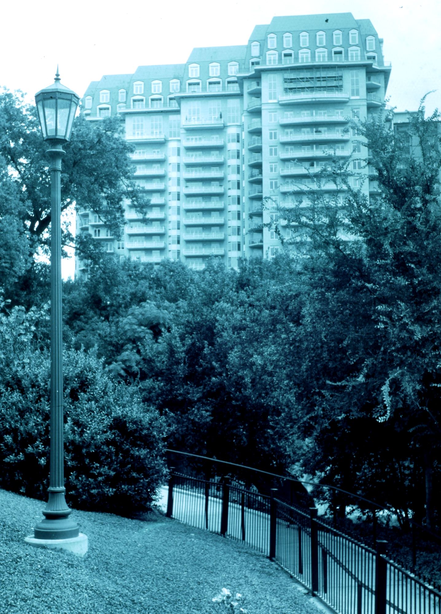

A while back I decided to shoot at least one roll of film thru every working camera. The main question was how to do it at a reasonable cost and how to archive dozens (and dozens) of rolls of test shots.
My first thought was a cheap C-41 print film with the images scanned. While doable, my affair with C-41 ended two decades ago and I have no interest in restarting it. Also, the time required for the scan (or the cost to have it scanned) made it a no starter.
Second thought was B&W with contact prints. I think the contact printing would be fairly easy, but it still makes the whole process unduly complicated and costly.
The easiest solution and the best results would be to just shoot slides. At less than $2/roll for development with the Tetenal kit, the only hurdle was the film cost. This could be ameliorated by by shooting half a roll per camera. Doable but a bit cumbersome.
Then I discovered the folks at Photo Warehouse sell 24 exposure XP2 for $4.29/roll. Since this cross processes to very nice B&W trannies, the whole cost is about $6/roll. Best of all, there is no secondary activities and 24 exposures fit in a single 35mm archive sheet.
I've been at it for about nine months now and am about half way thru the cameras.
View attachment 200292 View attachment 200293
