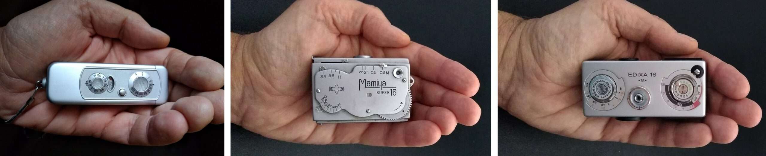

Minox may be legendary, but it's not the be-all and end-all when it comes to subminiature cameras. I took a closer look at two alternatives that are certainly not to be outdone:
What happens when three of the 20th century’s most brilliant engineering minds tackle the same challenge? I have immersed myself deeply in a direct comparison, examining not only their legendary history but also assessing their practical applicability in today's context.
What do you think of these cameras? Has anyone had experience with these 16mm cameras? I haven't finished testing them yet and would love to hear your opinions. Read on here:
Very interesting. I was largely unaware of the Edixa 16 camera.
Looking forward to the next installment!
Me too. The Edixa 16 is half of half-frame, it could be called quarter-frame.
The image quality is surprisingly charming:

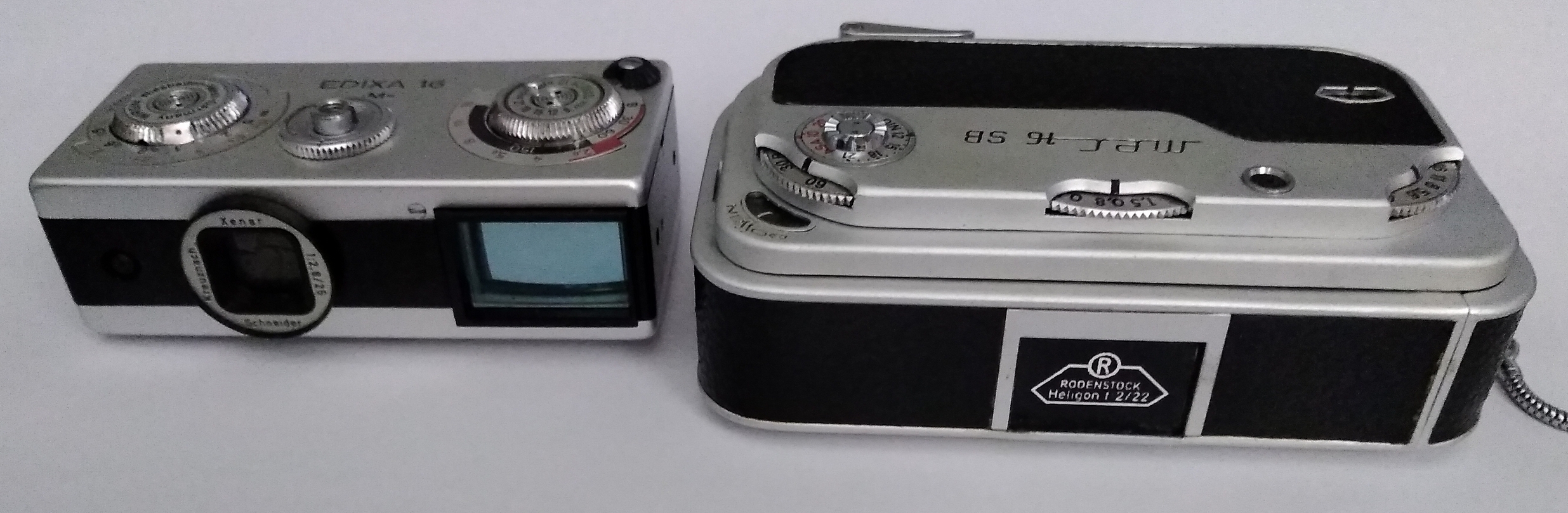

Yes, the mec 16 SB is something special. However, it's sitting in my drawer because I can't find any double-perforated film for it. And of course, it can't be included in this comparison because it's too big and too heavy. Here is a size comparison: on the right is the mec 16 SB, on the left is the Edixa 16 M (the largest camera in my comparison test):

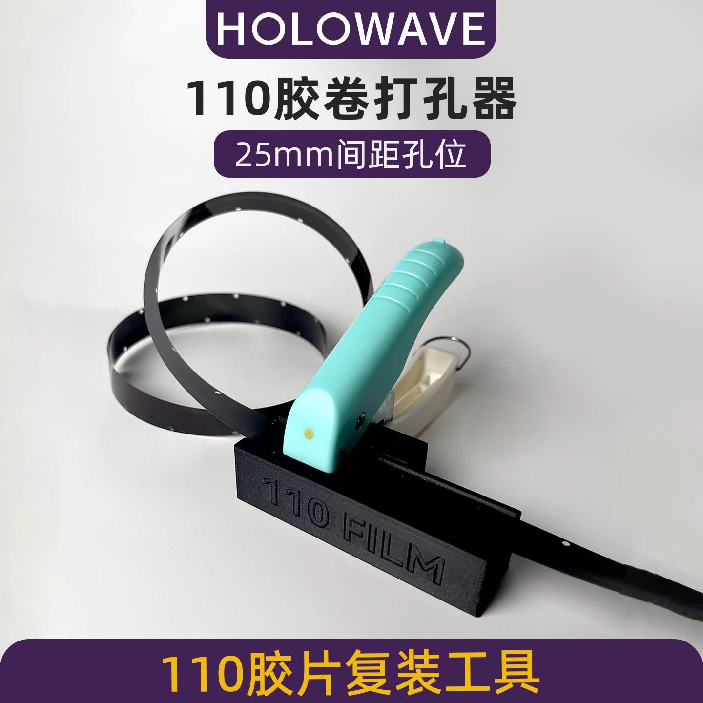

A film punching machine capable of drilling 2mm round holes, plus a 3D-printed auxiliary guide rail with fixed-spaced protrusions to assist in drilling. By changing the guide rail, it can drill single-sided or double-sided holes.
And presumably different spacing -- 16 mm cine film vs. 110 perfs.
Are these available to US buyers? I've got a pretty good 110 camera that I'd like to be able to reload for...
Actually, all you need is a hole punch; you can 3D print the guide rail yourself.
