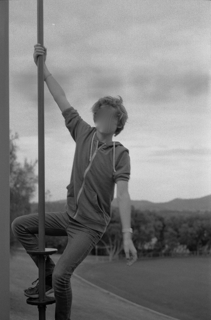

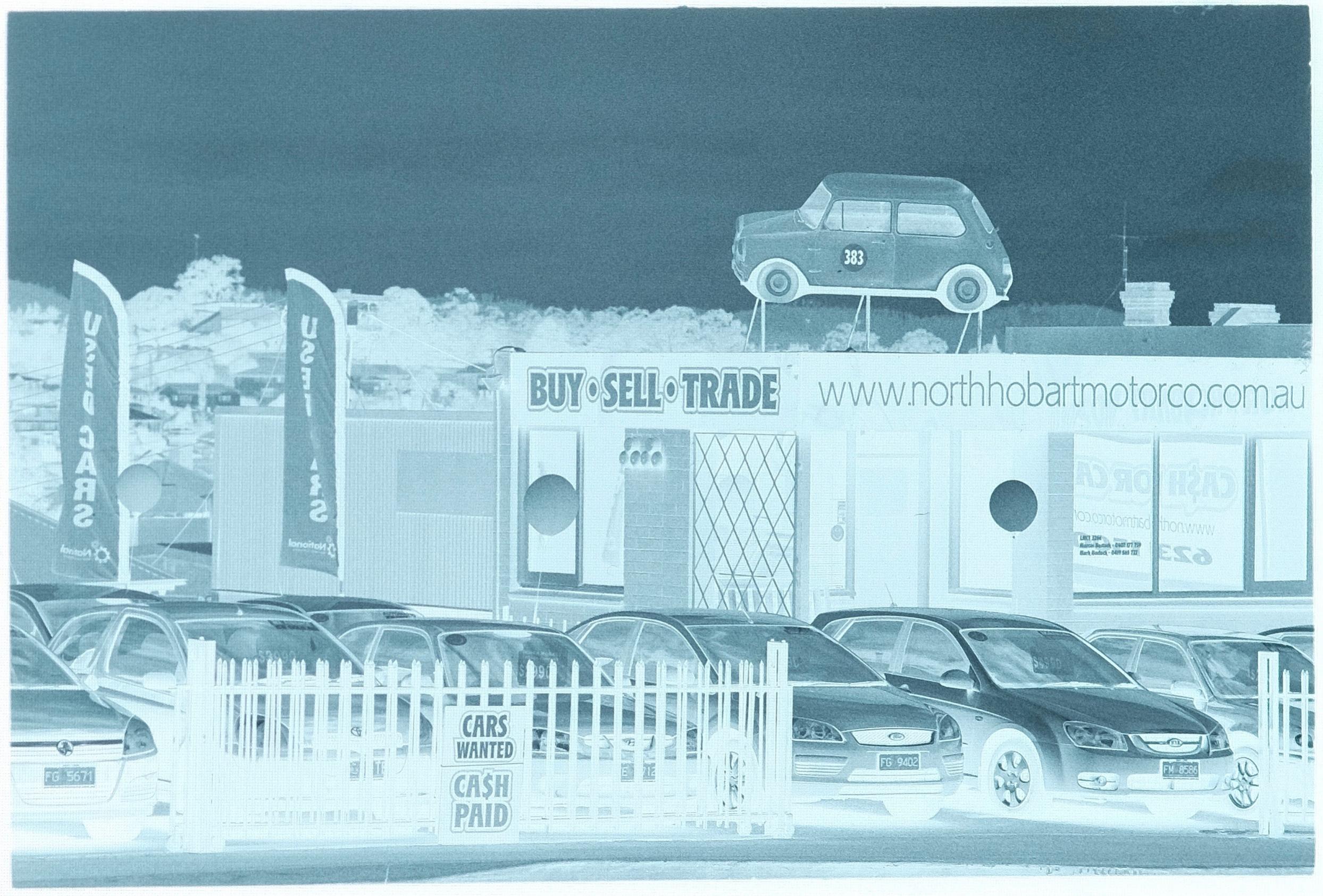

I have been struggling with two issues with my B&W negatives and after trying a number of things I am hoping that you can help me.
These are HP5+, Ilford HC, 18 degrees for 7:38, water stop bath at 18 degrees, HYPAM fixer 5 minutes at 18 degrees, Ilford 'archival' wash technique (5,10,20) plus another 10 minutes slow circulating water bath also at 18 degrees, plus final Photo-Flo at 1:600. Camera is an M3 with 50mm lens.
Here are two photos from the same roll which illustrate the problems:
attachment.php
(please ignore blurred face!)
and
attachment.php
The first picture has a dark band of what look like clouds, but were not present (to the eye).
The second picture has a pair of dark bands at the top of the frame.
Any ideas for what might be causing these problems? Thanks for any help!

You show inverted scans.
What do you see on the negatives themselves?

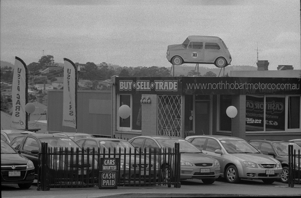

This is a cropped image using my iPhone as backlight of the second image (digital camera on tripod with overexposure of 3 stops from the metered reading).

BAC1967
Oct 30, 2014
1,456
Bothell, WA
I had the same problem scanning with a camera using my iPad as a backlight. Light would reflect off the metallic surfaces on the camera causing the same thing. The way I figured it out was the dark patches resembled the top of my digital camera. The solution was the mask off the area around the negative so that extra light didn't get to the camera. I also scan in a very dark room.

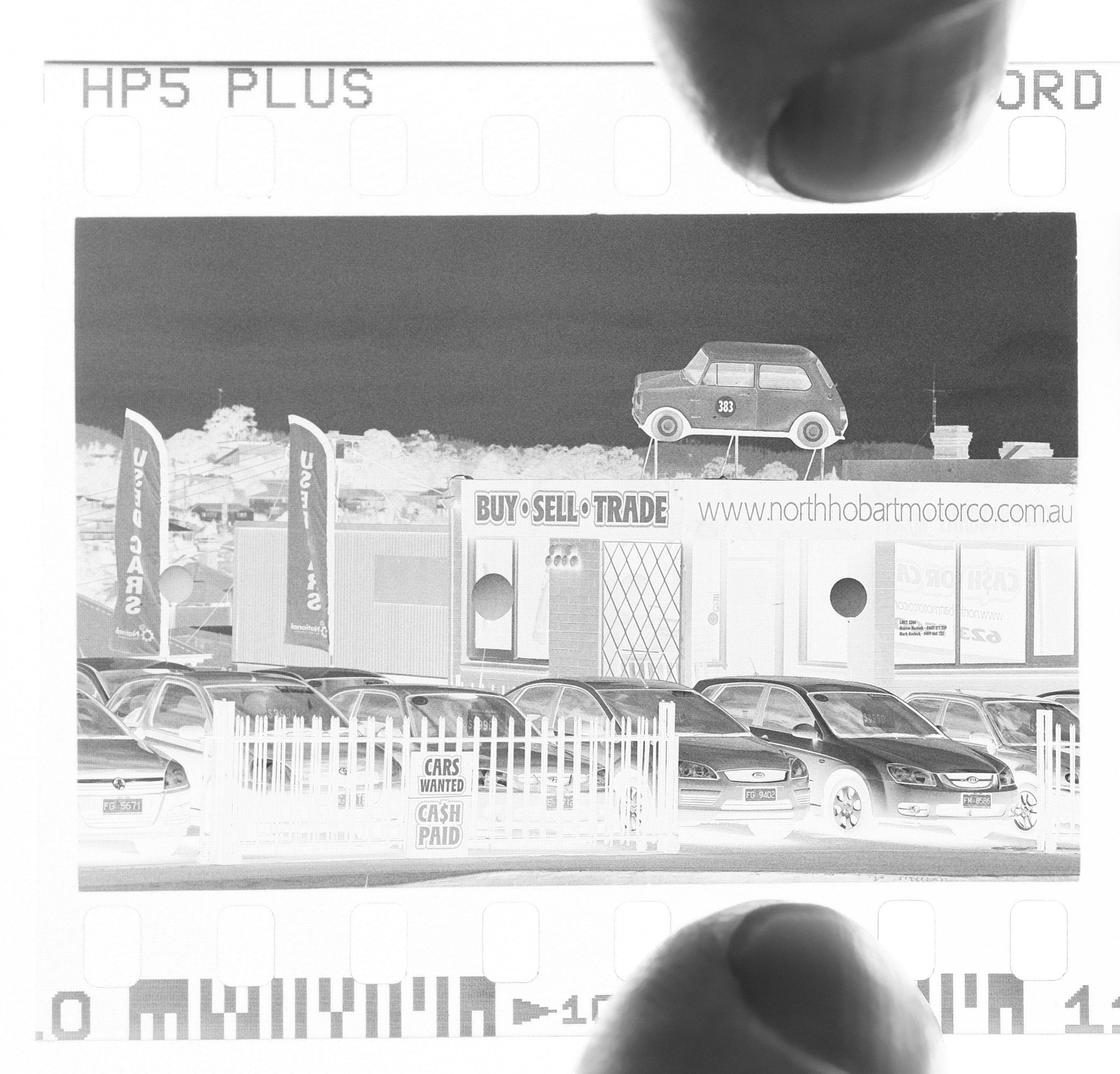

I don't have a flatbed, but this photo does show me holding the negative down on the screen of my phone:

MattKing
Apr 24, 2005
55,191
Delta, BC Canada
Can you do the same with the other negative?
I don't see any problem with the negative you have shown us. Which makes me think your problem originates at the scanning stage.
Try scanning the negative after you have turned it around 180 degrees. If the problem areas move with the negative it will tell you one thing, but if they disappear or appear at a different location on the negative, it will tell you another thing.

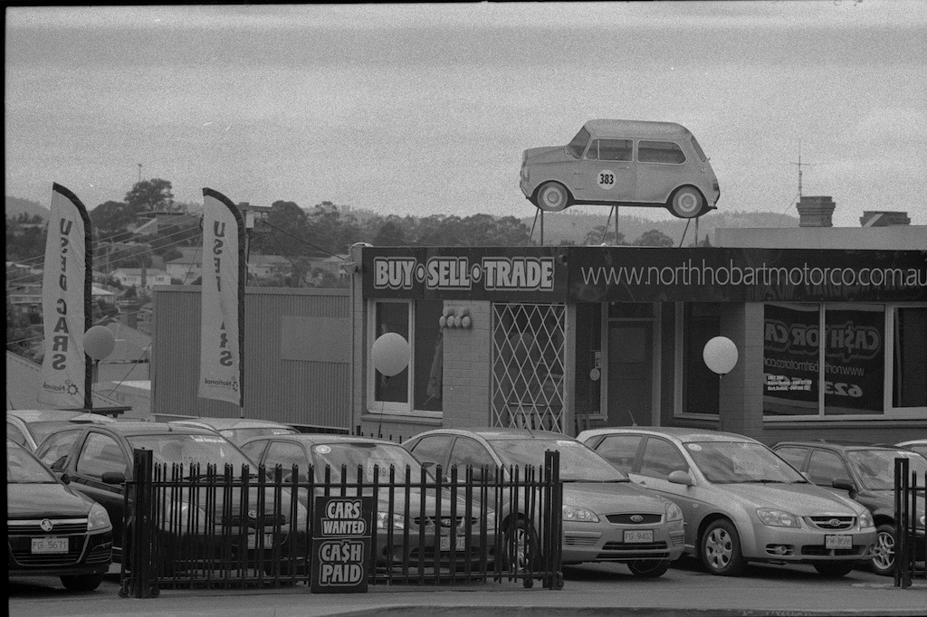

Hello Matt, Ian and everyone
Thank you so so much for all your help!
Here is the 180 degree scan of the second image:
attachment.php
It certainly is different! I can still two areas at the top (but less prominent?) and there is an extra band. So the scanner is definitely a possible a suspect! What to do?
On the first image, Ian suggested in a wonderfully detailed PM (thank you kind sir) that it may be because of a lack of flow of developer to a part of the negative due to the negatives being too close together during development. I see the effect of image number 1 on frames 8,9,10,11,12,13 of the roll.
All have different 'false cloud' shapes, some across the negative, some more in one spot and one actually with a curved shape.
So I am thinking the second suspect is my loading technique on the development rolls? I am using a new Patterson System 4 tank for 2 rolls. This has the plastic ratcheting kind of reel. I develop 2 together, I use 580ml of developer, approx 18.5ml of Ilford HC, the rest water that has gone through a Paterson water filter.
I load the reels in a darkroom by feel. What should I look for that might be causing the negatives to get in close proximity? Since the effected frames are sequential, I assume I may have somehow flexed several of the frames on to the back side of the earlier frames?
Thanks once again for your help. I had begun to have 'thoughts from the dark side' (picking up the digital camera) so you are really helping me back to the light side :smile:
