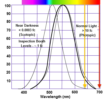

And how does this relate to the Becquerel method of developing latent images (on Daquerreotypes) with prolonged (roughly a week) exposure to red light? This was known since the 1840s, and is sometimes suggested as a safer, more environmentally friendly alternative to mercury fuming for those using halide fumed silver over copper to record their images.
Amber appears brighter than red to the human eye. Especially so for dark-adapted eyes.
Yep. Human eyesight maximum sensitivity is close to the yellow sodium line at 555 nm, so starting from red, every little step toward green lets you make the actual light dimmer and still see as well or better. And amber light at around 640-650 is excellent for nearly all multigrade, materials, though true ortho may be better with red around 700.
