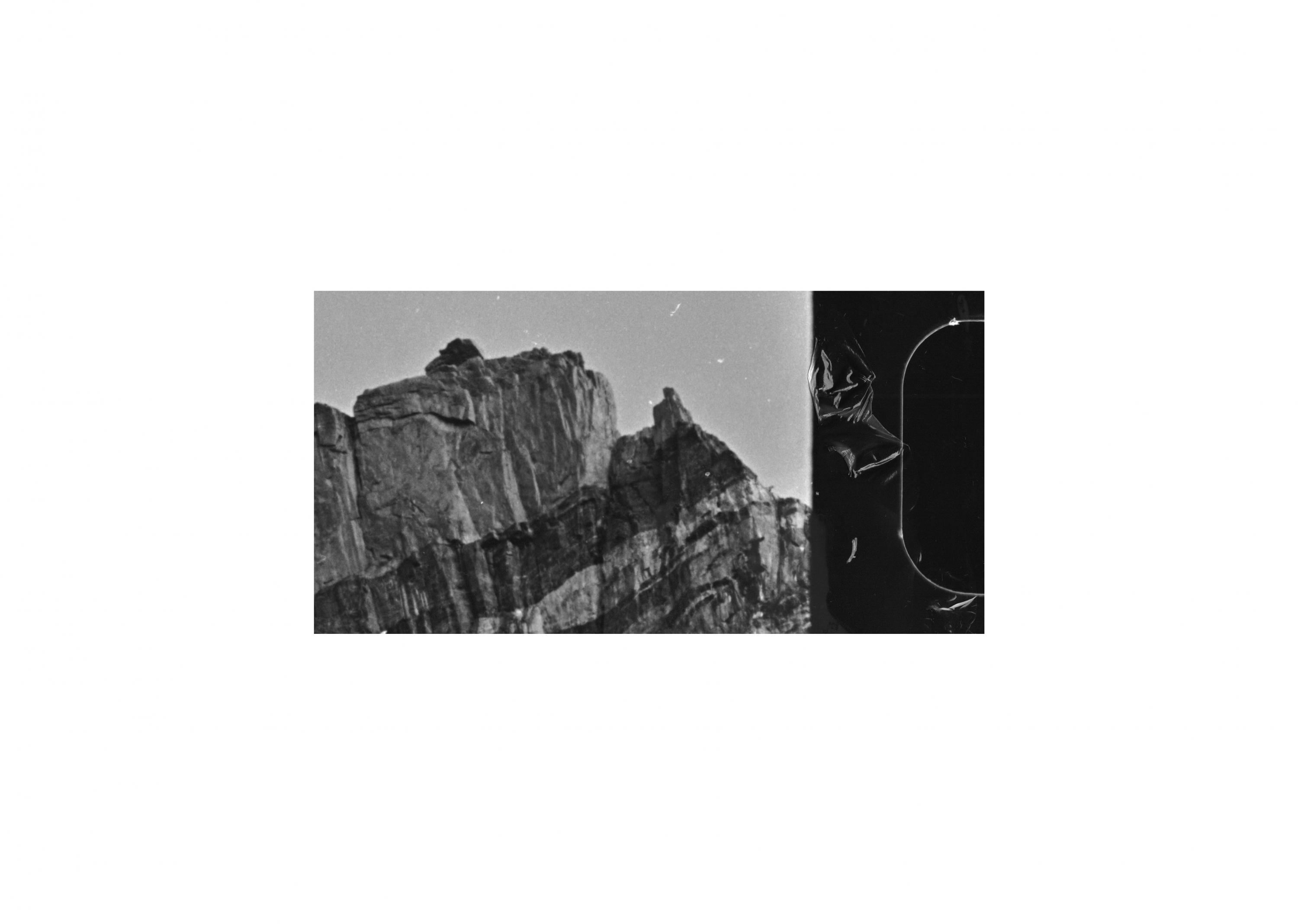

I found those negatives, the 36th roll I shot in 1991, but they're not holding up very well; lots of scratches and dark specks, maybe mold or silver from unflushed silver halides. Alas. I'd never find that hawk in this so I just printed a 5x7 at around 32x and scanned it. It's de-lammed in places from the microwave quick-dry. :smile:
At 1.4MB I think it will download quick enough. Specs, as I recall:
Location: Chasm Lake at the foot of Longs Peak's east face. Maybe 10,000 feet. Longs is 14k, the ridge is maybe 13+. 6 AM
Nikon F, mirror locked up, tripod weighted.
105mm f/2.5 silver-nose Sonnar, f/8.
Red 25 filter.
Kodak Tech Pan developed in something. I think it's by the guy who made "Perfection", some kind of POTA or Windisch-based formula.
Sprocket hole included for scale.

So 32x is about 32" x 48". And that size print would properly be viewed at say 6 to 10 feet, at which distance it would look fabulous. God I miss TechPan.
I took a slide in 1998, on the Rhine river of the Marksburg castle at a distance of a bit more than a mile. Handheld at 1/500 and whatever f stop worked that day - say f:5.6 to f:8 - with 100 speed Agfachrome, the weathervane atop one of the towers is clearly reproduced (although the film is losing it) and you can read the wind's direction. This with a silver-nose Sonnar 105 made about 1968, with some light coating marks on the front. I miss Agfachrome too.

You're quite welcome. The print focus might still be a bit off; I can't use a grain magnifier on the floor and turn the focusing knob on a 23CII at full extension at the same time.:blink: Plus, I think 32x is outside of an EL-Nikkor's range of best performance. It is also interesting to see how the print looks so much better than the digital scan. Film is truly a remarkable invention; I'm grateful to have picked it up at its zenith, hoping for a very long autumn. No telling how good digital will be when it's 130 years old!

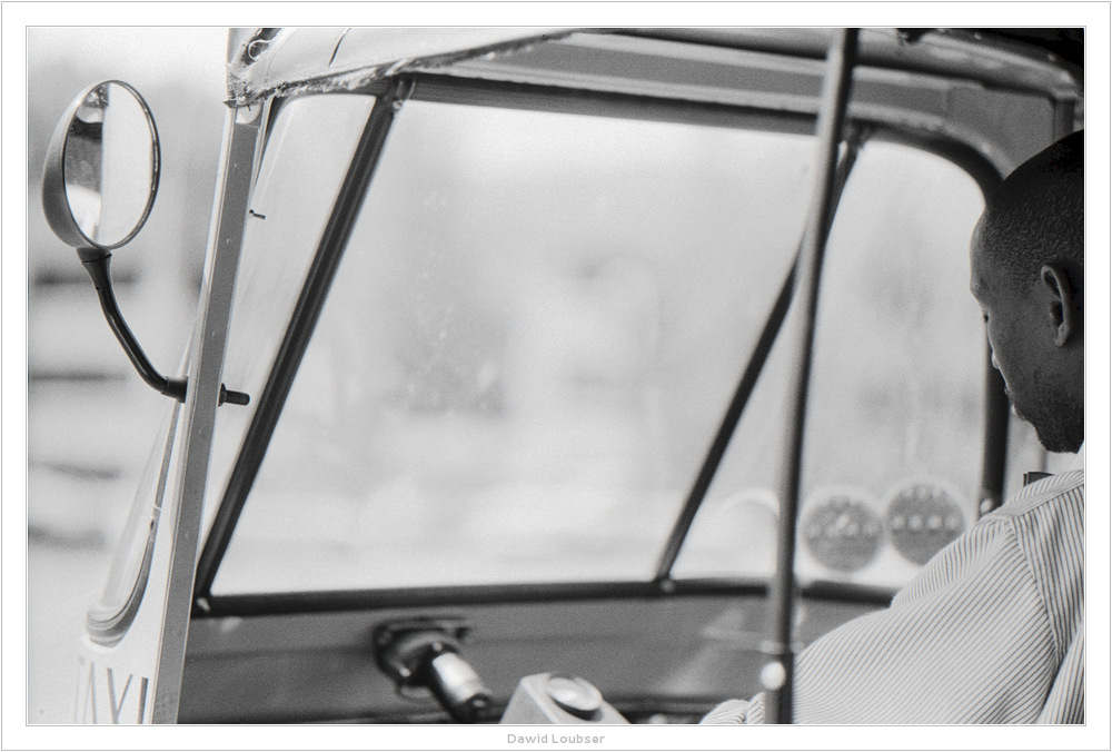

So long after starting this thread, the Nikon F was not a gear-acquisition fad. This camera is an eternal masterpiece, and the first-generation optics are a joy to work with. I just developed these:
Pondering the light
(Nikkor-H.C 50mm at f/2.0)
Tuk-tuk driver
(Sonnar-type Nikkor-P 105mm at f/2.5)
