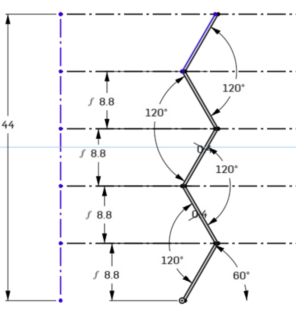

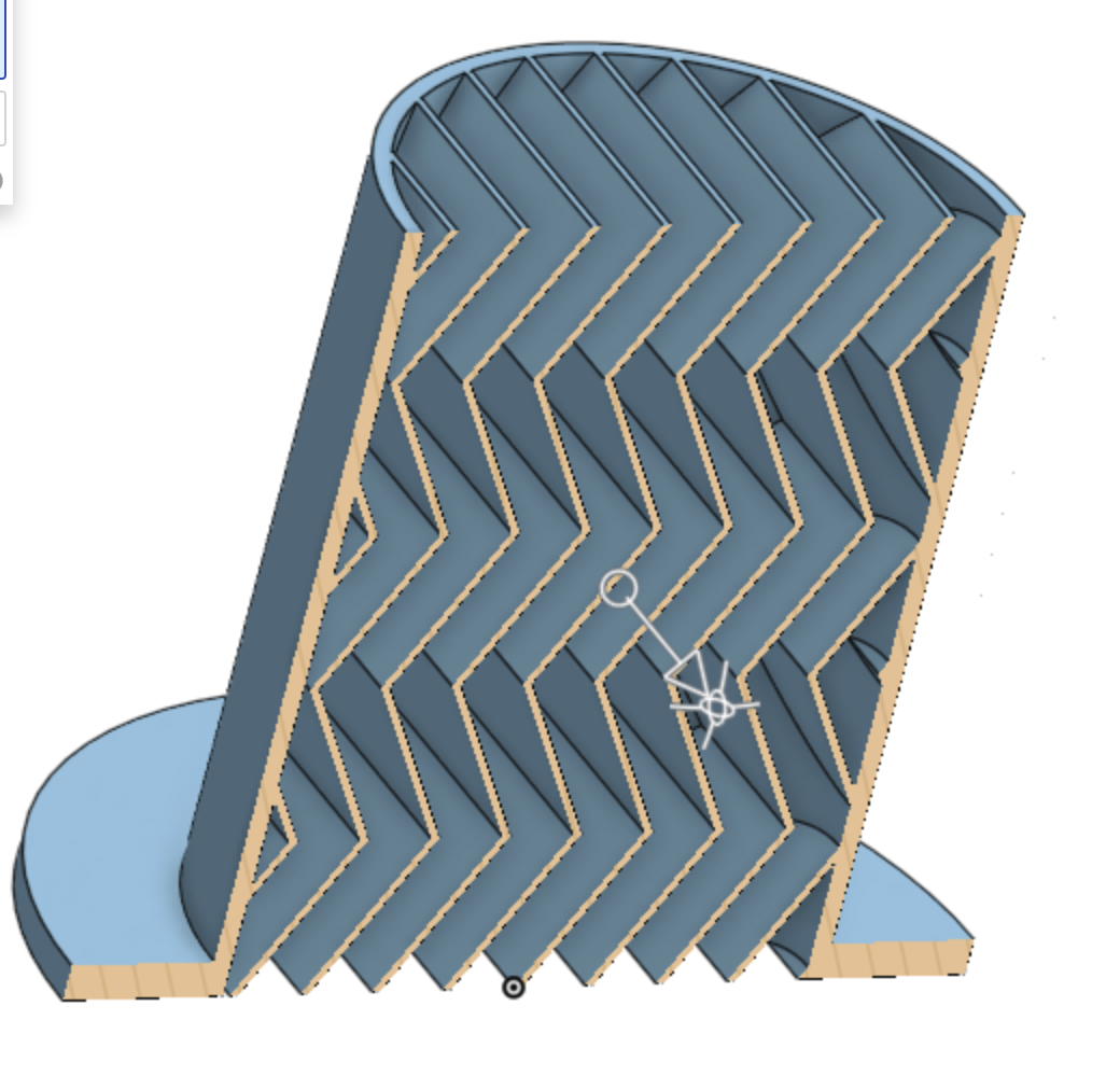

Just a few days ago I drew this and printed it a couple of times.
My darkroom uses a cloth on one side, and the ventilation creates negative pressure that pulls it inward. I wanted to prevent that with the vents.
You have to find out how many bendings (5) and the distance (4mm) between them works for you.
My vent is realy small, just 35mm in diameter.
