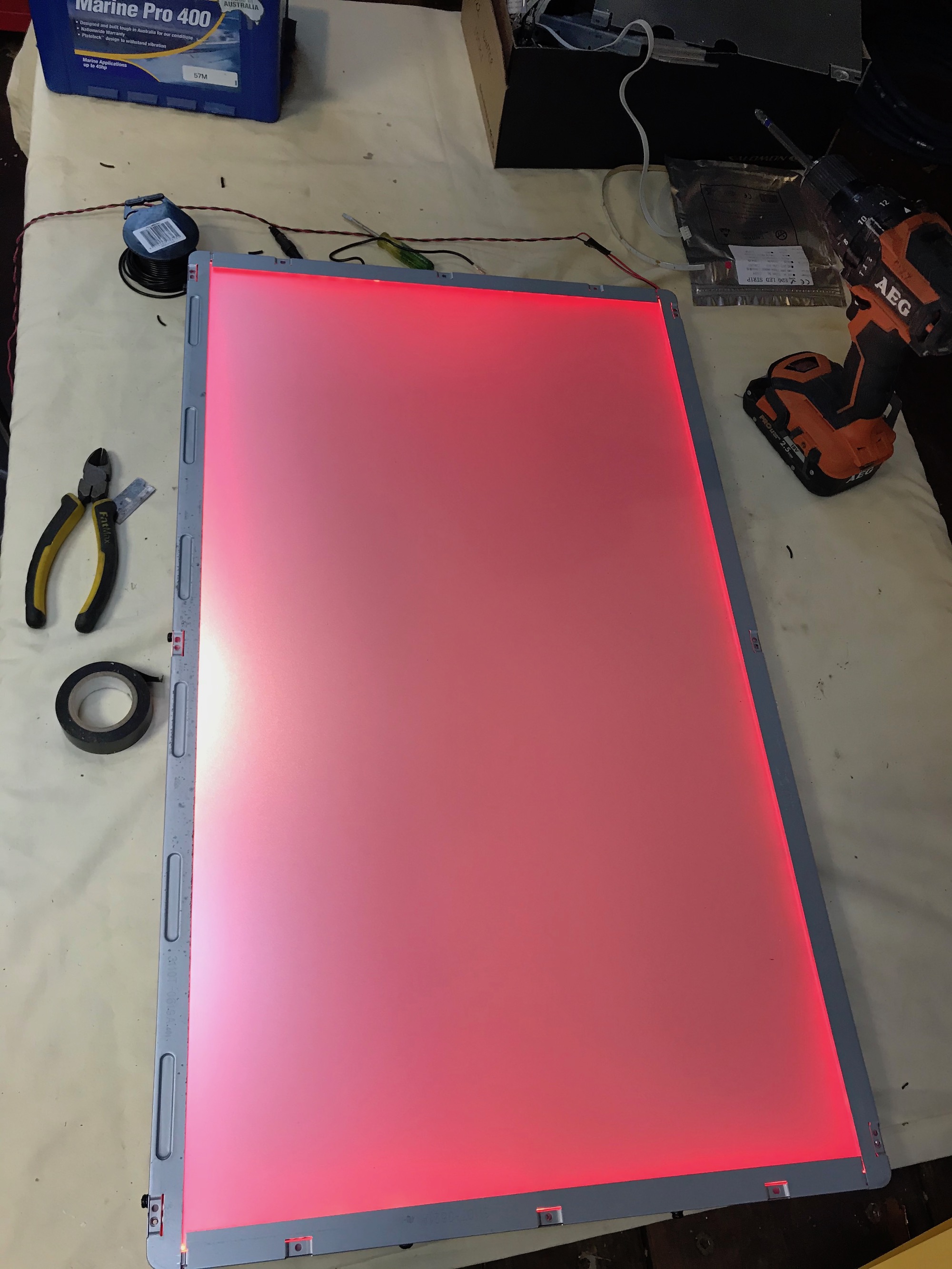

Saw this on YouTube.
Reckon it would make great lighting for a photo studio. So I am wondering if one were to use the LED strip lights that can be dialled to red as well as white that these could make good darkroom lighting. I've got an old broken TV so looks like a good challenge. Your thoughts?

Finally got around to the convert the TV challenge. Very easy project which only took a couple of hours. Now to see just how safe the supposed safe light really is. So in a few days when I am next printing I will do some safe light testing and post the results. I used all the circumference of the TV inners so if it is too bright I can reduce the LED strips to just two sides.
The converted television has made a great safe light which is now mounted on my darkroom ceiling. I did the coin on paper test directly under the light just 1500mm away and after 6 minutes there was no discernible fogging of the paper. It has made my darkroom a lot easier to work in so I am pleased with the result and with a total outlay of $15 for the LED strip and 240 to 12v transformer plug.

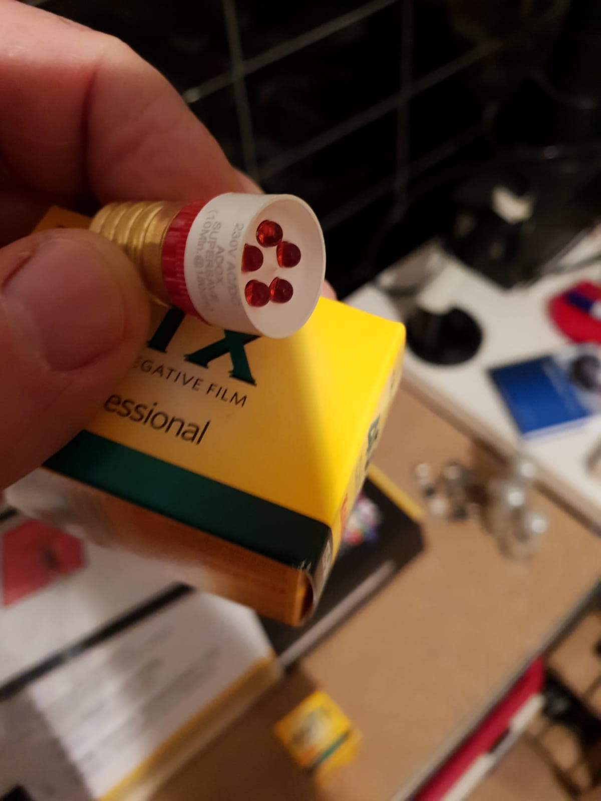

That is nice solution, but you need to have big darkroom, for those who have small spaces I would recommend this:
I've seen this listed on the Fotoimpex website... the geek in me wants to replace my darkroom light by this :D
Is it good? How's the brightness compared to other darkroom lights?
It is good, and bright :smile:. I got it in the case that my normal bulb in Paterson setup dies.

Thanks for this tip kevs. I tried the spectrum test with a CD and the converted TV safe light only gives out a pure red band with no other colours. I also have a very old Kodak safe light filter glass with a globe behind it and the spectrum on the CD is the same as the TV. I've done some printing under the TV safe light and am okay with the results. Some time I'll try the Kodak safe light tests of pre and pro exposure but I'm fairly confident it will be okay. Next project is to convert an old computer monitor to white light LED as this would be great for negative viewing. And yes kevs I am having great fun in my darkroom. Cheers.
