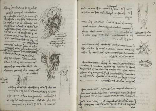

I admire very much Leonardo Da Vinci's turbulent flow drawings at Leicester Codex.
Leonardo invested too much time to investigate fluid flow and tried to understand , catalog the shapes in turbulence. And carried this knowledge to other subjects for example foliage or hair drawings. I read that he never copied what he sees but collect all knowledge to create attractive drawings.
I am thinking to replay his experiments as seen and understood from his drawings at the codexes and hologram them.

an example
from paris manuscript
