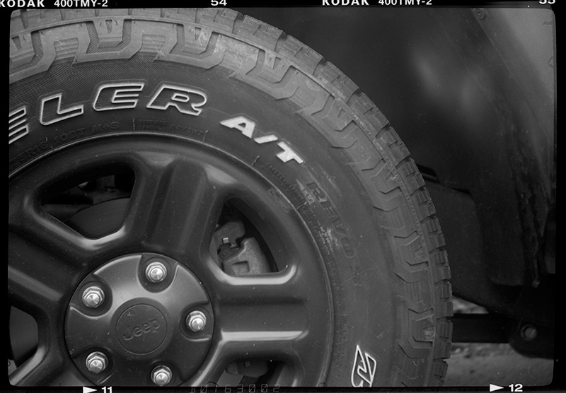

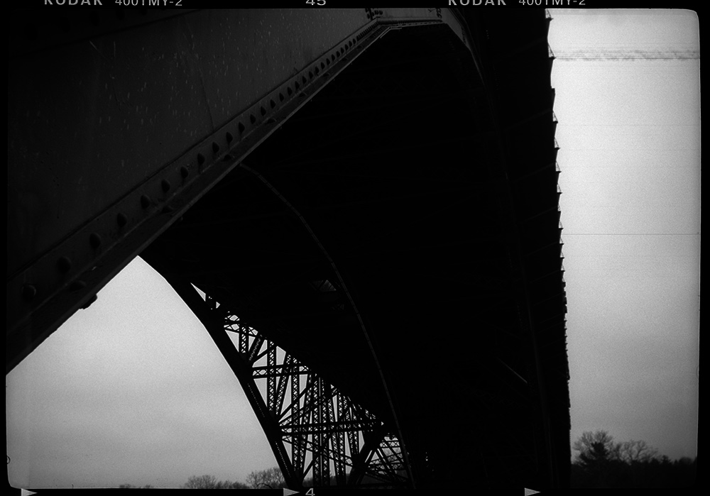

I'm trying to get an old family camera into fighting shape. It has two pretty obvious issues so far. First, the autographic window leaks light like crazy (although not seen on these images). I think I've solved that but will know more tomorrow with the next test roll.
On today's images you can see horizontal lines that are present on all of the images, getting worse toward the end of the roll. I have ideas about what to do next but I'm wondering if you have worked with cameras like this and have suggestions.
Thanks!

Looks like film might be scratching on something as film is advanced. Are the film touch points smooth to the touch?
I think that's what is happening. There are two rollers holding the film taught and I lubricated the shafts very lightly, thinking the film might be sliding rather than rolling properly. They roll easily now and seem smooth enough. We'll see tomorrow. The deeper scratches at the top are puzzling though and I''m wondering if the film is hitting something other than just the rollers.

Is the scratch even along entire length? Does it become fainter as you move towards the end of the roll? There's a lot of tension at first, but as more film is taken up on the take up spool, there's less. Does your Brownie take 120 without any modifications? I have to respool mine onto a 620 spool. My Hawkeye takes 120, but I still have to trim down the spool ends with nail clippers.

It was designed for 120 film so no problem there. The scratches are very light at the beginning of the roll and gradually get worse toward the end of the roll.

Lay the processed negative back into the camera with the emulsion in and the image upside down and backwards.
Look along the line the scratch proscribes and you'll find your problem (maybe; if it was a chunk of crud lodged against a roller, it might have fallen out when you unloaded the camera).
You didn't mention if it is an emulsion or base scratch, so check the appropriate side...

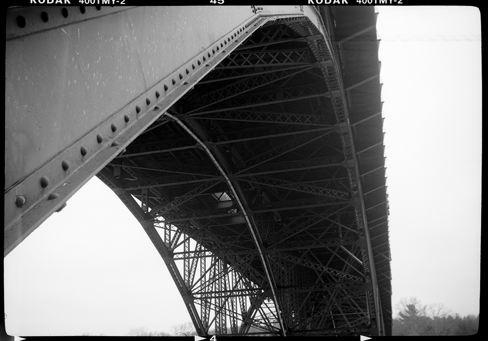

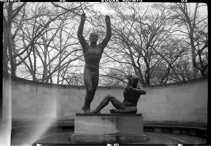

Thanks for the advice guys. I'm pretty sure the rollers just weren't rolling, and that was causing the scratches. Also there were bad light leaks from the autograph door and possibly the red window frame counter. I sealed those openings and lubricated the rollers and the results are so much better. Here's one image from yesterday, looking not so good.

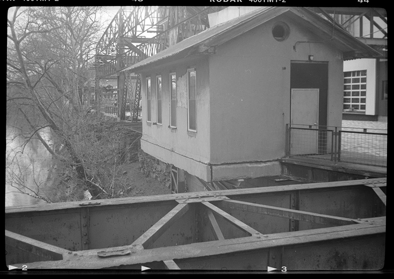

And then images from today, with no scratches whatsoever and no leaks that I would complain about:
So. I want to use this camera this year. The images are surprisingly good for a hundred year old camera with a filthy lens in my opinion. But the lack of contrast reminds me of my YachicaMat LM before I flocked the interior and got a lens hood. I know there is only so much I can expect from this heirloom but I do want to improve the performance just a bit. I'm thinking about making a lens hood but first has anyone here seen a lens hood on a Brownie folder before? A quick Google search didn't reveal any.
Also I don't think there is anything inside this camera to be flocked unlike that old Yashica, but if you've ever seen improvements made to old Brownie folders specific to light scattering inside the camera I'd be grateful for a link.
