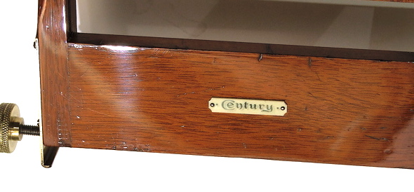

Have an older wood view camera with a finish on the wood that is pretty worn. Looking at pulling it apart and re-doing it.
I don't want a high gloss finish so was thinking Tung Oil finish when I get it cleaned and ready.
Anyone doing restoration know if this will give me any problems in the field later?

I used lacquer on my Century over ten years ago, and it is holding up well.

Clarifying this for some. Am not doing a "restoration" to factory finish. Doing a re-finish so it looks nice, will wear well, easy to touch up after field scrapes and such.
Have reclaimed old furniture of various types and have familiarity with various stains and finishes. So this camera will be a user, not a display piece.
