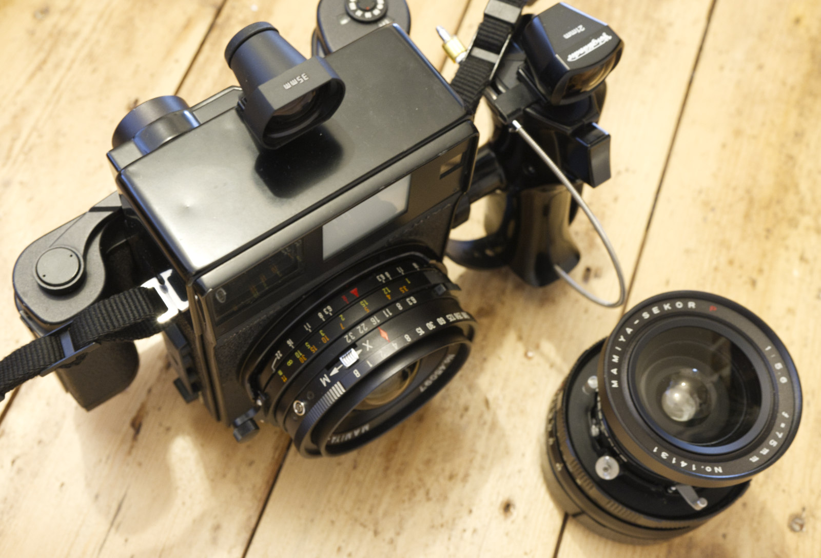

…I find the OEM bright line viewfinder rather poor with indistinct frames. Do you think I could use a TT art. vf designed for 35mm lens instead? I looks nice and is inexpensive. I’m really asking is the viewfinder for full-frame or apsc? I have a Voigtlander 21mm for the Press 50mm lens and it works well but this brand is too expensive in 35mm or 40mm field-of-view. Thanks if you can help.
I use a TTArtisan 28mm viewfinder for the 65mm lens on my Fuji GL690. The "28mm" on the TTArtisan indicates the focal length for 35mm/FullFrame. I assume one marked for "35mm" focal length to also be FF. Note--the 28mm doesn't have frame lines at all, I assume the one you're looking at to be the same?
..thanks. The TT art 35mm viewfinder is a bright-line type. So, different from your 28mm. Hopefully it‘s marked out for full-frame.
OK, I have the TTA 35mm viewfinder now and it seems to indicate framing for full-frame. So that's fine. The bright lines are not as clear as the Voigtlander but it's more useable than Mamiya's dedicated v/f and less distorted too. Thanks for the advice.

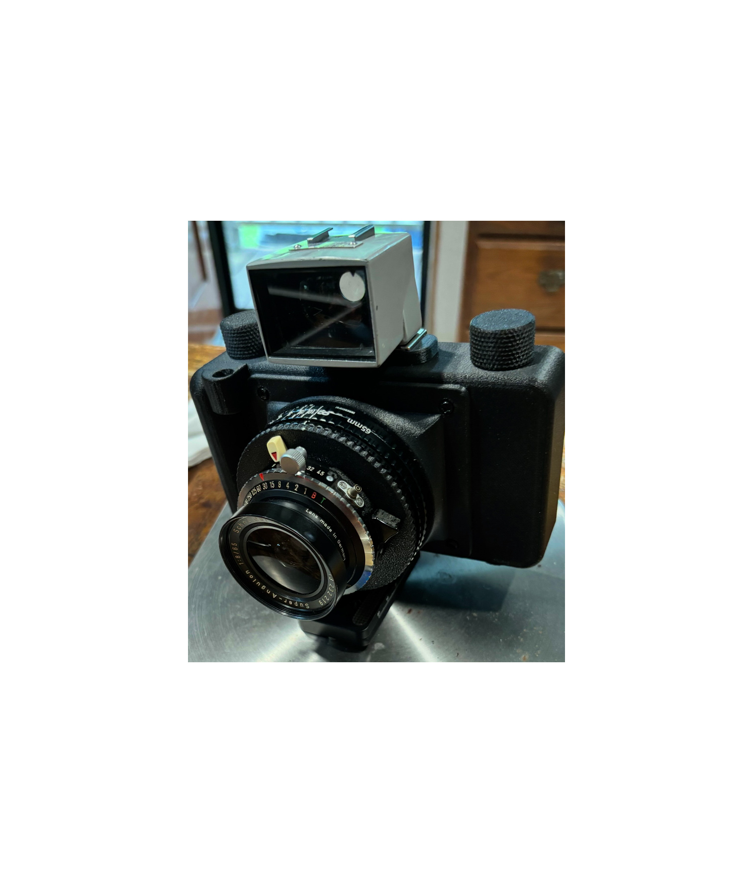

I’m using a Mamiya Press 23 65mm viewfinder on my 6x9 camera with a 65mm Super Angulon f/8 lens. I tried small viewfinders made for 35mm cMeras with 28mm lens but the cheap ones were no good and the better ones( Voightlander, Leica) too expensive.
