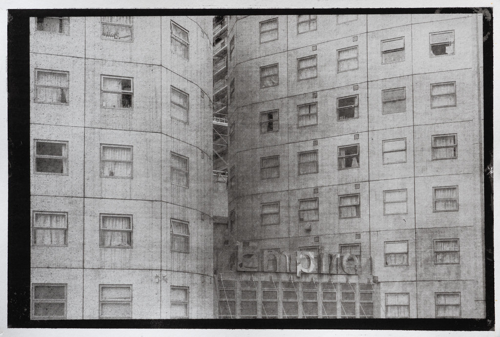

Here's my second attempt at making an actual photo print with PVA-SbQ, first was a dud because I tried to add a clear layer and didn't compensate for it in exposure times or something. It's a 4-layer print, all sequentially coated and exposed with a single development at the end.

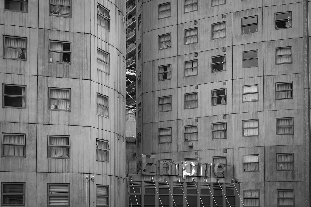

And for reference here's the original photo:
During development the unexposed dark layers flaked off in big clumps which subsequently stuck back onto both sides of the paper causing some of the final speckling/staining. In the future I need to develop some kind of angled waterfall development bath so that unexposed PVA flakes have less chance to re-attach to the paper where I don't want them.
Eh I mean it's obviously not perfect but I feel that the gritty nature of the original photo suits all of the speckling and brush strokes. What I do need to fix however is the print coming out too light vs. the original. The adjustment curve I generated had the midtones and shadows getting significantly lighter but looking at this print I wonder if it went too far, I might even just make another one with a straight linear curve and see how it goes.

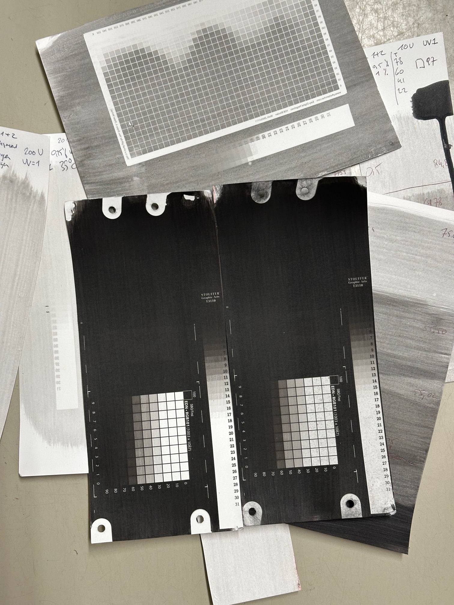

I spent the last 3 days of the Christmas break to do some test using SBQ.
  • I use a work solution of 1 SBQ with 2 H2O (SBQ for RSemulsion - Semi finished) and 6% Arrowroot
  • paper HPR, sized with hardened gelatine and an exposed clear coat.
  • Initially I diluted the SQQ with 2 parts of PVOH (glue) but it stick nicely to the paper after development so I continued just with work solution 1+2.
  • Using a stouffer wedge I determined the exposure time for a 4 layer print (density = 1.8). In my case 50 units (which is roughly 36 seconds). Subsequent layers have an exposure time that is roughly the half of the previous layer.
  • Pigment is Wet Print Black.
  • Determined the maximum blocking color using Peter Marhr’s tools.
  • Tried to find the correct pigment loading per layer. I noticed that it makes a difference what surface area you use, or better how you apply brush strokes. For now it is 0,42; 0.9; 2.2 and 4% (SBQ)
  • I did 2 test. One applying the 4 layers and exposing them. I development at 35°C at the end (same technique as for Print Makers Friend), and one test with a development after each layer.
  • The 1 development technique worked very well.
  • Updated the pigment loads to 0,38; 0,ç; 1,8; 4%SBQ respectively which gave me 5 stops.
  • Next I need to determine the correction curve and do my first print.
Some insights/toughts
  • Working with 1 development gives a much better result (less to no staining and not so grainy). The tonality range seems almost the same in both cases.
  • There is some banding on the Stouffer wedge print. I think this is due to the exposure time. Layer 2 and 3 will probably need an exposure time that is a bit longer.
  • consistency in brushing will make a difference on the end result. Making brush corrections once the paper is coated (even if still wet) is useless. The emulsion dry’s quickly and you can easily break the layer.
  • What I find strange (according to what I can read on various sources) is the relatively long exposure time (using an 800W halogen lamp). I think this is due to the wavelength needed to harden the SBQ, 325-365 nm and my lamp peeks at 395nm
  • I have no correct idea of what the concentration of SBQ is in the Semi Finished emulsion. No technical nor safety data-sheet can be found.
  • Before applying a layer the emulsion needs to be stirred. The arrowroot sinks down and emulsion with lots of pigment also have a tendency have pigment at the bottom.
  • Layer 3 and 4 will probably need some additional water because they are more viscous.
Very interesting and good results.
You're using a much thicker emulsion than me (1+2 dilution, while I use 1+8) and also slightly higher pigment loading, which I would have thought would result in a much darker print, but maybe your brush technique is different?
You're getting good clear whites which I currently am not, which might be due to your use of an exposed clear coat in addition to gelatine sized paper (I currently use hardened gelatine sized HPR but no clear coat).
I have been thinking about moving to a heavier coating to see if it would make it harder to damage previous layers when brushing on later layers, could be worth a shot. As you've noticed brush technique seems to be critical for this process, you really only have a few seconds to brush a layer on and if you come back to 'tidy up' a layer you've let sit for even a few seconds you ruin the print. It's very unforgiving...
@AndrewBurns I tried to match my Pigmentloads to specific lightness (LAB) values. I used those from Calvin Gries's exposure calculator for a 4 layer (Density of 1.8). I come close to the target values.
In my experience the clear coat makes a difference.
And yes, the brushing is the tricky part. You need a good brush that can distribute the emulsion evenly. The brush hairs need to be soft but not to soft. You also need to do it correctly within 30 seconds. If a bruch stroke is OK, don't go over it again.
Now it seems doable because of the size of the paper. My intention is to go to ful A3+.

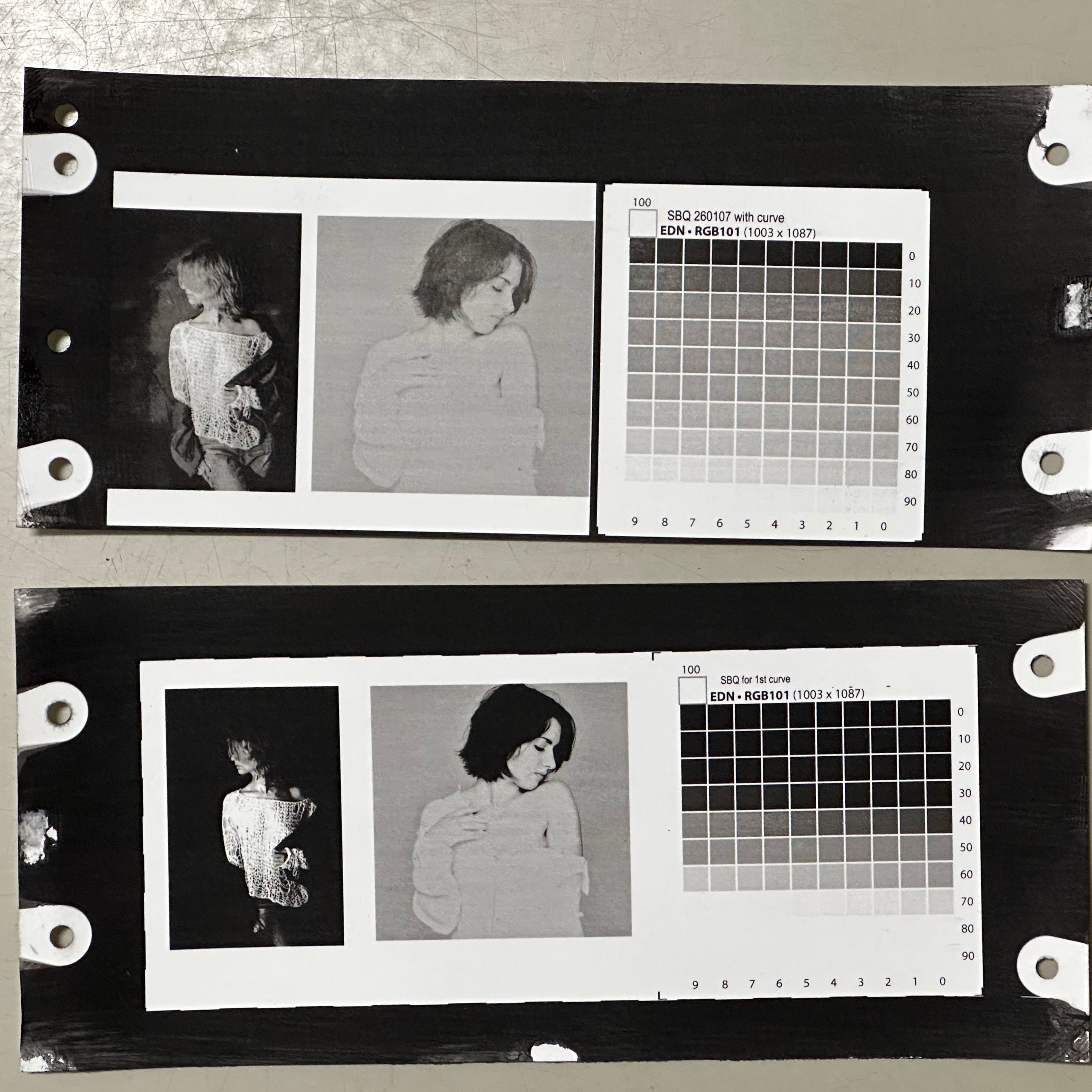

Getting close. Managed to get a curve (that needs some tweeking, the midtones are a bit flat) that workedout ok. (bottom without, top with curve)
