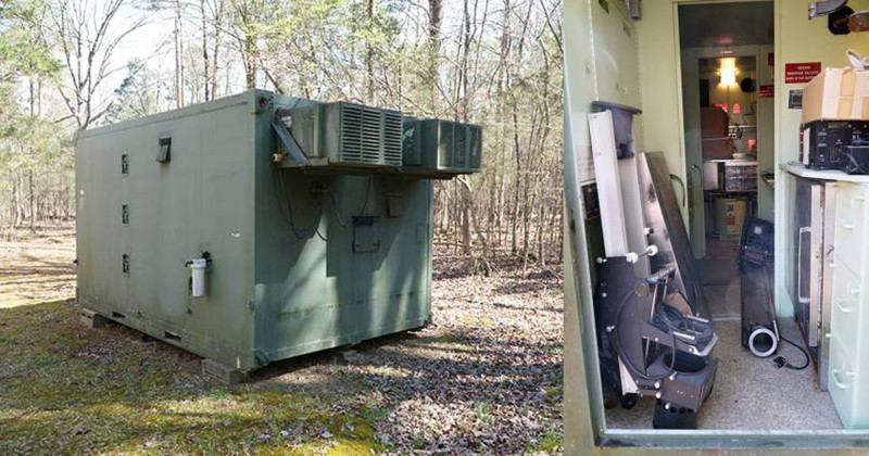

All American forces had access to well equipped darkrooms, the Air Force and Army had portable darkroom that could airlifted, all metal with AC and chilled water. Air Force version had color capability and were equipped with Omega D5s. A variety of developers on hand, D76 being the most common. The North Vietnamese and Viet Cong would develop their film at night in the open using a small dish to see saw their film using water from streams, let it hang and dry the best they could before sending it North.
Here is an image

Yes, I know about the portable darkrooms, but that does no mean that all the photojournalist in country had access to them or other controlled environments.
By-the-way, you can bid on portable military darkrooms on Government surplus sites,.
The one that I was looking at, many years ago, included a burn silver recovery system and if I could afford one, I'd rather use it than the small bedroom I have now, no meaning to spit on my current good luck on having my own now.
