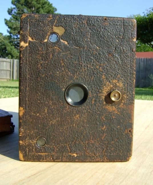

Just curious if anyone could positively ID this box camera. The camera uses plate holders that will accomodate 4x5 plates. The camera measures 5.5"W x 8"L x 7"H. The shutter is two speed, and the iris has three settings. The brass knob on the front primes the shutter, and the "I" and "T" push levers trip the shutter. "I" being instantaneous and "T" being timed. The camera makes excellent exposures on ISO 100 sheet film.
The plate holders are all labeled as Rochester Camera and Supply Co., Rochester NY; Pat May 10th 1898. But of course that doesn't mean the holders and the camera were purchased at the same time, or made by the same company.
Thanks yall!

Well if the holders are original, than the camera is a Poco and its from before 1899 when Rochester Camera and supply (Poco) was absorbed by Rochester Optical (Premo) and both were absorbed by Kodak in 1903. Camerapedia to the rescue!

I suppose it is possible, but I have never found this camera as part of any Rochester Camera advertisement or catalog entry. Can you could point me to any tib-bit of information that might confirm this information that would be great.
I tried Boxcameras.com to no avail.

Update: I found some info in the 1897 Sears Catalog for a camera called "The Gem" 3.25x4.25 dry-plate. That's all it said, perty generic . I followed that lead to find a similar camera by Rochester called "The Gem Poco". Very similar except for several items . . . my camera has rectangle view finders (not round) and a variable speed shutter. But, I think we're on the right track.

I'll send him an email, for sure. If it were a Rochester I would have thought there would have been some identifying mark. The Western Magazine falling plate camera is identified on top with a round ivory seal.

I have Adapt-a-Roll 620 6x9 roll film adapter that might fit in the 4x5 box camera. Since the viefinders only cover about 40% of the actual view, the 6x9 might actual work.
