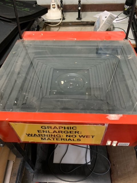

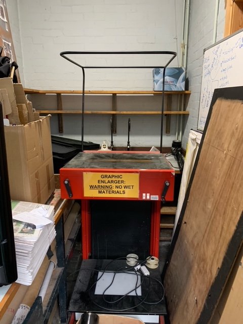

Hi, I'm an art tech in a school and we have this machine in our department, but no one knows what make it is or how to use it!
The only info I have is that someone has stuck a sign on the front saying graphic enlarger and there's a serial number sticker. There's no manufacturer so we are a bit stuck.
Wondering if anyone knows more about it and can point me in the right direction of how to find out more about it. We may use it but we may also sell it.
Thanks!

To me it rather looks like a vertical process-camera, which someone turned into an enlarger.

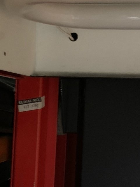

To give you an advise, if at all..., we need details of the respective head. It may be that thing in the foreground of image #2.

I think it’s a “Lucy”. Artwork placed below and cranks turned to enlarge/reduce as needed. Then artist would tape tracing paper on top and trace the outlines
Well, this would explain the "canopy" frame, I was wondering about from the start: to hold a dark cloth.
What I am missing then are any lamps for reflective lighing or at least mounts for such.
But what we see instead may be a smaller format light box, to which the "not use" warning refers.
The right term then would be:
Tracer Enlarger
But so far I have not found anything of this design, let alone this model...
Anyway, likely a manufacturer of a process camera offered a model for the art world where he substituted the film back by a glass plate and added that canopy (the resp. bushing look not homemade to me).
The two switches then are for two lamps for reflective lighting, in this case substituted by a light box.

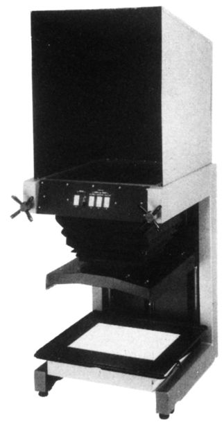

Lucigraph, Lucidograph or Luci, Lucy.
Art students used them a lot back in the day, like they would use an opaque projector.
They can look like process cameras, sometimes a booth. That’s right AgX, the wire frame above would be for a dark cloth canopy for the artist to stick their head under.
Probably just has a circular tube fluorescent bulb to light the easel.
Someone definitely tried tracing on wet materials at some point.
We had one in graphic design school. But it looked more like a booth.
Never even heard of such. I guess it was an american thing.
What I know instead are trace projectors. Even once came one across at a fleamarket, but never at an academy.
The only thing common were episcopes, but this was again a different concept, again being a projector, and only for reflectecd light.
