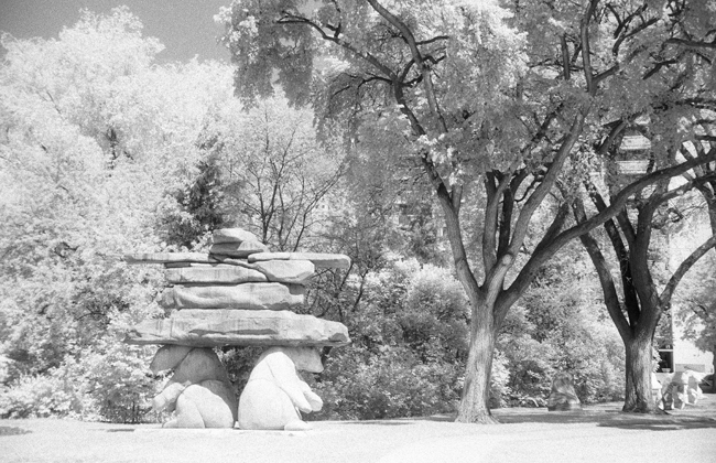

SFX 120 format, Rolleiflex 3.5f, developed 9 min in HC-110.
Rather than setting the EI as Jim does, I meter at ISO 6 and expose accordingly. A brightly lit scene would have a typical exposure of around 1/4 sec at f16. In 35mm or 120, SFX really has the ability to make ordinary scenes literally pop off the paper.

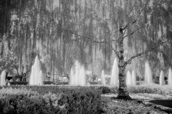

SFX 35mm format, Nikon N-80
[edit] Both shots with Hoya R-72 filter.

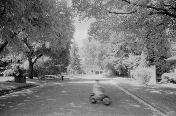

Just thought I'd post an update since many of you were so kind to help out.
The results were super grainy! I used 35mm though. Developed in HC110 dilution B (9 minutes) in 20 degrees. Agitated (inversion) 3 times per minute.
All water temps were within 1 degree of 20.
Toffle
Mar 27, 2007
1,930
Point Pelee,
Nice work, Macy. I think I like the middle one best, though the blurry bicycle is pretty cool too. Now that you're over your beginner's jitters, you can get out there and make the film do what you want.

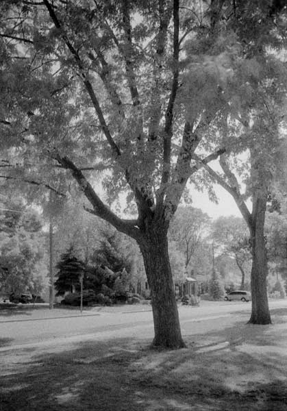

Hmm- I shot SFX rated at 200 and exposed through the fiter Ilford sends with their sample pack (89B, I believe), developed as you did in HC-110 dil B for 9 min 20 Deg C, agitating as I do for all 35mm (10 sec per minute- Ilford's directions on their site). I got pretty good negs with not alot of grain. Similar IR effect to HIE but less grain, actually. This was last summer, so the info's not in my forebrain, but I did some testing and made notes based on what my meter was telling me, compared to what Ilford's exposure recommendations are in bright sun through that filter (see the SFX fact sheet). Ilford's recommendation was bang-on every time: f/5.6 for 1/30 sec or equivalent.

Tim, wow, your negs are MUCH better!! (way less grainy!!)
So let me get this straight...you rated the film at box speed (ie, 200), put on the 89B filter, and just let TTL metering of your camera do the metering? You were using an SLR I presume?
I just read the fact sheet and it appears that the 89B filter and the one I used (92) are both "very deep red," thus should be similar. I'll try it again using your exposure (f/5.6 at 1/30s).
timbo10ca
Apr 27, 2006
590
Winnipeg, MB
I didn't really "rate" it at all, I think that's just what the speed turns out to be with that filter and that aperture/shutter combo. I only used my meter (yes, on an SLR) to compare to what Ilford recommends. Usually the meter would agree, but when it didn't, it was *always* wrong on those test shots. I think it usually had to do with me taking my eye away from the eyecup to check the upper display for the aperture/shutter speed- this allowed light in and confused the meter (didn't know that would happen, but I was wondering why the heck the meter was jumping around all over the place- finally figured it out halfway through the roll). Sometimes it was just a "confusing" scene, I guess. If the meter agreed with Ilford, I made only one exposure.
I don't know alot about IR, having only used a 25 filter with HIE, but I don't think your 92 and the 89B are equivalent- you may be cutting off too much of the useable IR spectrum for SFX and underexposing using Ilford's guidelines. You can't just go by the "stops darkness". In this, I may be wrong but I'm sure someone will correct me if I am.
