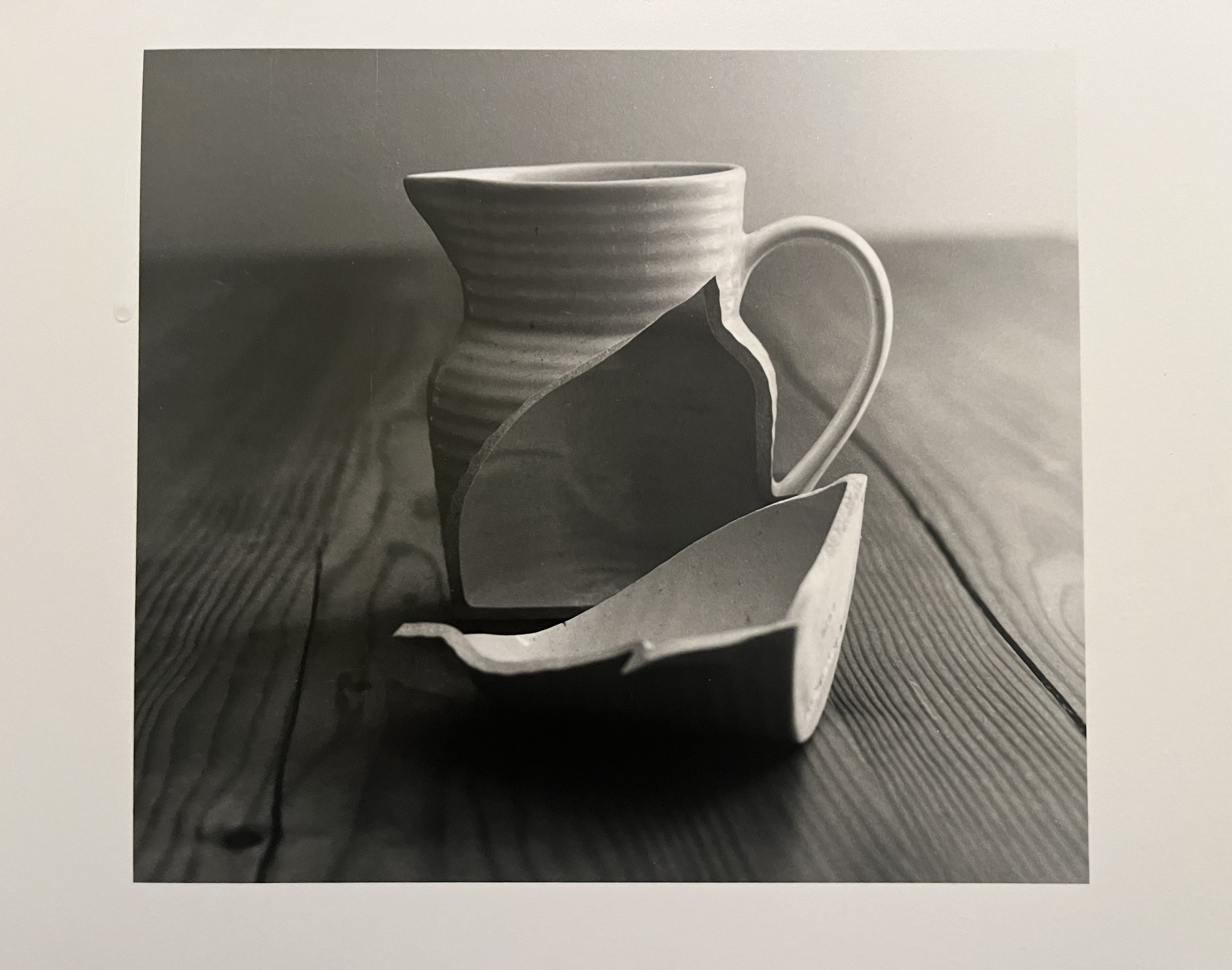

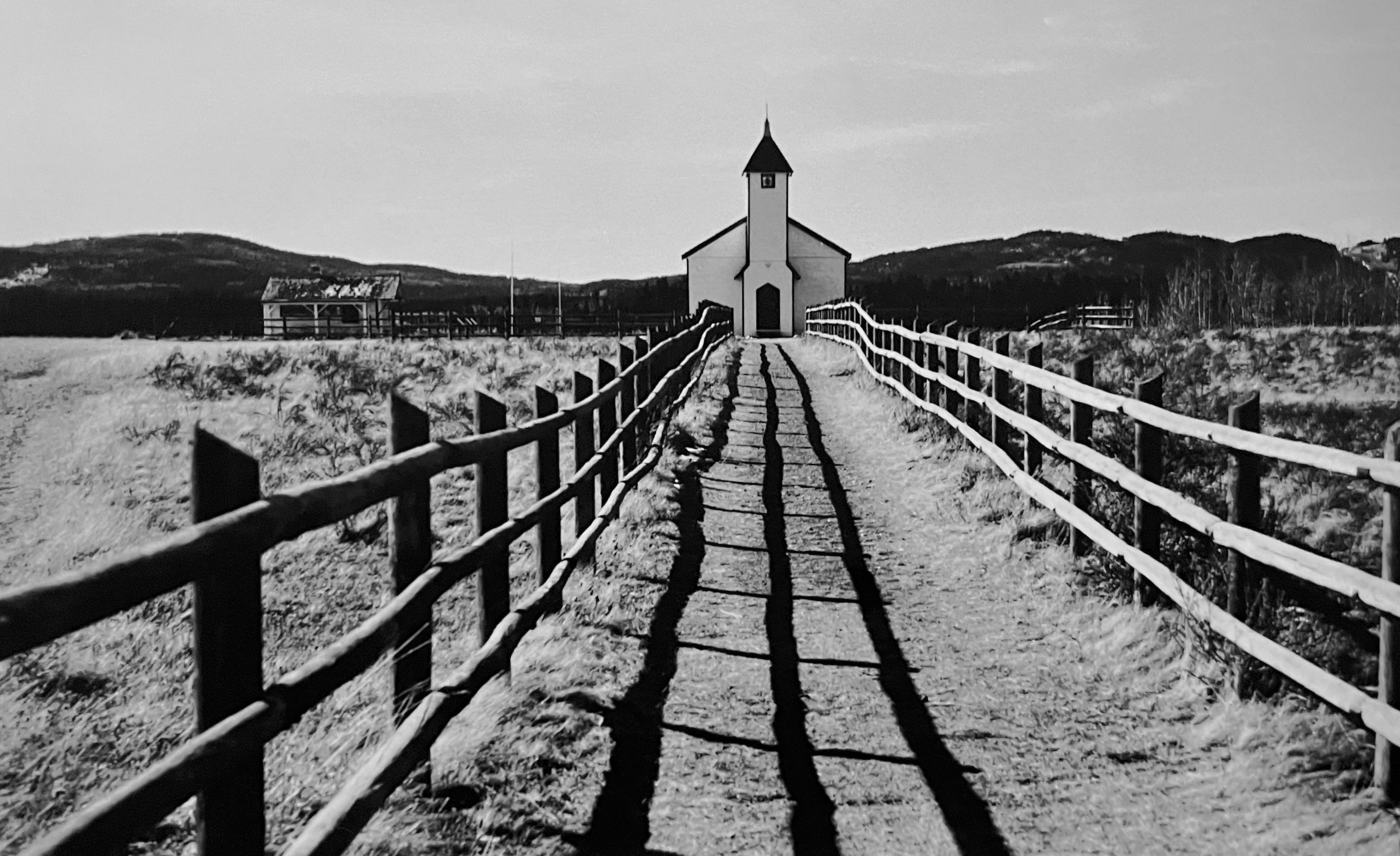

For years I've used FP4+ in roll and sheet film. I was never happy with highlight separation with HP5. Always used Tri-X & TMY2. Since the USA election in Nov, I have stopped buying Kodak films and added Delta 100 & 400. Fine results in my normal developer Pyrocat HD, both in subdued light and in bright conditions.

I use it in the winter for FP4 like response with extra speed - both 35mm and 120.
