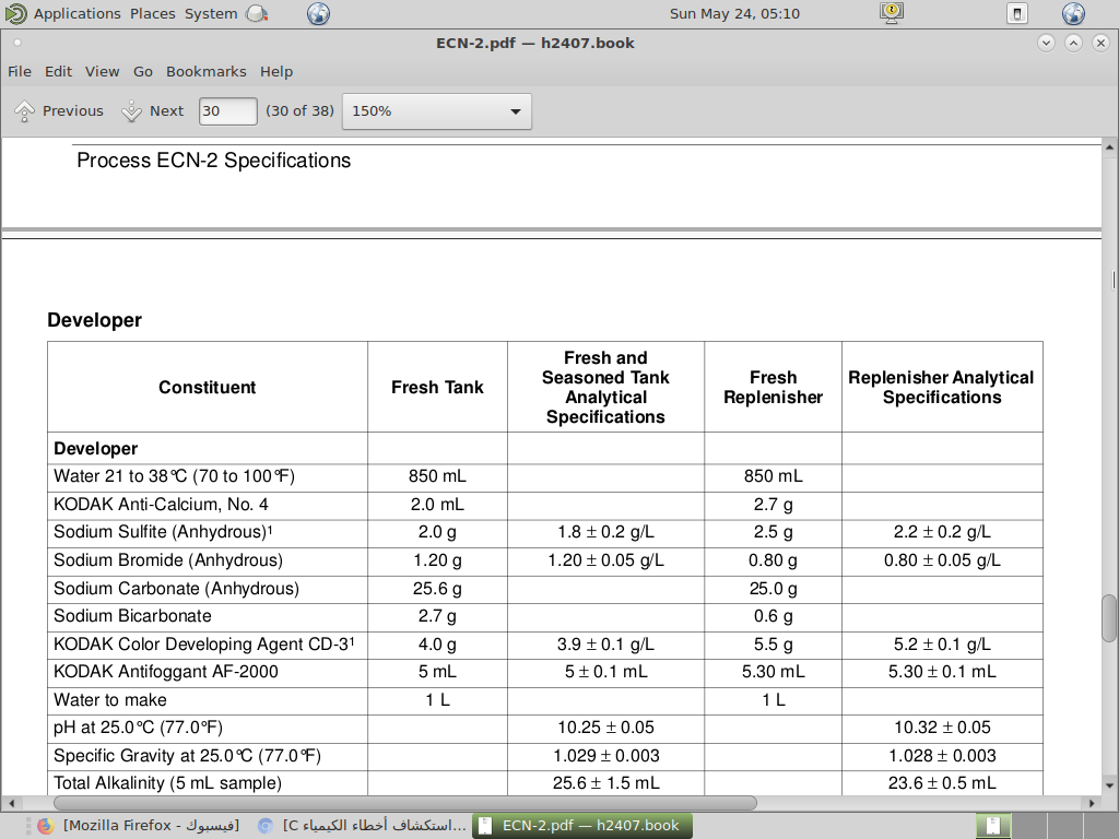

mohmad khatab
Sep 8, 2012
1,228
Egypt
When you destroy my pH meter, I resorted to that recipe, it fulfills the purpose completely and is very impressive and you will not need a pH meter, only you can add half a gram (KOH), and replace (Anti-Calcium, No. 4) By adding (Na4). Thank you very much later ..
