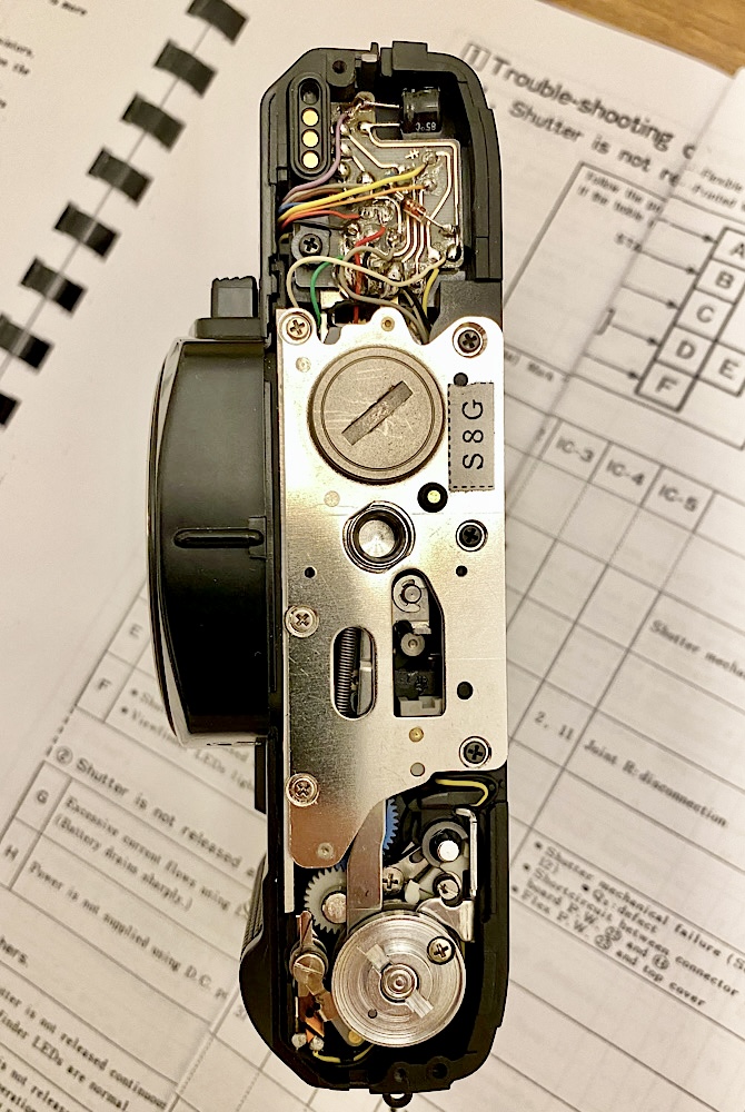

Example of a (failed) troubleshooting using my approach
Minolta X-700: Electronics fault > spare parts box
An X-700 whose LEDs in the viewfinder do not light up and which does not trigger.
I start by troubleshooting electrolytic condensator C10 in the camera base:
  • Unsoldering the electrolytic capacitor, measuring the capacity with the multimeter - ok.
  • Solder in
Look at the circuit board on which the electrolytic capacitor sits:
  • A conductor track is broken and I'm bridging it. A second X-700 that works acts as a reference.
  • The circuit board looks worn out, I finally decide to replace it. Replacement comes from an abandoned X-700.
  • Some soldering work as several cables run from the camera to the circuit board. Unfortunately there is no change in the status, the camera remains dead.
Replacing the circuit board in the camera base does not resolve the problem.
I look at electrolytic condensator C9 in the upper deck:
  • It has obviously already been replaced, the soldering is quite tough 😉
  • I unsolder the electrolytic capacitor, measure it and connect it to the camera using two extension cables. This way I can test whether there is a change without having to do the delicate installation work.
  • Unfortunately no
  • Even an open ground cable that I soldered on on suspicion doesn't decide the match for me.
In the service manual, this error pattern only refers to the power supply.
  • There is voltage on the electrolytic capacitors and on the small circuit board where C10 is located.
  • The solder joints and components on the flexible circuit board above the prism show no abnormalities.
  • What I can see, I have seen. The rest of the circuitry is hidden in the five ICs, in the housing and in the sandwich of the flexible board, which I leave as it is.
  • Maybe the previous owner shot one or more ICs due to static electricity - I don't know.
  • A red dot on the housing and into the spare parts box.

How long did it take you to get as far as you did? If the IC board is bad, replace with a donor body, same age, what are chances the donor card will go bad soon after replacement?
All in all it will have taken around two hours.
It would be possible to replace the entire electronics. This is the folded flexible circuit board with numerous cable connections. For this I would have to use a defective X-700, whose electronics are intact, as a donor. I have nothing there. The work is extensive, but can be done with instructions.
If I could manage to identify one of the ICs as defective, it would be difficult for me. I was able to unsolder the small components with 64 pins in the experiment, but not to solder them in, at least not with perfectly soldered pins. In addition, the board is not flat where the ICs are located, which is a complication when soldering.
IC 3 and 4 are in the circuit board sandwich. To get to them I would have to at least partially dismantle the circuit board. Without knowing for sure that they are the cause of the problem, although in the C & C Troubleshooting Guide to the X-700 there are test procedures for the two that are made on the top of the board.
So that was the end of it for me.
I think that these boards were intended for complete replacement rather than repairs.
But maybe I'll try it again, there are still candidates for repairs here.
If the replacement was successful, I don't see an expiration date for the board.

As already mentioned, soldering on this uneven board with very narrow pin spacing and easily coming off conductor strips is tricky. Even if I can swap the two directly accessible ICs on the top, I would have to completely dismantle the board for the other two, which is a lot of work with corresponding risks. In addition, determining the error is anything but easy. As far as I can tell, there are three sources of troubleshooting instructions for the X-700. If these work, you're lucky, if not, you're in the dark. Ultimately, you have to weigh up whether you want to invest time and work or whether it would be better to replace the electronics straight away.
But I would like to turn it into a project that we can work on together here.
There are still a few X cameras here that should have errors. It would be enough to do some electronic troubleshooting on an X-300 or X-500. Although they have fewer ICs, their structure is comparable.
We could go through troubleshooting, desoldering ICs and soldering them in, right on their original boards.
How do you think about this?
