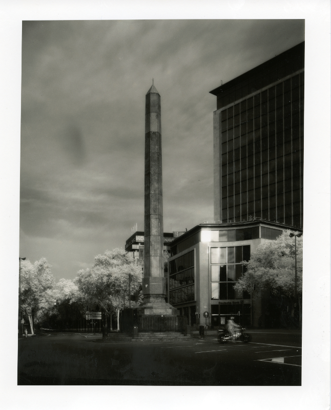

The pictures below show perfectly the problems.
They were copied the same day, on Ilford MGWarmtone, developed with Ilford Warmtone developer, 1+9,
odourless stop bath, tetenal superfix 1+3 1m, rinsed during 5m, lavaquick during 5m and washed
during 30m in a washing processor. They may have slightly different grades and exposures.
The toning session was some days later. Each copy received a different treatment:
1. KRST + gold,
2. KRST + thiourea + gold,
3. KRST + thiourea,
4. thiourea.

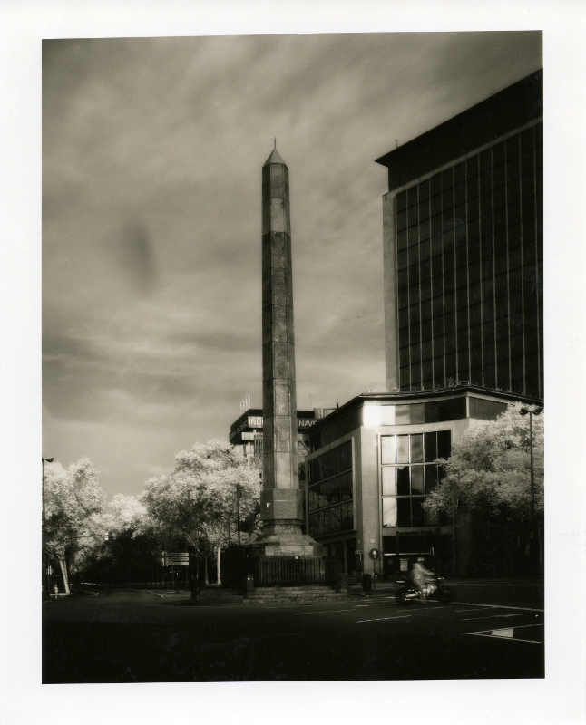

My main concern is with picture number 2. You can see that the clouds in the sky are full of
irregularly distributed pink stains. These stains appeared during the gold toning after the thiourea.
I don't know were they came from. They do not appear if the thiourea is skipped (picture 1) or if
the gold is skipped (pictures 3 and 4) independently of the selenium step. I have two different guesses:

I have included picture 1, where everything looks ok, for reference. Picture 3 has also some stains, similar to
those in picture 4.

Bob, Jim, thanks for your answers. I have also considered that
possibility. In fact, washing water was particularly cold that day, 11ºC
(around 52ºF), and then washing after KRST may have not been
enough.
However, if there had been fixer left in the print, wouldn't the stains appear
in the ferri bleach, regardless of the gold? But the stains only appear
with the gold toner - and before the last fixing bath -, and only after thiourea.
Besides the pictures in my post, I have a few other examples (processed in different days),
with the same pink spots, again, only if gold after thiourea was used.
Anyway, I will be more conservative with the washing step.
Thanks!

I think you will find that Gold toning after thiourea goes pink then red and as thiorea tones the highlights first then they will go pink/red with the gold. The KRST will have affected the shadows first and stopped any thiourea toning in the shadows. In short the pink colour may not be staining but toning, thiourea plus gold equals pink/red

Yes the pink is the gold effect I see after sepia., blotchyness is the problem which I feel is improper fix time, strength, followed by too short of a wash or too cold of a wash.
