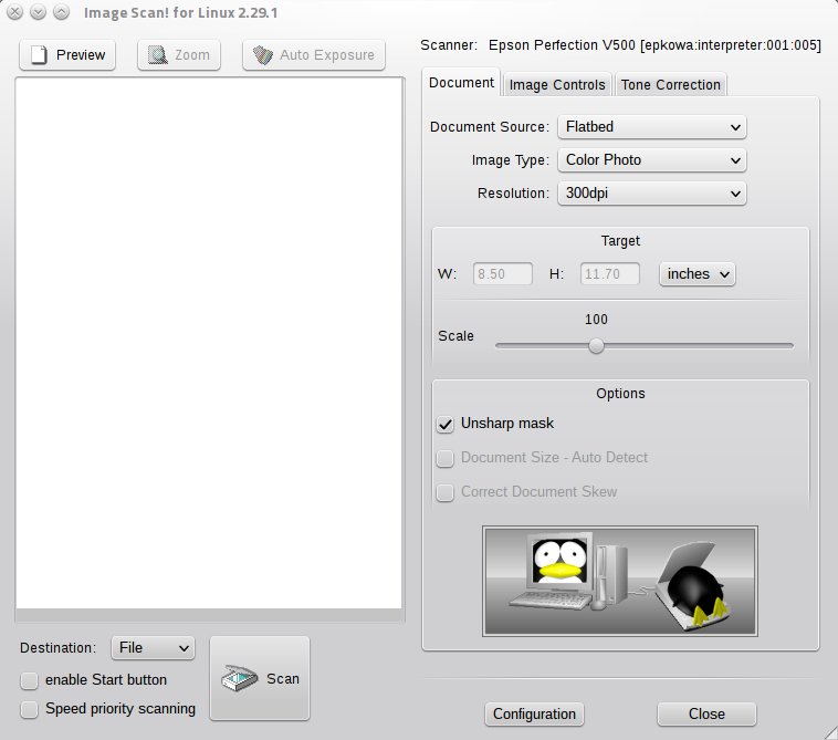

Actually there might be one important thing I forgot to mention and it could be the answer to your question. I am using Linux and the Epson scanning software is really basic. Here's an image so you have a better picture.
So it seems that the Epson software under Windows is more advanced which would explain the different experiences we exchanged. And the Velvia pictures on Flickr have similar tones as mine so my workflow might not be actually that bad.
I follow that the mechanics of the scanner are the same and Epson software and Vuescan should work the same but I am not allowing any postprocessing in Vuescan + I scan raw and do the rest in Darktable or others. Also I don't mean it's dramatically different. It's actually not different at all. Only when I pixel peep and such a difference has no importance for me at all. It's because of the others options I use Vuescan and maybe when you see how the Epson software looks under Linux you'll see what I mean.
