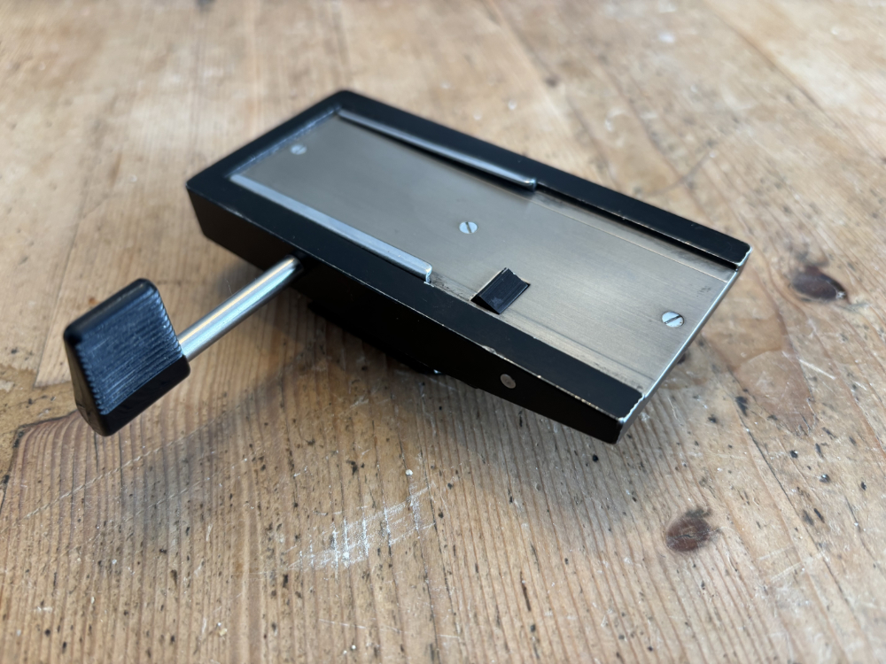

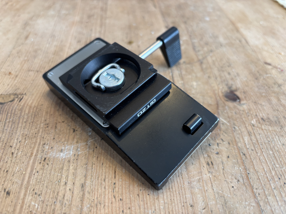

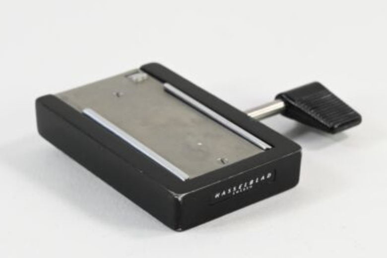

Hasselblad made one for standard screw-type tripod heads:

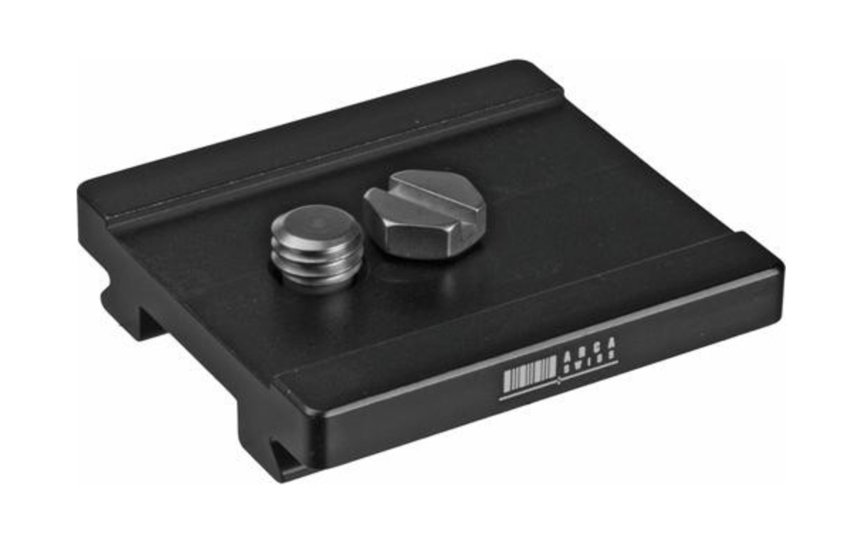

And you can get a Arca-Swiss type one as well, if you have that kind of tripod head/adapter:
I use the Arca-Swiss type - works great!

Are you removing the standard Hasselblad style foot that uses the Hassy QR plate and putting an Arca style plate in its place? Or are you just threading the Arca plate into the holes of the existing foot on the bottom of the camera body?
I ask because I have done the latter and it makes packing the kit awkward due to how much it sticks out and not as nice to hand hold. I also have four 501CM's, two Flexbodies and a 350mm Superachromat that all have standard Hasselblad QR feet so it gets a bit wonky.

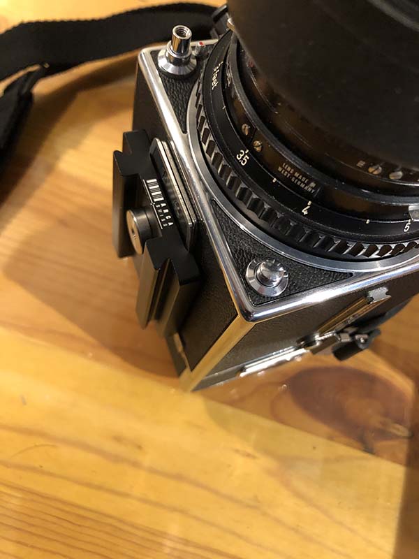

I know I'm not the person you asked, but the AS-brand Hassy plates I have fit nicely onto the original Hassy QR foot and then have nice countersunk/flush mounted Allen screws on the underside to secure them to the factory tripod screw.
The AS plate attached to the camera stands maybe 2mm proud of the bottom of the camera. It's not as low profile as having nothing but the factory QR foot, but it's pretty darn low profile.
This is one of the beauties of the AS dovetail(which actually isn't totally unlike how the Hassy factory system works). The attachment itself is low profile enough that it's really not an inconvenience to leave the plate on all the time.
Most of my cameras I actually use whether 35mm, digital, or MF have AS plates semi-permanently fixed to the bottom. In fact the only ones I don't think I have them on are my Leica M and my Pentax 67-the latter because none of the plates I've used have fit in a way I was happy with. I carry allen wrenches in all my bags to remove them if needed, but rarely do I need to.
As a side note(and I love the AS system if I haven't made it clear) there are even times where the AS plate can integrate so nicely that you don't even realize it's there. On my big 35mm format Nikon lenses(70-200 2.8, 300 2.8, the 200-500 5.6 when I still had it) I've replaced the factory tripod foot with a Really Right Stuff foot. They look for all intents and purposes like the factory foot-in fact I'd even ordered one for my 300 2.8 before realizing it already had one-but have the dovetail integrated into the foot so you literally just clamp it right into the tripod head. I have a grip for my Fuji XT-5, mine an aftermarket but basically a copy of the one Fuji sells for 3x what I paid, that integrates the dovetail into the bottom of the grip.
As Ben mentioned, the AS plate slides onto the Hasselblad foot and is secured with either a 1/4-20 or 3/8-16 screw (both are provided).
It is really nice and compact. Here are some pics.

I have Arca-Swiss clamps on all of my tripods. It is the de-facto universal mount. For my Hasselblads I screwed an Arca-Swiss compatible universal camera plate to the bottom of a Hasselblad tripod quick coupling. No changes to the Hasselblads themselves and the tripods instantly switch between the Hasselblads and my other cameras.
