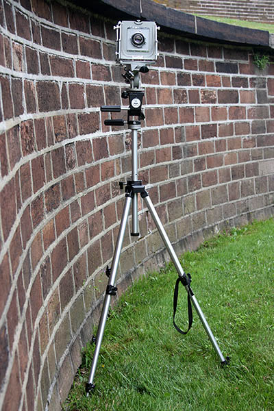

I've now had my 3021/3447 for a month or two and have used it extensively with GVII (photo attached) and Canon DSLR. It's been performing great - solid, stable, easy to adjust. My only issue with it is the size and weight - wish it were lighter. And, I've had several occassions (such as shown) where I only extended one portion of the legs and used the center column or it would have been too tall.
Dan

Dan, It's better to use the center column extension only if you have to. In other words, it's better to use leg extension rather than column extension. Rap on the with the center column down, and then do the same thing with it extended. Compare how large the vibrations are and how long they last.
