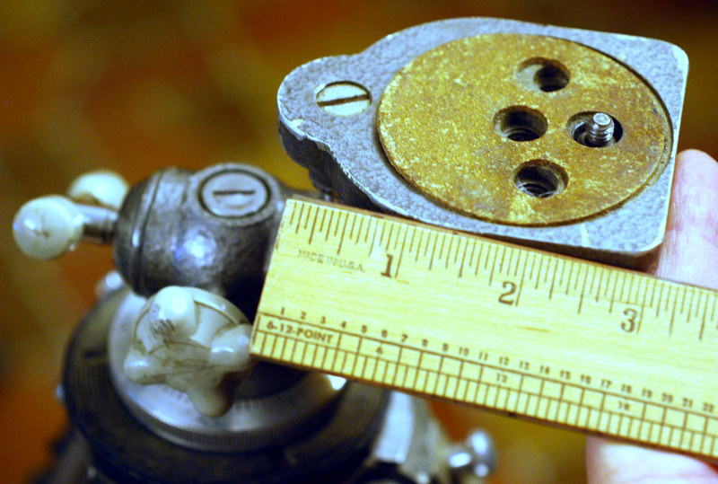

I'm looking for a tripod quick release adapter and plates that I could use with several of my cameras.
I'm using an old Gitzo ball head, not marked, on a Gitzo Studex Performance. You can see it's shape and size in the attached photo.
I'd like to find an adapter I could screw onto the ball head that takes something similar to a hex plate- one that drops in rather than slides in. It would need to be fairly light weight and tight fitting- this is not the best ball head around :-(
I used to own an old Bogen 3047 head that took hex plates... I'd like something similar to that type of quick release- plate just drops in and springs closed.
I've seen some inexpensive ones on eBay, but not sure they will fit or if they are accurately built enough to be rigid (not sloppy).
Recommendations? I prefer not to buy a new ball head (with integrated quick release), but might consider one if not too expensive. Camera(s) and lenses is gonna weigh in the neighborhood of 2-3 pounds.

The world has largely found that 'quick Release (QR) plates compatible with the Arca Swiss system provides the widest variety of different brands that are -- generally speaking but NOT universally true! -- interchangeable.
There are adapter QR that can mount in place of the QR plate which came from the factory...you simply need a head whose original plate is hold on with a SCREW....some manufacturers QR are not removeable! Diameter of the screw threads used to secure the adapter to the head is typically 3/8" (better), or 1/4". Example of such an adapter plate is made/sold by RRS.
One example of a QR adapter: https://www.reallyrightstuff.com/b2-duo-clamp
Adapter QR can lock down on baseplates (mounted to the bottom of the camera with standard 1/4" tripod screw (a few camera bases take a 3/8" tripod screw)
https://www.reallyrightstuff.com/BGE4-Plate-for-BG-E4-BG-E6-grips
...from a number of different manufacturers of Arca-Swiss compatible QR plates, if the QR adapter uses a thumbscrew lock. Due to the lack of a true 'standard' the QR baseplates can have a very subtle difference dimensionally, so if the QR adapter uses a Lever lock (rather than Screw lock) some QR baseplates might not lock properly into the Lever-lock style QR adapter from a different manufacturer.
https://www.reallyrightstuff.com/b2-as-II
There is a Manfrotto / Bogen hex plate adapter that mounts on your tripod head and provides a hex plate quick release. The part number is Manfrotto 625 / Bogen 3296. You can buy these new or find them used (ebay, etc). It does add some height and bulk. If you go this route, be sure to mount it very securely so it can't rotate on your head. I think there are a couple of set screws in the adapter that can help with anti-rotation.
