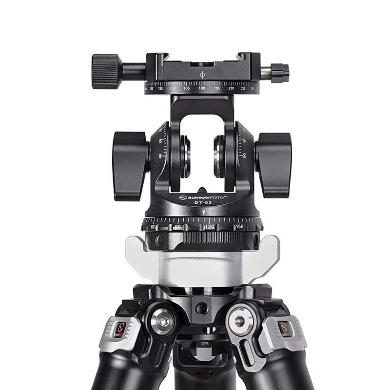

I have that same tripod, which I matched with a Sunwayfoto DT-03R Tilt Head with 360 Degree Panoramic Arca Swiss Clamp. You'll want to get an extra quick release clamp without the bump on it for the 4x5.
I had noticed this one….You’re saying this will handle a lightweight 4x5 without difficulty? My 120mm is fairly heavy… There are more than one version of plate?

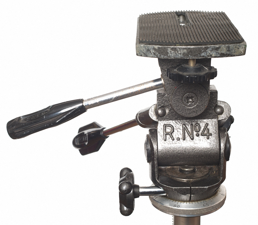

I use Gitzo heads, my 10x8 Agfa Ansco sits on this one.
I prefer the longer control arms it is far easier to set up my cameras, I have 2 more a slightly smaller R,No.2 and a more modern G 1370 which is more compact in terms of height. The other advantage is the quite large tripod platform.
With a 10x8 camera sat on a tripod, short tripod arms are very awkward to use, it's harder to make fine adjustments.

Yes it handles lightweight 4x5 without a problem. Your biggest problem with a heavy lens on a lightweight 4x5 is the stability of the front standard with that heavy lens. In addition, the Sunwayfoto head is a good match with the tripod - for example, I wouldn't put a heavy geared head or a large pan head on those Leofoto legs. As for the plate - you can buy any arca compatible QR plate without the front bump and it fits in the Sunwayfoto clamp. For my Fuji GFX, the L-bracket fits directly into the top of the Sunwayfoto clamp.

Just seconding what djdister said. As I mentioned in a different thread, I have a Sunway DT-03 and an Intrepid 4x5 (although I haven't used the Intrepid on the DT-03 yet). There's zero doubt in my mind that the DT-03 is more than strong enough to handle the Intrepid. It's also fairly nice to use -- i.e. its tilt and pan motions are smooth yet fairly well damped. Lock levers are fine (the pan lock is maybe a little small, but not a big deal.)
I'm sure an Acratech Panorama head is nicer, but I like my DT-03 just fine, and I've used it with some reasonably unwieldy gear -- a Bronica GS-1 system -- with no problems at all.

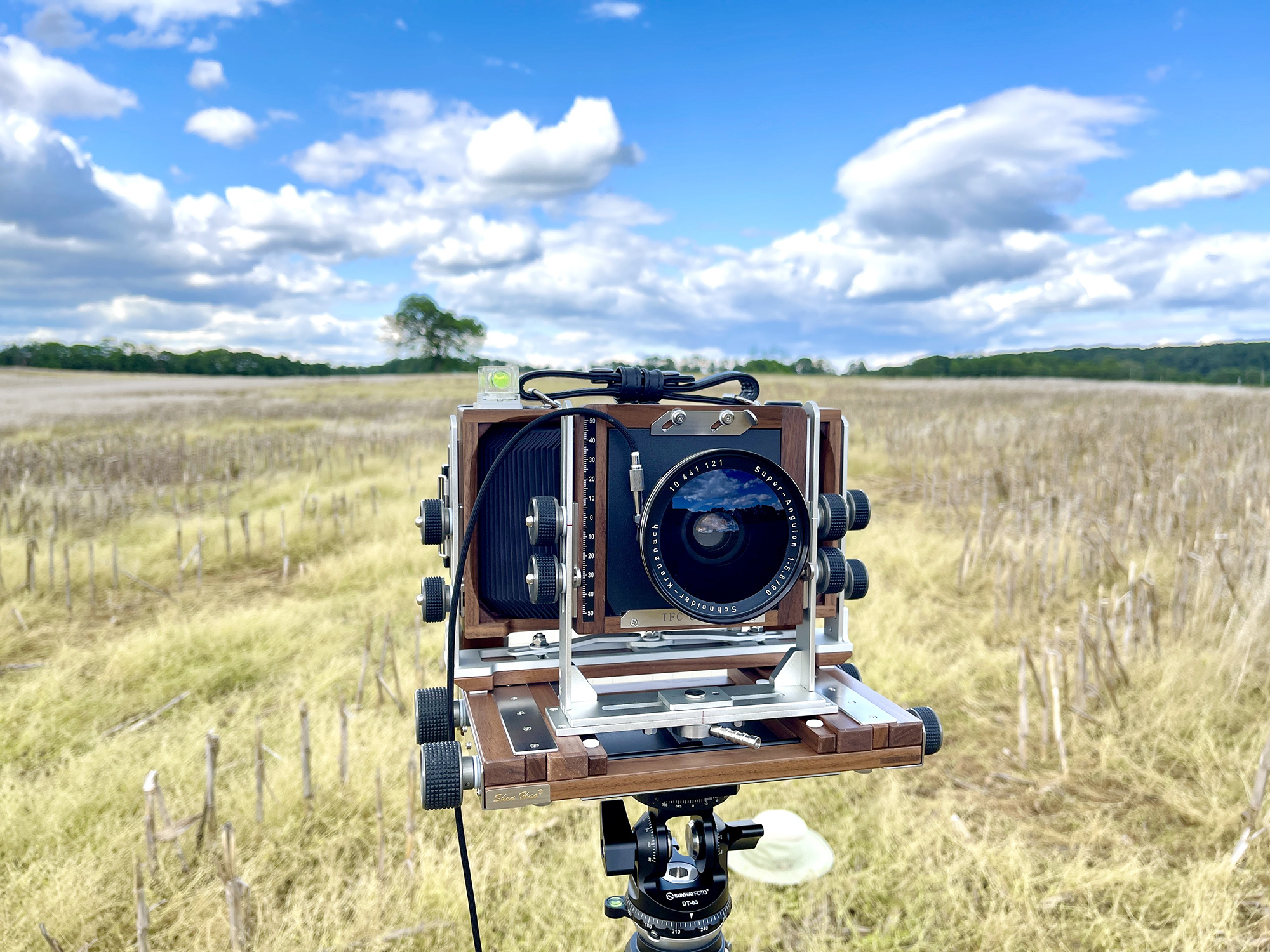

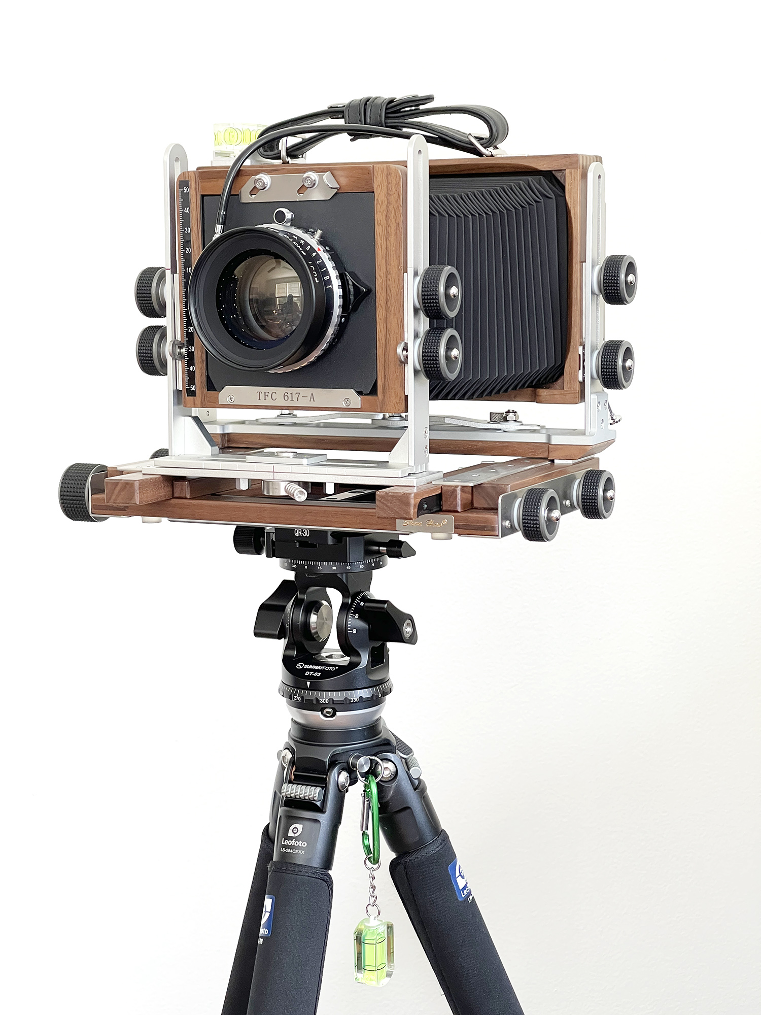

As for my Leofoto/Sunwayfoto combination - below is the maximum weight load I have used on it. That's a Shen Hao TFC617-A camera with a Fujinon 180mm in the first shot and a 90mm Super Angulon in the second shot. This tripod/head combo also works well with my Wista 45SP and Horseman 45 Woodman, as well as my Fuji GFX.

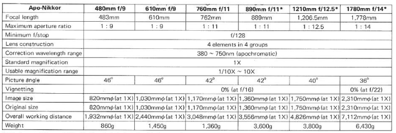

I've seen, at one time or another, almost everything, but not many process lenses, especially Nikons, that must be one huge piece of glass!
Acording to Kumar's listing, it has a 200mm flange. And according to a datasheet:
3.6 kilograms!
I have the 610mm listed up there and its close to being too heavy to use! At least the 610mm will fit on a 140mm Sinar board.

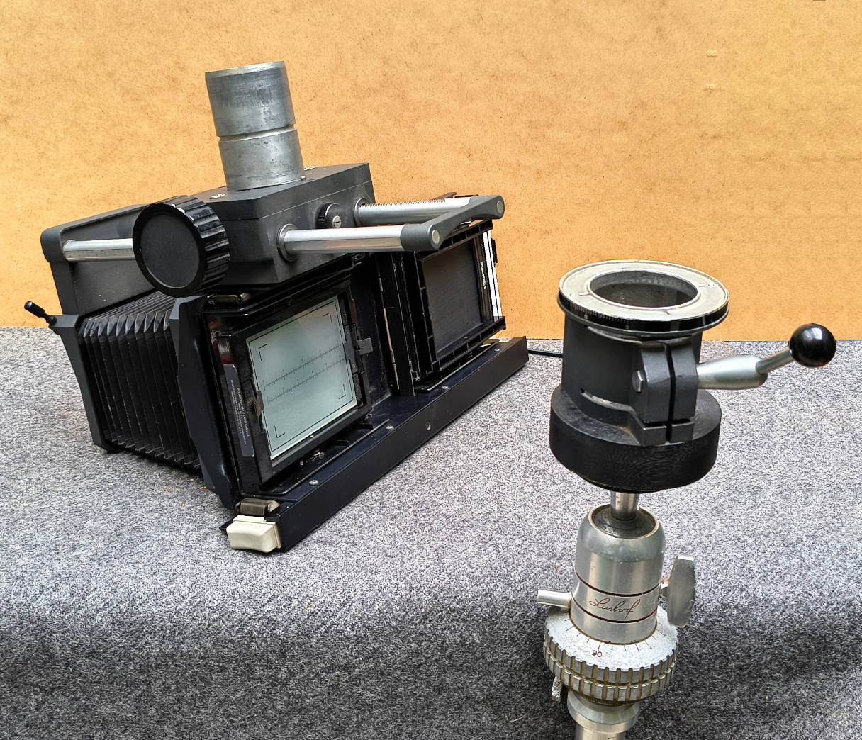

Since ages I use an old Linhof ball head. These are cheap as they are old, but this one carried my 8x10 configuration without any problems. It sits on an old Linhof large format tripod, cheap as well, sturdy as hell, huge, but not exactly lightweight.

This site has been a great find. I’ve gotten so much good info and guidance here. I’m going to order a DT-03 or 3R (and probably the OEM Intrepid Arca plate. Can any of the several people here who are familiar with the DT03/03R tell me what the difference(s) between the two models are? TIA

The DT03R has a panoramic arca head clamp, in addition to the panoramic base. The reason I got it was so that I could rotate the direction of the clamp independently from where the base of the head was pointing. I have some cameras where the arca plate will work better poining North-South and in other cases with the arca plate pointing East-West. Since B&H does not carry the DT-03R, I ordered it directly from Sunwayfoto.
Thanks so much. Now to decide how useful that is for me. At present, I only anticipate using tripod with a 4 x 5 intrepid with their OEM Arca plate. I have a leveling base that the head will sit on. But who knows, that could change. Decisions, decisions.
