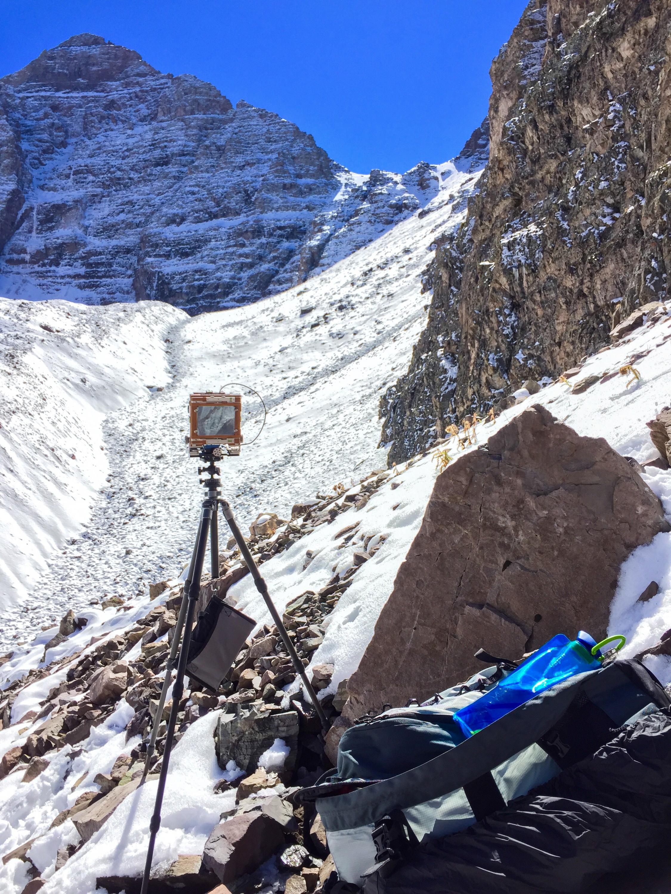

My go to is a 4 pound CF Gitzo 1228, good height, rigid and fairly light. I use it with an Acratech GP head. On down the line would be my Manfrotto 190-4 CX Pro at 3.5 pounds and less than half the price, my favorite ski and macro tripod.
1228 and Acratech pictured....
