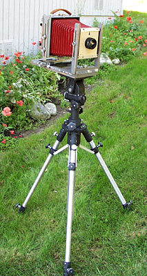

I posted a similar response to a similar thread on ULF tripods. First, I don't have an 8x10, just a Burke & James 5x7. Second, I believe the first duty of a tripod is not to be light but to be rigid. Hence, my choice of a Majestic tripod and head. Sally Mann used one of these on her 8x10. They can be had for as little as $60. I paid $107 for mine with an extension arm. I doubt there is much out there that would be more solid.

I'll second the Manfrotto 475... great tripod in my opinion. Since my camera is a Dorff 5x7 I'm able to use a Manfrotto 410 head on it.
Alternatively, the Majestic pods are stable as the Rocky Mountains! And, very reasonably priced too!
