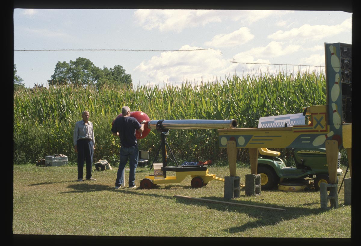

I tried a new lab for my latest batch of E6. 5 rolls shot in 2 different cameras across several months... and they all came back with intermittent scratching on the base side. Argh! This is an expensive, professional, highly recommended E6 lab too. I like everything else about them - the processing was spot on, the slide mounts are smooth as silk in my scanner, the turnaround time was quick. But I just want to make sure it really was the lab. The scratches come and go (some slides have none) but when it's present, it's basically one scratch that wanders back and forth across a whole series of frames in a row, with little interruptions and dotted-line series of divots, followed by long continuous wavering lines. It's basically one long scratch, not multiple scratches, as if something were resting on the base side of the film as it was fed into the slide mounter? Not the perfectly straight scratch or parallel scratches you'd get from a problem with a camera pressure plate or cassette light trap.
Here's an example, with no ICE on the scan. ICE doesn't completely fix this, either :-( It's more horrific looking when magnifying the film as seen with a glare across it, but I don't have a good way to get a picture of that to show you.

By the positioning of the scratches and the break between the two lines I thin it can be ruled out that it was due to grit or other damage before being processes. Also it it had been done before processing there would have been physical damage to the 'raw' film which I know would have removed one or more colour layers and even gone right through to the base layer and been rendered clear film. (Been there, seen it, and done it myself that's how I know) The Lab has a few answers to give.

It doesn't look at all like a camera problem, and the fact that you used two cameras over 5 films does seem to make the only common factor to be a lab issue. I'd take it up with the lab right away.

Also, I wount mind knowing what that is a picture of.
Just a little high speed cinematography mayhem with my brother and his giant air cannon, plus a junk shuffle alley he wanted to get rid of! Here's the d*g*t*l video - I'm still working through capturing the high speed 16mm stuff then I'll edit it up and put it all on YouTube:

The scratches are similar to scratches I got on roll I had processed by a local lab this summer. The scratch wasn't real straight and wandered across multiple frames so I don't think it was a problem with the camera. To make matters worse, I could see what looked like water marks in the sky in a number of my images. Then to top it off, I asked the lab to make a CD scan of the slides and that turned out to be one of the worst scan jobs I've seen.

The owner of the lab got back to me and very much wants to get to the bottom of it - I'll be sending him some of the slides back for inspection (and he's already given me a credit for future work greater than the amount I paid for this processing!) Impressive response.

That's what freaked me out about this - my Coolscan 5000 and ICE usually take damaged film in stride, but this was too much even for it!

Aha! Upon investigation of some slides I sent back, the lab discovered that they were actually some sort of drying marks on the film, not scratches. They wiped off when rubbed with a cotton glove. They suspect it may have occurred on the occasion of dumping and renewing their chemistry, since they don't just keep replenishing forever.
I'm going to take them up on their offer of free replacement processing of my next rolls, and fully expect to be happier with the results!
