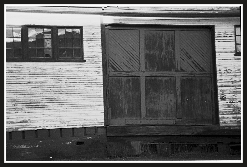

I frankly miss having a grainy film available. Old Tri-X (ie from the 70s) was definitely grainier and not as sharp. The new stuff is a better film if you want finer grain and better sharpness - it's kind of like HP5 on steroids. It makes beautiful enlargements (this is a scan of a 5x7 enlargement). In Rodinal, it still has a real presence and exceptional shadow detail:
Tri-X at 400, Rodinal 1:25 for 8 minutes, Konica Autoreflex and 50mm Hexanon f3.5 Macro lens

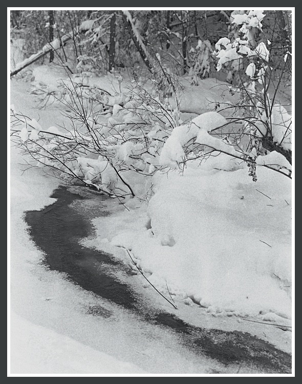

I've had no trouble with blown highlights with Fomapan 400, which I like a lot. I use either XTol 1:1 for 8 minutes at box speed, or HC110 at 1:63 for 11, also at box speed. Here are two examples of these developers on this film (these are scanned 5x7 enlargements)
XTol 1:1, Fomapan 400 at 400, 8 minutes. Pentax MX, 50mm f4 Macro lens:
Here is a snow shot, a surefire recipe for blown highlights, taken with an Olympus Pen FT on Foma 400 at 400, with HC110 at 1:63 for 11 minutes. Lots of detail in the snow.
I know people have said to rate it at 250 max, but my best enlargements and digitized negatives (I use a lightbox and a macro lens and reverse the digital image in GIMP) have come rating the film at box speed in all formats and developing as above. I simply don't overexpose and underdevelop. I've just never been happy with the results.
