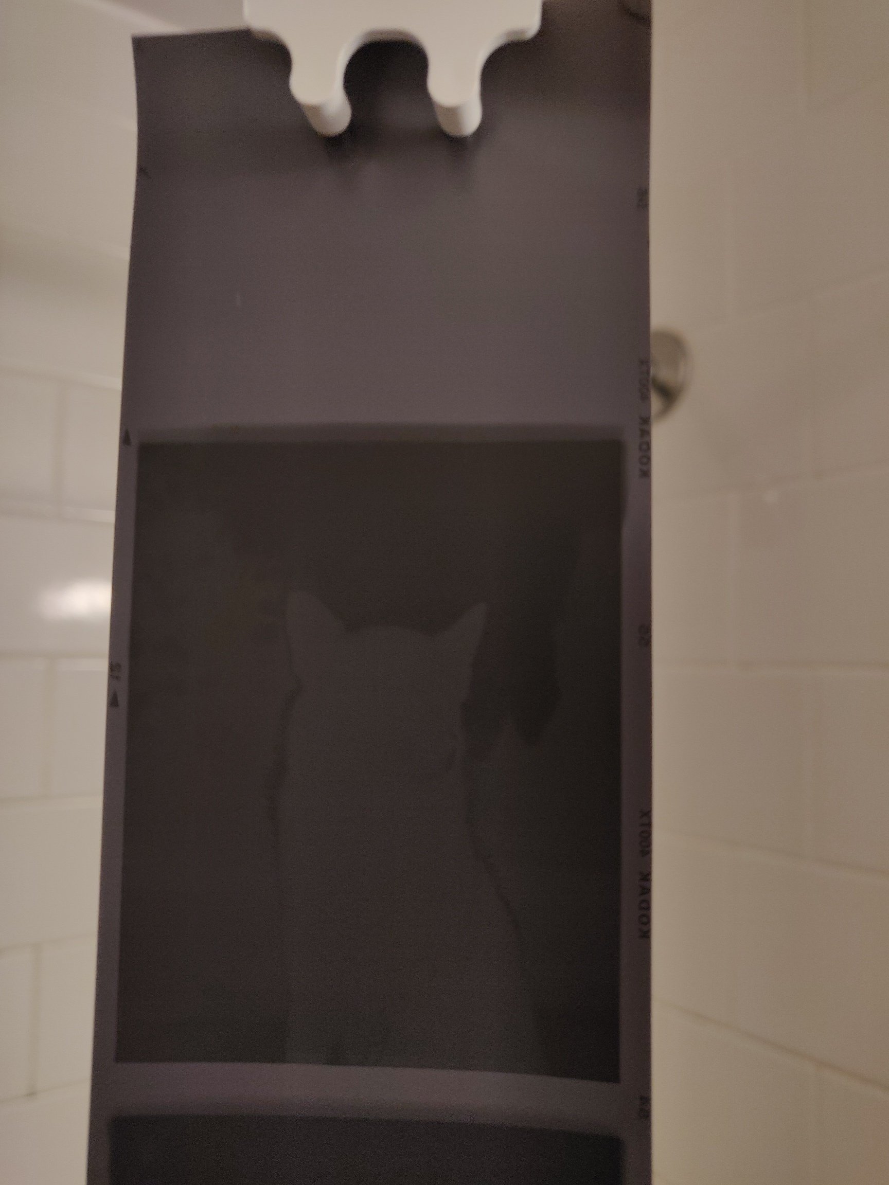

Hi folks, I recently acquired a bottle of Rodinal that I wanted to try out, I developed my 120 roll at 20C @ 14 minutes, with agitation every three minutes in 1+50 (20ml to 980ml for my 2 reel tank, only one reel loaded with film)
I ended up getting some useable, but thick, negatives. They were almost opaque when wound up on the reel and it takes a strong light to get the details out. It almost looks like the baselayer wasn't turned opaque from the developer process.
Any ideas on what happened here? I think they are overdeveloped, but the fact that the baselayer is so opaque, gives me pause. The R09 is quite old, the camera store didn't even know when they got the stock.

Old developer is always a risk, despite the belief that Rodinal is eternal. The density of your base layer looks like chemical fog, which is typically avoided by the restrainer component of a developer (ex: potassium bromide). It looks too uniform to be caused by light (but check your camera/darkroom for leaks while you're there).
A developer is a balance: developing agents want to convert everything to silver, but restrainer tells them to stick to properly exposed grains. So if time/heat has adversely affected some chemicals, then your developer is out of whack.
I say drain it, buy some fresh Adox Rodinal/Adonal, and have more fun.
What about the film... expired?
The sort of "double edge" on the top of the two visible frames leads me to believe this is a light leak. Look in the space between the frames and you will see what I mean.
I seriously doubt it's the developer. I have a half full bottle of Adonal from 2010 that still develops perfectly well.
That double edge is interesting, if it were a light leak, would it be so consistent?
As for developer turned funky- what color, and I know this is not scientific, is rodinal when mixed with water? I noticed the developer went from light orange / peach to steel grey while I was waiting for it to reach temp.
"...I developed my 120 roll at 20C @ 14 minutes, with agitation every three minutes in 1+50 (20ml to 980ml for my 2 reel tank, only one reel loaded with film)."
What tank are you using? My 2 reel tanks only hold 480/600 ml for steel/plastic respectively. Yours holds a liter? if you used 20 ml in 480 ml h2o, that's 1+25 which only needs 7 minutes.
Patterson 3 reel, sorry, its a 2 reel for 120, and 3 for 135 :smile:
If the mix proportions are correct and the temp is measured accurately then it's not the developer. Another look at the neg in the first post looks fogged to me but that could just be the photo. Unexposed 120 film/rebate edges should not appear that dark; it is much clearer than unexposed 35mm rebate edges.
Film looks fogged to me, it doesn't look like a problem with the developer but a film problem, the whole of the film is evenly fogged, leader, between frames and edges, If you try Rodinal again, don't worry about the colour of the developer, as it ages Rodinal can turn to an almost tar like look, also, next time try inversion for first minute then 2 inversion's every 30 seconds, also, for one reel in a two or 3 reel tank you only need 500 ml of developer, that is 10 developer to 490 water, although I prefer to use 600 ml of solution, just make sure that you put the 2 or 3 reels in the tank otherwise you can get the reels slipping up the centre colum,

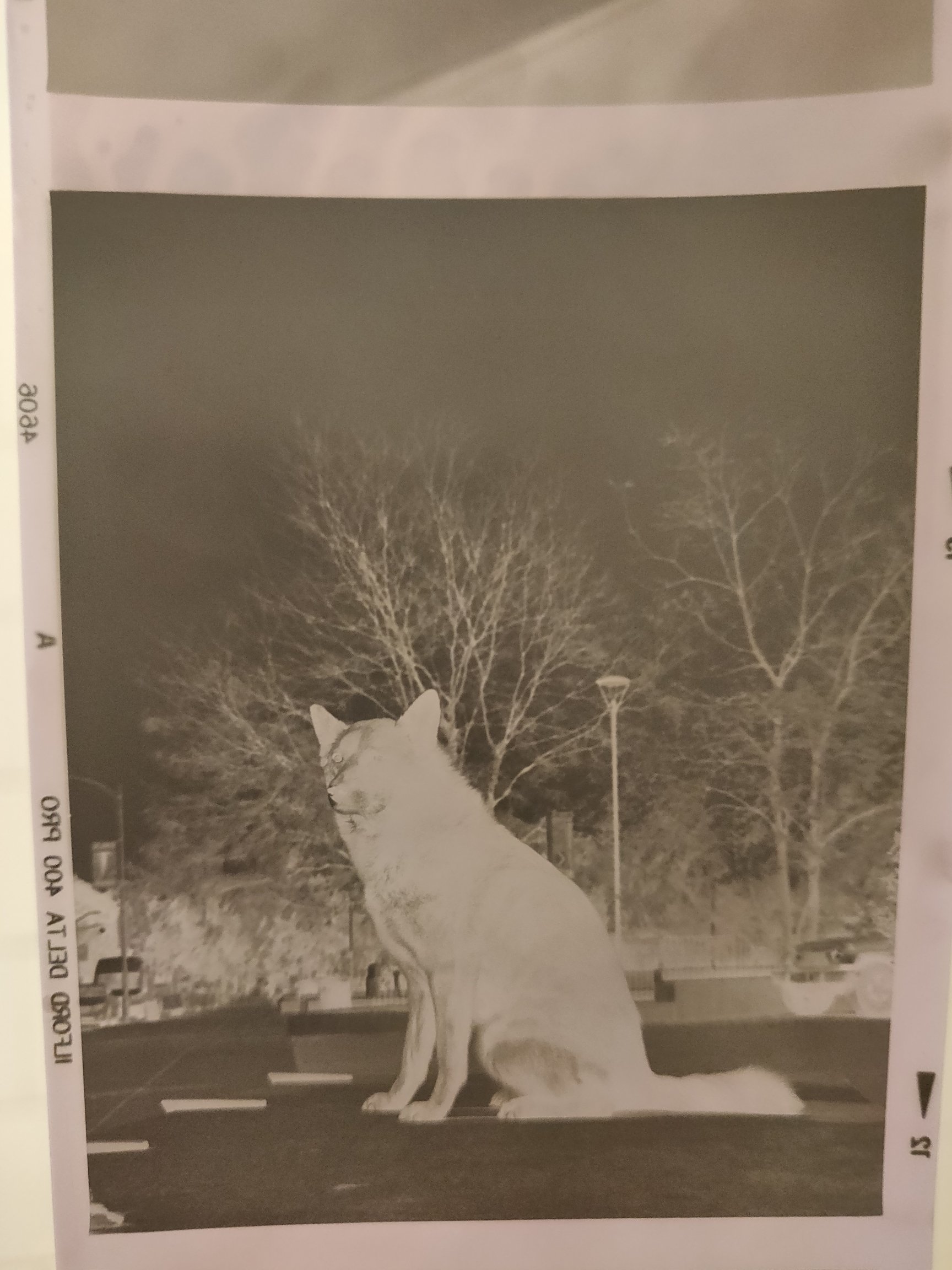

It seems that, some how, despite two rinses, the container was some how contaminated. I shot a roll of delta 400, cut it in half, developed half in adox rodinal (another oldie bottle I picked up, from 2017), and half in r09 (the suspected bad batch) and I got the attached result (from the r09 trial)
The splotches, I attribute to insufficient agitation, as there was a few moments when I lost track of the time and forgot to invert.
+1 almost looks to me like some one had the red light on while loading the film.
Film was loaded in a dark bag, wish I had the space for a red light lit room . This is why I think there's something with the chemistry- a flash of light inside a bag would be fairly directional and not perfectly even.

but for some reason the first negative you showed in your opening post was fogged, I am certain of that,
as to how it was fogged I can't say, but only fogging will give that sort of negative, It could be that the film was not wound tightly, or the film was taken out of the camera in the full sun, it doesn't take much, glad you got the second film right

Richard, thanks for your comments- I'm going to keep an eye on the last frame of my pentax 67 to see if they continue to exhibt this sort of fogging. What am I to look for that tells you, with good certainty that that frame is fogged?
The shot was taken backlit with a large amount of flare behind my dog (I was trying to see if I could control the flare in a meaningful way on the 105). The film was, possibly foolishly, unloaded under the shade of some trees from the sun at around 340pm EDT.
If you look at the frame the whole frame, edges, spaces between frame, all the same so it must have been exposed to light, not strong light as if you unrolled it in daylight, but very very low light, It doesn't take much which is why I speculated it could be not rolled tight on the spool, or unloaded in full sun, I had this happen to me recently, it turned out to be a very slight light leak in my window blackout, took me sitting in the dark for 1/2 hour to find it, not enough to fog paper, but enough to fog film when loading into my reel, that is why Ralph suggested it looked like the film was loaded with the safelight on,it takes very little. unloading the film in shade, even the shade from your body, helps, backlight would not csuse this effect, I have only ever seen this in fogged film, It could even be just one of those things that happen, you get that sometimes with 120,, may not happen again, may happen again, it could be that the back was not closed properly (I have done that), could be that the camera seals need checking,
