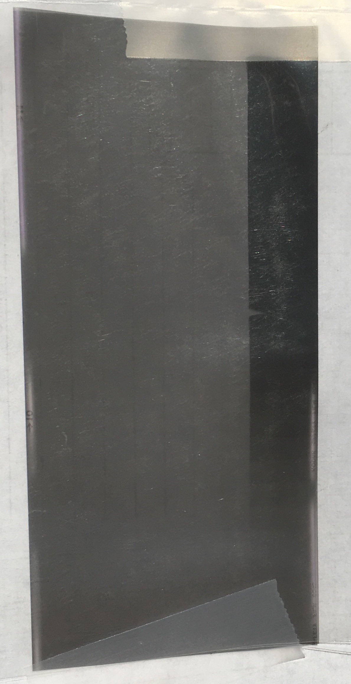

I once had a few rolls of old Tri-X handed to me. I found it to have an “ASA” of 100 due to relatively high fog. B+F 0.38
I would develop between 11 and 13 minutes in D-76 1:1 and select Exposure index at 64 or 100 depending on how I was metering.
You have to give more exposure to “rise above the fog”.
I also had some old 4x5 Tri-X and its characteristics were about the same.
The fog is why people always say you lose speed with old fast film.
Remarkably, slow film doesn’t have that issue at all.
