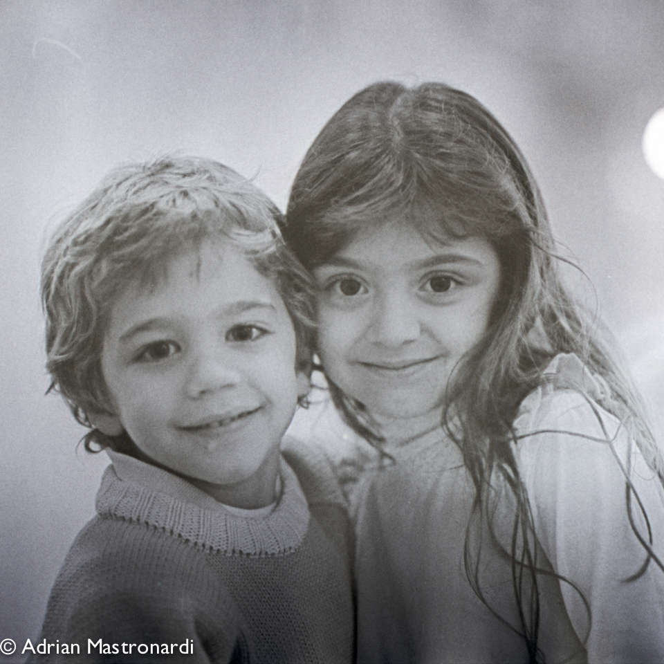

I'm newbie in analog photography and darkroom. Apology if asking a dummy question.
I was playing with Tri-X 400 and found it too grainy. I know that Tri-X is grainy, but I tried to print to 8x10 and it was too grainy. Is it correct or I'm doing it wrong? I developed the film using HC-110 (dilution B) for 6 minutes.
Can I get a finer grain using different chemicals? Which 400 ISO film do you recommend with finer grain?
Many thanks,
AM
PS: the attached photo is an example.

That's a nice portrait. Yes, it's a bit grainy but I don't think it's TOO grainy for my taste. Certainly not as grainy as Tri-X can get.
How deeply are you cropping into the image on the negative? Yes, if you blow Tri-X up too much it will get grainy but a full-frame 8x10 shouldn't be grainy at all.
Pushing or poor processing can make any film look grainy but, in my experience, the main reason is extreme cropping.

But seriously, I have a feeling that your film might be under exposed. It has that look and with underexposure comes more grain.

Thanks for the feedback. The underexposure could be a good reason... I always need to adjust the camera photometer... it seems like I forgot this time :s

Of the conventional films 400TX is the finest grained for its speed. You may be exposing or developing it incorrectly, most people do not find the grain a problem. Other options would be one of the T-grain films or a medium speed film.

Um.... I don't really agree Tri-X is grainy film. I use it and develop it with D-76, pretty much "by the book." While it is not as grainless as T-max or slower other films, grain is very well controlled.
I *think* OP's film is under exposed and under developed. Density range is not there and contrast isn't there either.
You can go to Freestyle's website and buy Arista Premium for really cheap and it's a rebranded Tri-X. I'd say play around with it.... It's a nice film.

Thanks Bill for hearing me out. Exactly, and when I look at that wonderful portrait that the OP, Adrian, uploaded in post #1, I see that area to the right that makes me think, he's photographed this with a long lens (maybe 105mm or more) and the grain will get a heck'a more 'grainy' looking....you add that to the fact that it might have some dev kinks he needs to work out....well you've the perfect storm of sorts. I love Tri-X. I run it in Rodinal and HC-110 and never see grain like what is in Adrian's orig post....

I agree that underexposure might be a culprit. HC-110 also isn't an especially fine-grained developer, and if the issue persists as you change other things, you might consider that as a variable.

With developers I use (D76 and T-Max RS) temperature will have no effect on grain if time is adjusted to give the same contrast.
Out of focus areas may LOOK grainier for the reason Bill identified and thanks for explaining that as it had me scratching my head. But they wont actually BE grainier - focal length will not affect actual grain.
I agree that this looks underexposed. That (and overdevelopment if you try that to compensate for it) will make photos grainier.
If Tri-X is still too grainy to suit after dialing in development switch to TMY-2. Or, my preference, simply a bigger negative!
