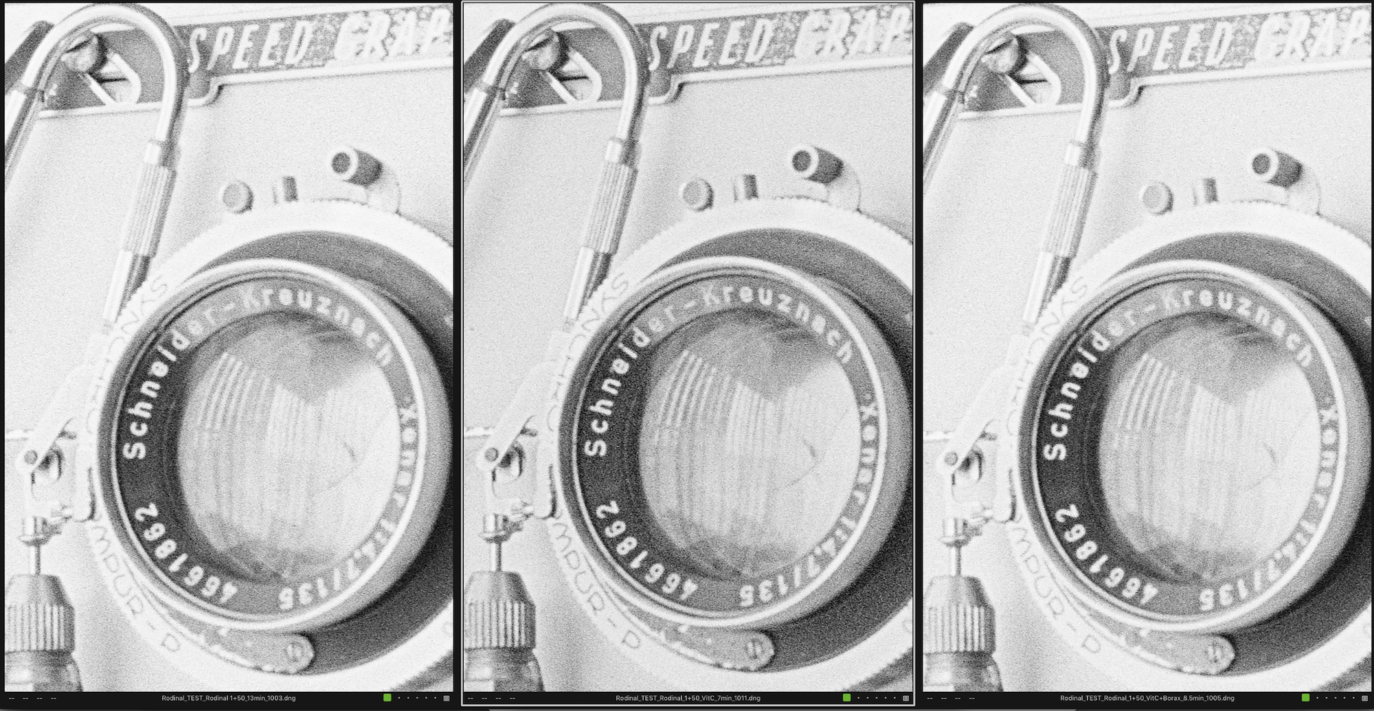

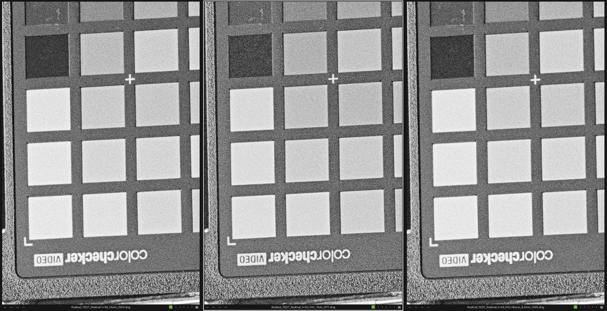

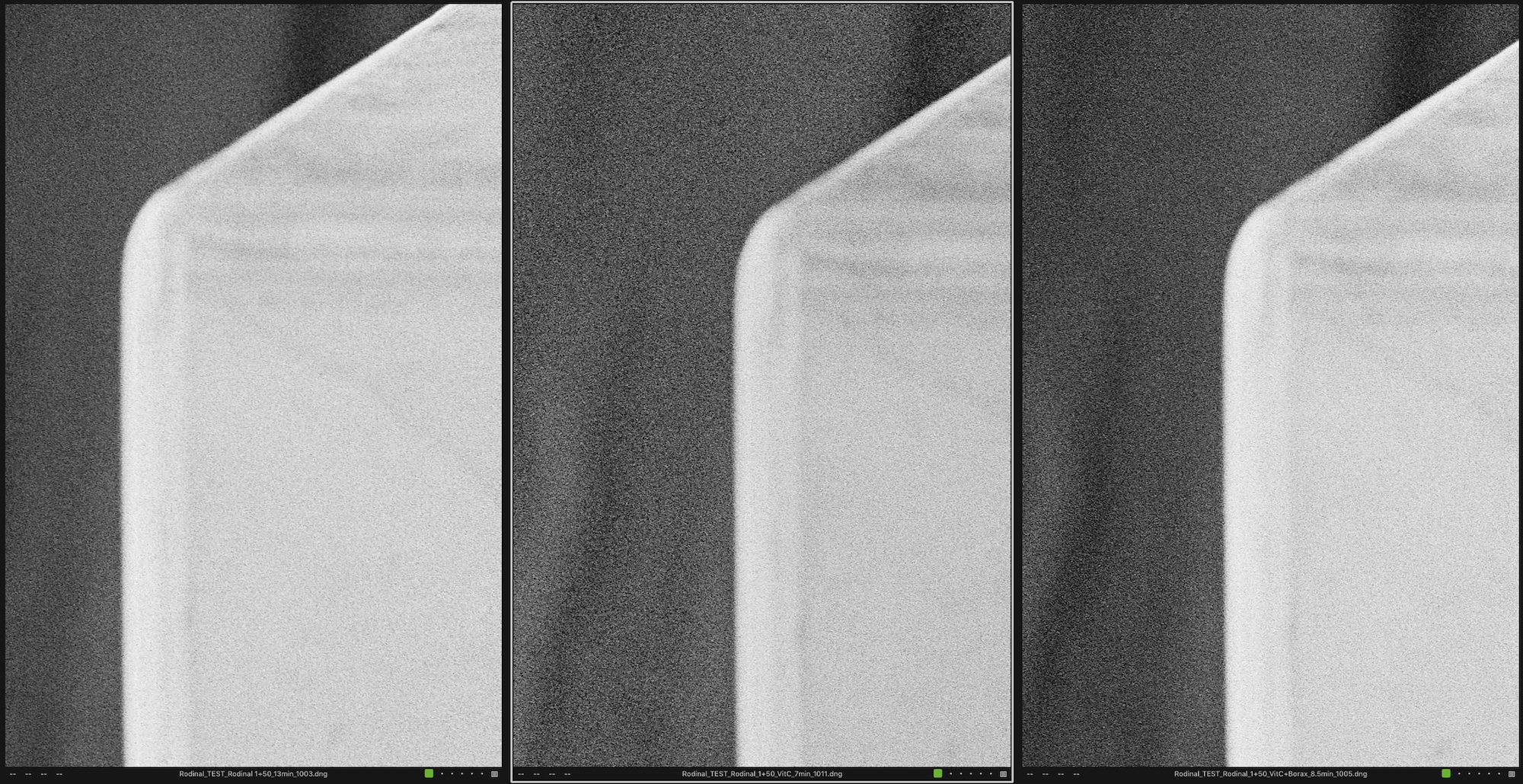

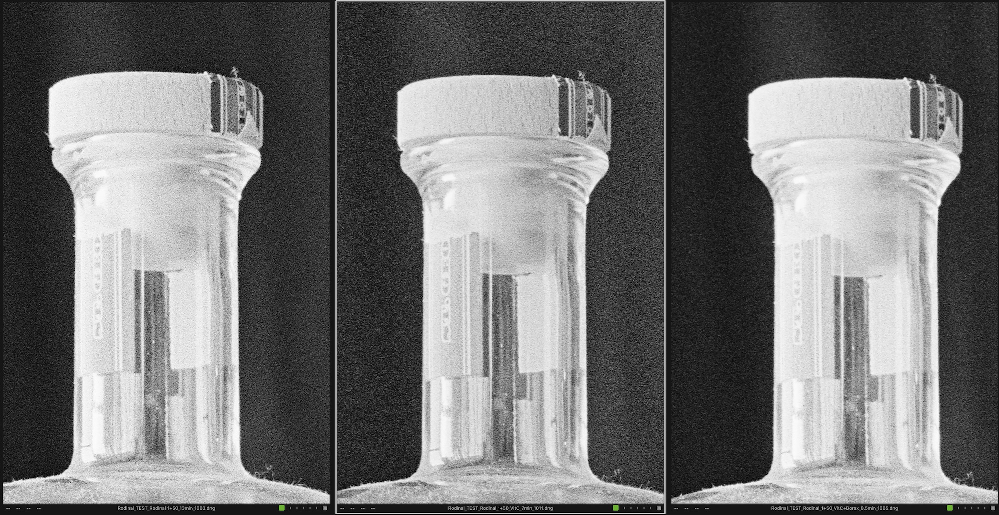

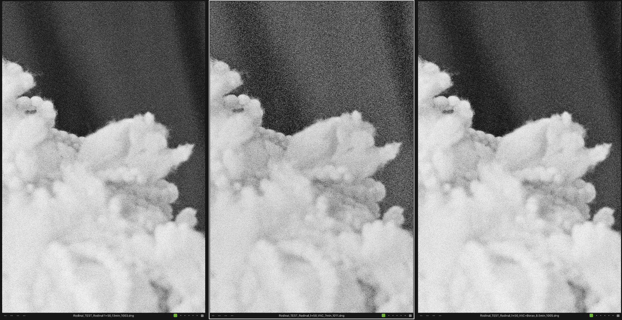

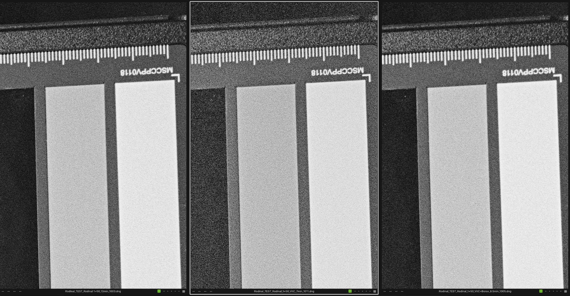

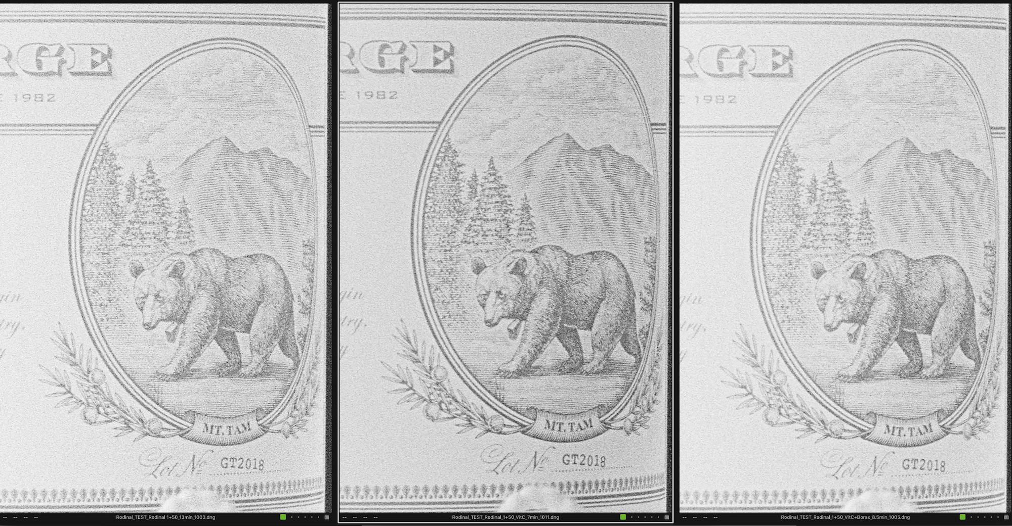

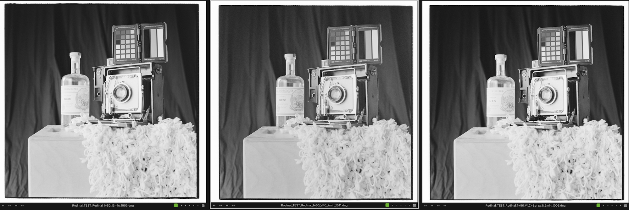

Here are screenshot comparisons and 1:1 zooms. White border is the scanner mask. Black borders/film rebates left for additional reference. Final images moderately resized to be managable on for web.
Left - Rodinal 1+50, Middle - Rodinal 1+50 with Vitamin C, Right - Rodinal 1+50 with Vitamin C & borax

My impressions:
-The Vitamin C (middle) recipe is extra grainy and has less shadow depth (is this the fog that people talk about?). Though the recipe is reported to reduce fog. Highlights feel more grey (and grainy) and pushed towards the midtones. This feels perceivably the sharpest because of the grain (acutance?).
-Rodinal only (left) and Rodinal/VitC/Borax (right) seem VERY similar. However, grain feels softened/reduced in the borax mix, resulting in blacks/shadows appearing deeper (less fog?).

What you take out of a test like this is always somewhat subjective, but I'd say that it suggests there is very little reason to tinker with rodinal as there are no very clear benefits to either of the modifications.
Any real benefit would be in the use of a different developer; if this is about optimizing grain (in the sense of reducing graininess while maintaining or optimizing film speed), I'd test rodinal side by side with xtol and see what happens...
Oh, and lest I forget; nice job on the test and the reporting. No, it's not entirely 'scientific', but it's systematic and transparent.
