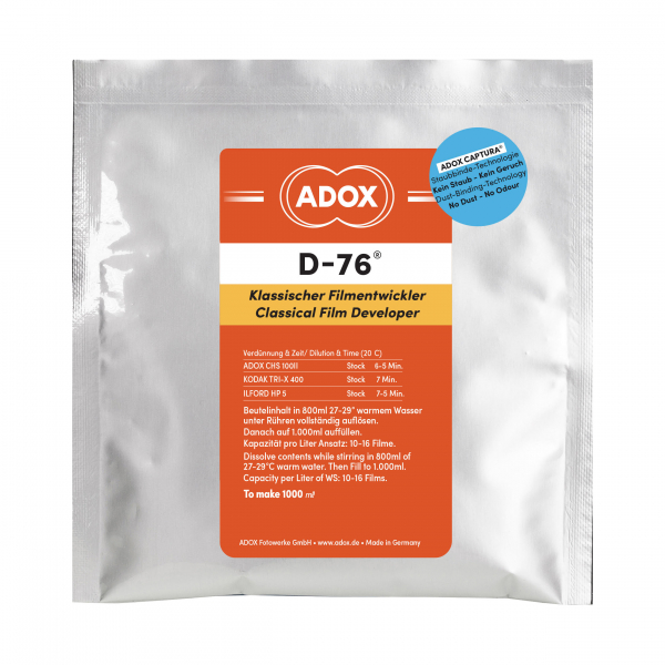

Adox , sold by Freestyle
MattKing
Apr 24, 2005
53,312
Delta, BC Canada
If I could get whoever's making now Kodak D76 in one liter packages, I would buy it.
Don't get me wrong - I have no problem with anyone choosing one of the competitive products.
It is important though to mention that though when you are using something else, even if it is designed to emulate D-76.

The formula for D-76 is pretty well known and easily made yourself from raw chemicals.

The Film Photography Project FPP-76 is pretty good stuff. Another member posted he found it close enough to the Kodak formula that it was hard to tell the difference. I would like to try the Adox version but it won't be in stock until the end of November. The exposures on the roll are all over the place and that's on me for not checking the shutter speed each time but the edge marking have a good density to them and are easy to read.
And the various commercial packaging options all differ in small but not insignificant ways - so it can really help to know which version is being discussed.
