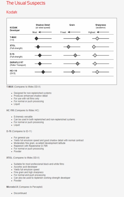

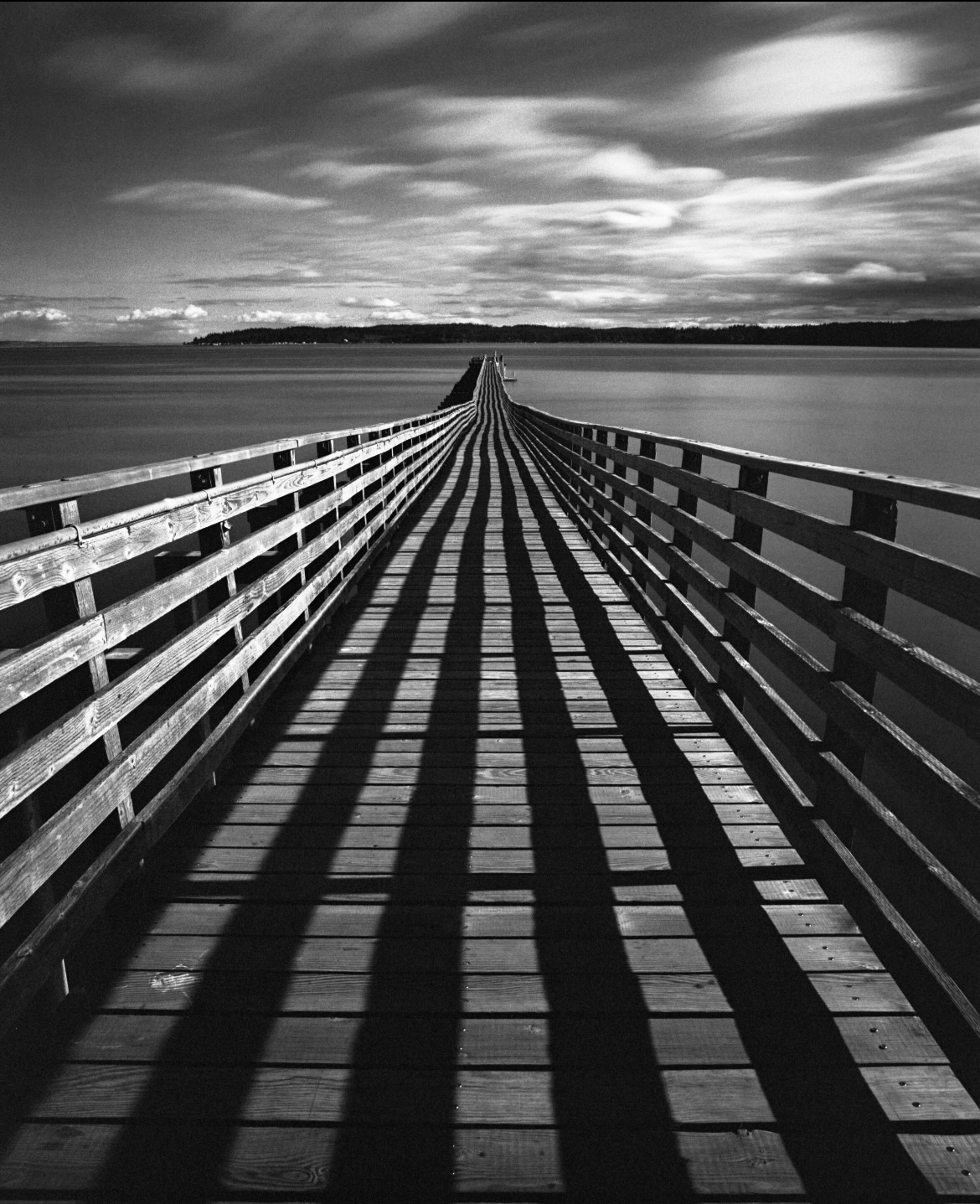

Here’s an edited shot of Tri-X in TMax 1+4. The contrast is bumped up a bit.

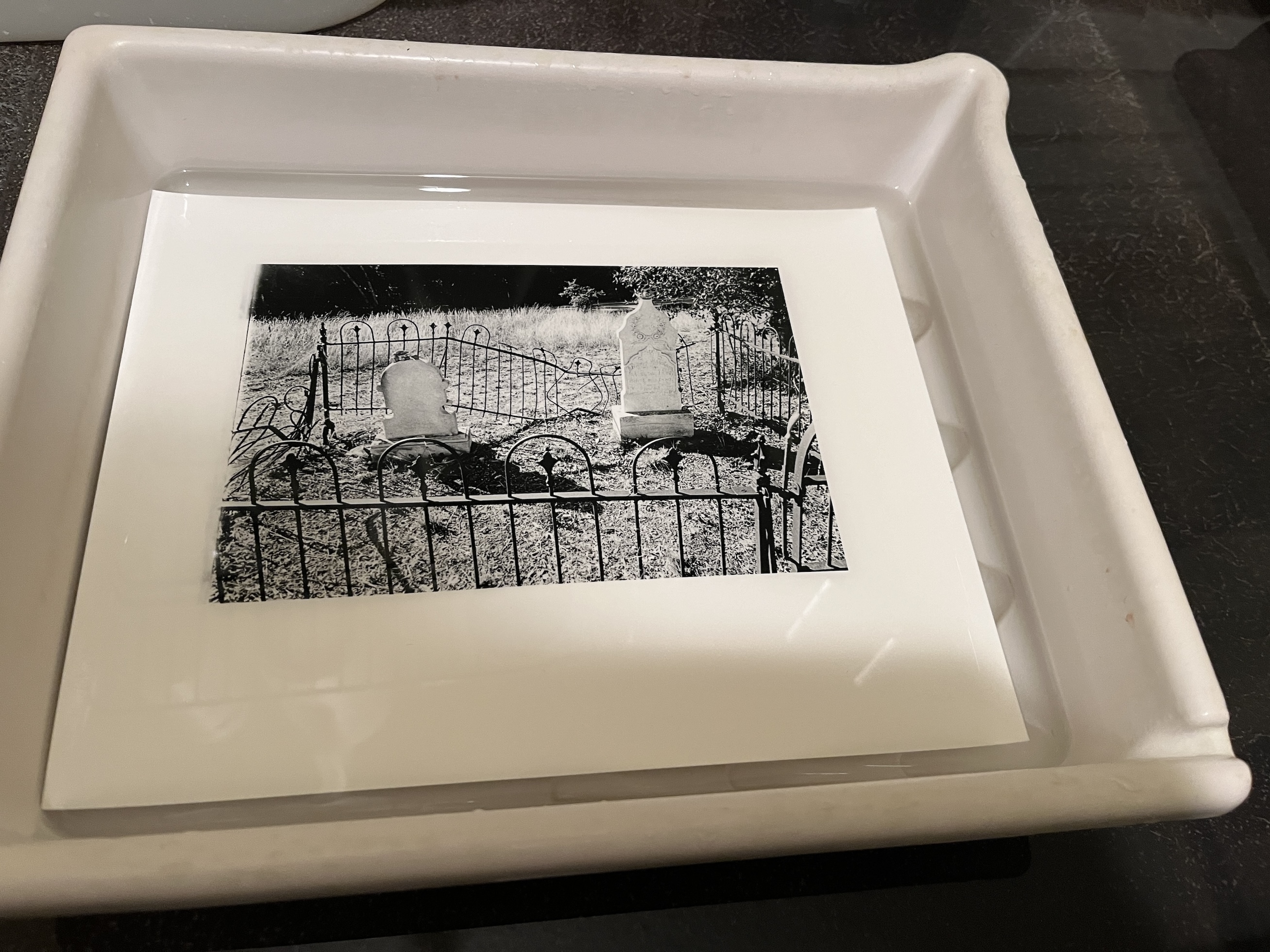

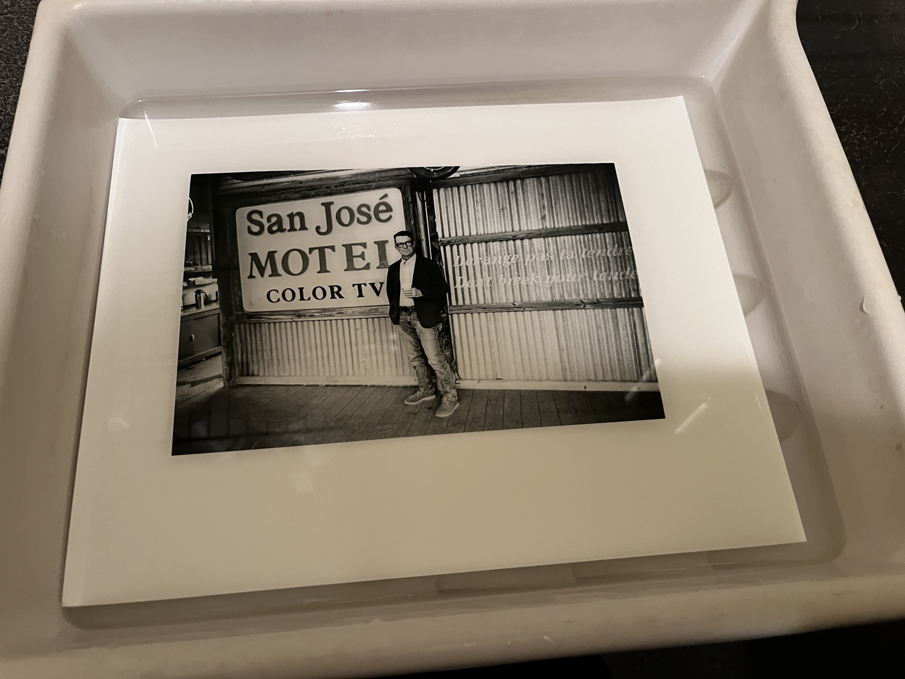

Tri-X negatives look pretty fine in Pyrocat HD.....just sayin'.....
Just happened to be in the darkroom. These two prints on the same roll....one shaded light, one harsh mid afternoon sun..... Tri-X in Pyrocat HD ....Leica M & Canon 28mm f.28 LTM (not the sharpest lens in the drawer, but i like the character).
