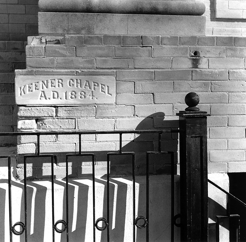

I've used D-76 for years, but HC110 is my standard developer for most B/W films now. Just a matter of convenience for the most part, but I like the results just as well.
This is a scan of a fiber print, but it doesn't do the original print any justice. My scanner's really old 🤓

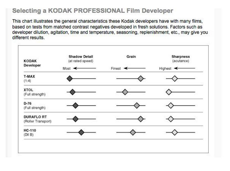

I found Tmax developer to be a great all-around developer. I use it for everything since about 1986. Foma, Agfa, Kodak, Shanghai, Arista, Ilford, etc. You can see in the chart how it compares to Kodak's other offerings. If you get different results with Tmax vs D76, there is some processing, mixing or storage problem. Powder vs Liquid; your choice.
