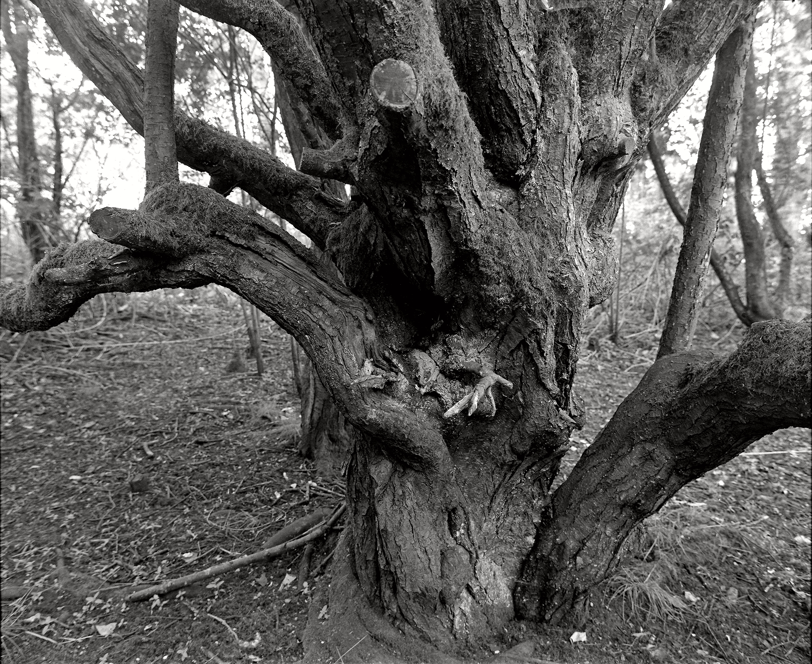

Current TMY-2 - which is my go to film now:
There are several more in the Photrio Gallery: https://www.photrio.com/forum/media/users/mattking.6437/
I don't know about you, but I find that the process of scanning and then squeezing the results on to the Photrio screen makes film evaluation suspect.

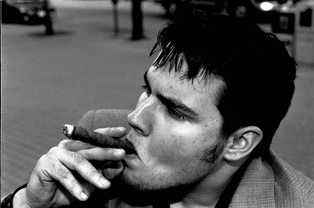

The varying skin tones with Caucasians looking darker in tone and that glow from highlight to darker in skin, is one thing I'm after. My Avatar is an example of that. It was shot on Tri-X back in 2005, but I know the film has changed since then. I see great skin tone shots on TMAX 400, so I wonder if it might give more of that effect then Tri-X. Plus to have a sharper finer grained film for some things would be a bonus. I shot a pic of my mom last year on Tri-X, and though it was indoors, it looked flat. Grainy as heck too. Part of that may have come from not developing it right away, but I send my film to a lab to process and print/scan. I don't have the desire to do it myself.
This webpage shows some good sample of skin tones off TMAX 400:
https://mrleica.com/tag/tmax-400-vs-hp5/
