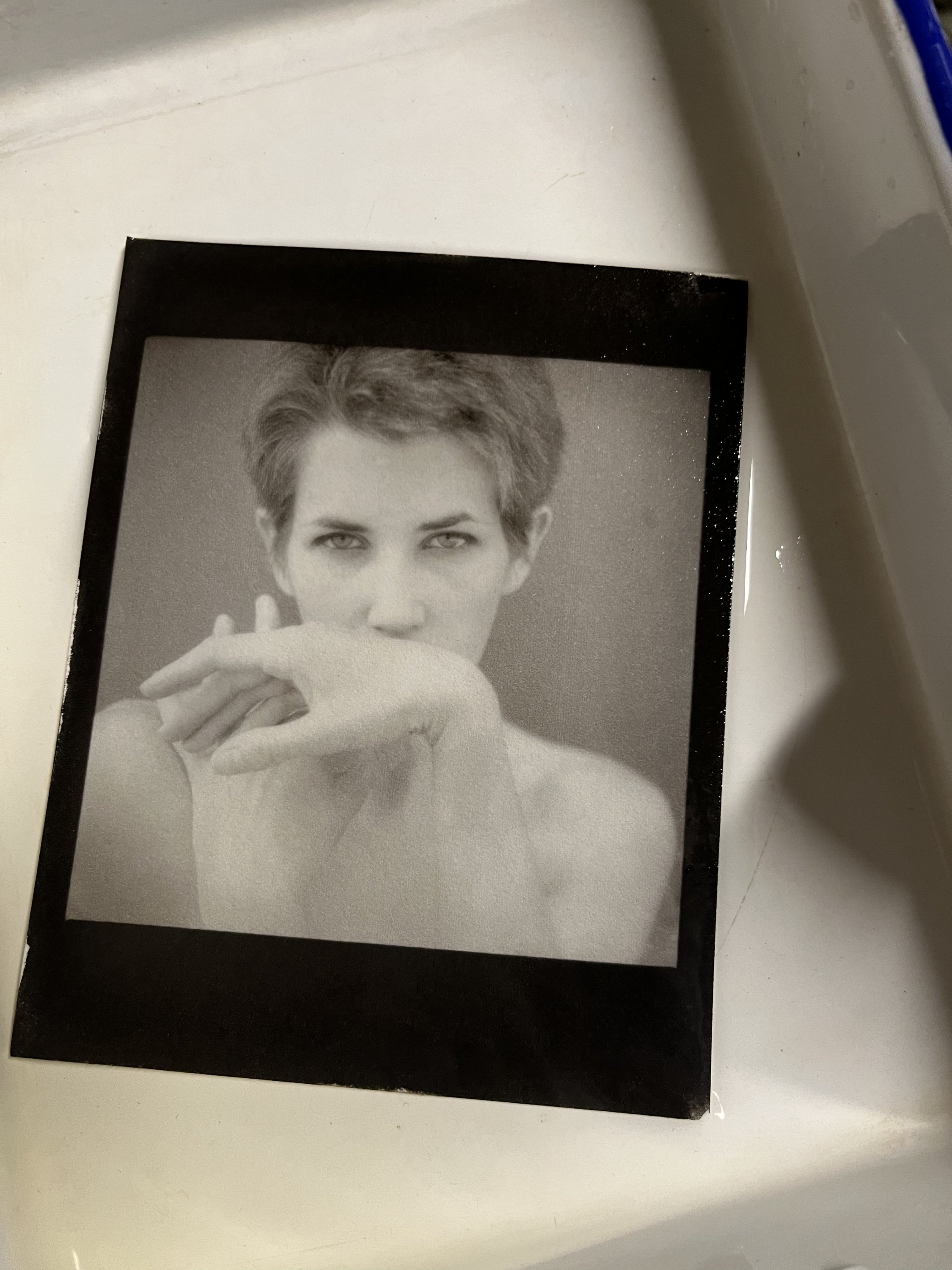

Sanders (Rolleiflexible) has dropped in a few times recently.
It would be great if he would post some more photos.
Matt! More pictures? You will be pleased to know I am dabbling in the dark arts of Kallitypes these days. Here’s a platinum toned Kallitype in the tray this evening, of a 2010 image I shot onto Tri-X @ 200ei. (I contact-printed from a digital negative — I hope the APUG gods don’t smite me for my transgression.)
best regards,
Sanders
