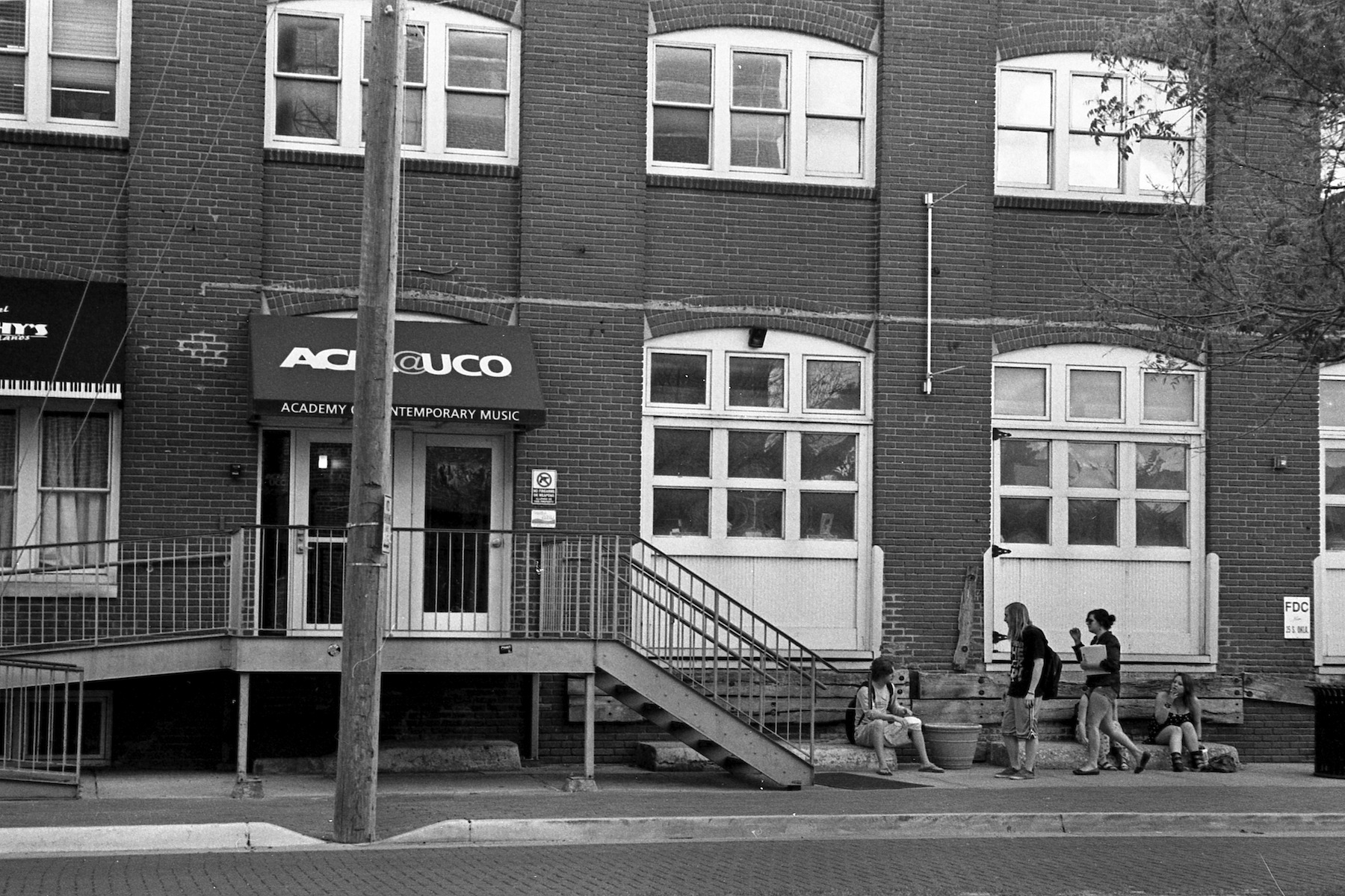

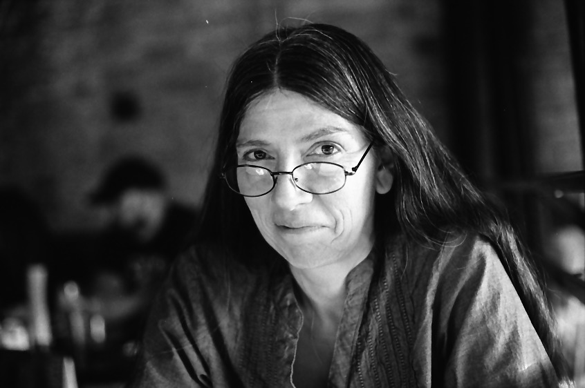

summicron1
Jul 28, 2010
2,920
Ogden, Utah
asa 1600 _0031.jpg good results by developing it for 12 minutes in 1;1 D-76, as per the kodak datasheet. asa 1600 _0015.jpg
