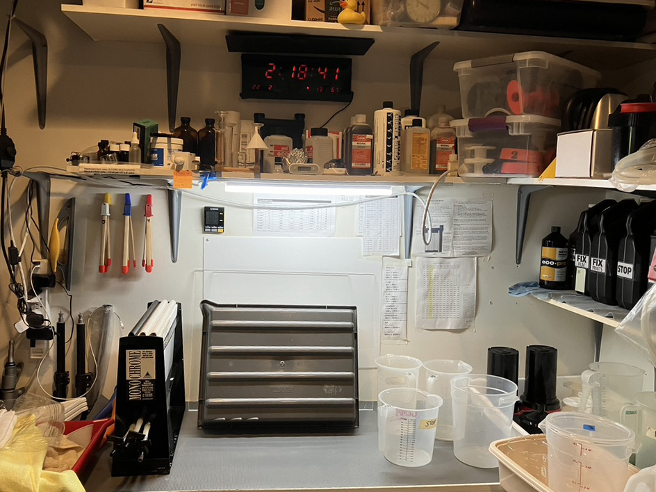

I would stick with the NOVA. I don't find it to much of a bother to drain--I drain it into 1-gallon water jugs, set on a stool so I can tilt the processor as the levels get lower than the spigots. The last bit gets emptied into a small tray by inverting the processor. I only rinse it once a month, taking it outside and using a garden hose. The footprint and solution life far outweigh and disadvantages for me. BTW, although NOVA does not recommend the Monochrome slot processor for FB, I use it that way all the time and never have had any problems beyond some fine bits of fiber floating in the fixer, easily removed.
I have the Monochrome model as well and have always used it with FB. I've had absolutely no issues with doing that. I do have additional clips that make it easier to move FB paper in and out of the slots.

I still think the NOVA is the way to go. My darkroom has no plumbing, the processor is on a table/work surface. I would think you could find something to cover the processor so an inquisitive child or pet could not get to the chemicals. Maybe an inverted storage container. It would take a lot to tip it over when full--I don't think that should be a concern, especially since it is not on the floor.
Also, I find that adding fresh developer when the level drops about an inch lets me make a few dozen prints before draining. I use pretty standard pitchers to fill the process and have not had the need to use a funnel.
