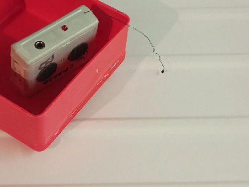

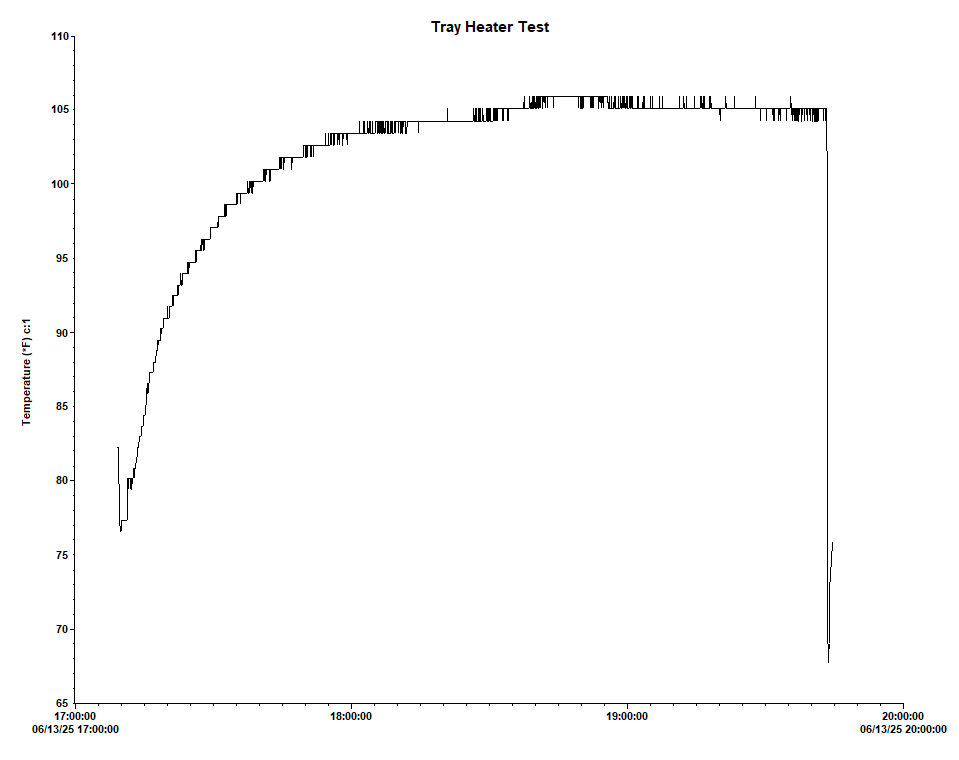

OK, I placed a 11x14 tray with 2L of room temperature water on the mat and set the mat to 212F. I placed one of my Onset Hobo data loggers in a small Schaller box to keep it dry and dangled the sensor bead in the water in such a way as to prevent it from touching the bottom of the tray.
