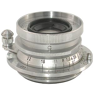

Not being a Voigtlander user myself I would not feel qualified to comment on the camera but lens wise. If it were me it would have to be a 35mm lens, and from my own use experience, if you could stretch the purse strings to a 35mm Summicron I don't think you would be disappointed. I have a 35mm Summicron asph but the pre asph is fine and produces sensation results and is considerably less money second hand. You could also consider a 35mm Collapsable Summaron which works very well without a hood and is extremely compact
Note that the 35 mm Summaron is not in fact collapsible but it is very small and highly affordable in comparison with the (admittedly better) 35 mm Summicrons.
