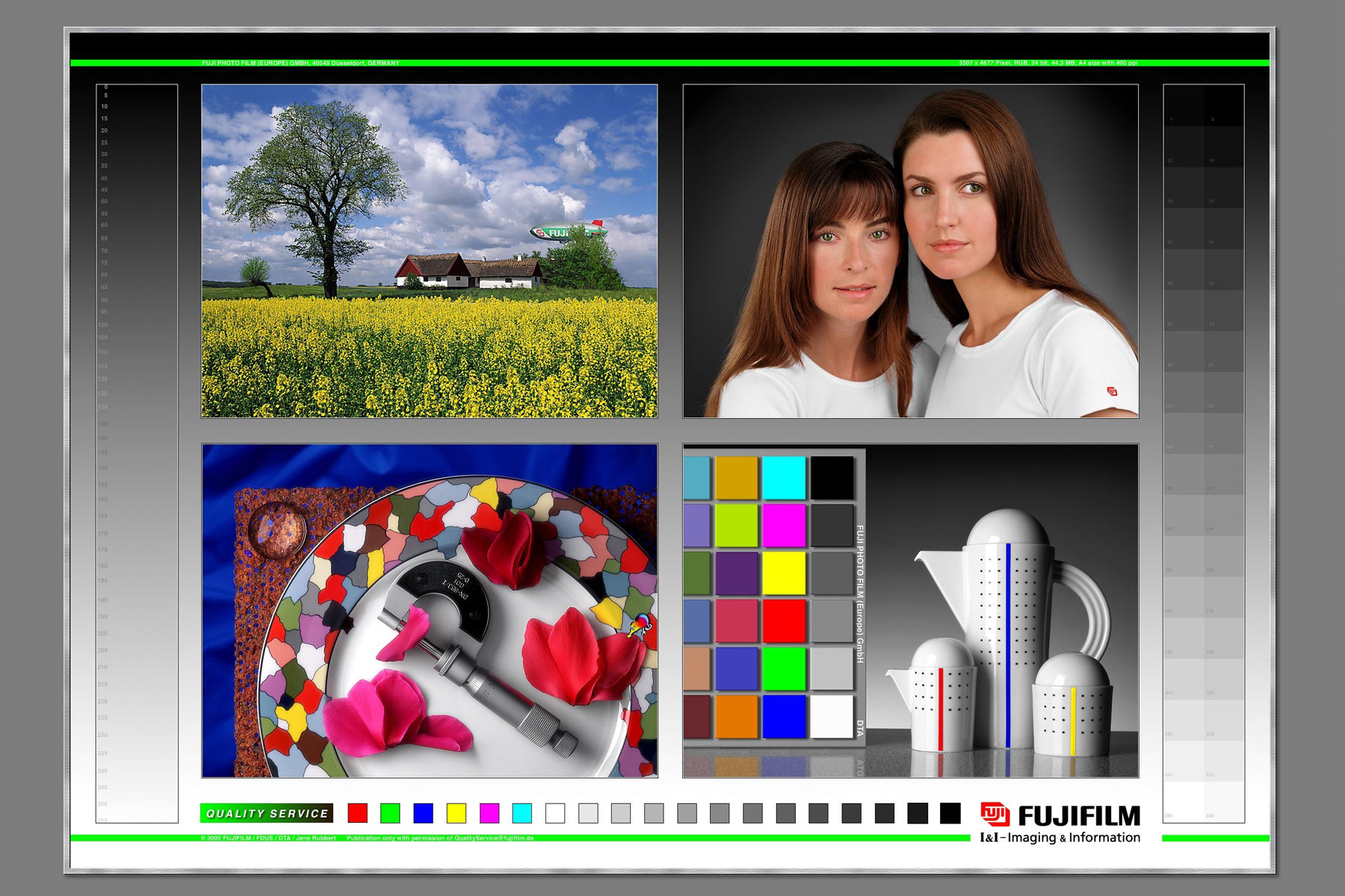

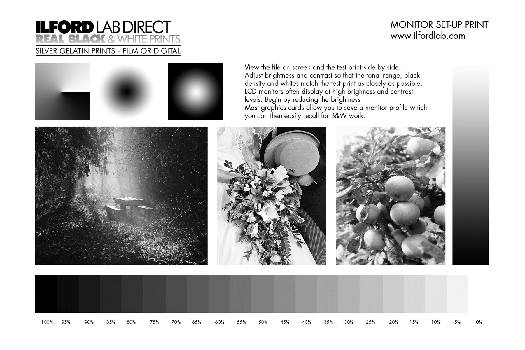

Three years ago I went to a Fuji Frontier dry lab (inkjet) demo. I brought along two silver halide prints, each in 6x4 & 8x12inch in luster (matte) finish, that I had printed on my own Fuji Frontier 7700 wet lab.
I also had the same two digital files on a USB drive. It was these two images, for reference.
We printed out, on the dry lab, a set of prints in the same sizes and finish as the ones I had brought. We lay them side by side on the table and asked 4 people from the office to come in and pick the wet and dry prints. They could only tell the difference when they picked up the print. The drylab print surface feels slightly tacky.
Other than that, they thought they looked the same.
I brought all the prints back to my shop and did a similar survey with customers at the counter. Again no one saw any difference.
I use this as an example, as the OP had asked about prints from a lab.
If you make prints on a home inkjet, well that can be completely different as you have other factors like, paper quality, printer quality, ink quality.
We lay them side by side on the table and asked 4 people from the office to come in and pick the wet and dry prints. They could only tell the difference when they picked up the print. The drylab print surface feels slightly tacky. Other than that, they thought they looked the same.
