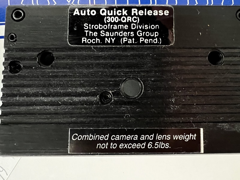

This item appears to be a quick release of some kind. It says the max weight is 6.5 pounds. Is this sufficient for this camera? Is this an OEM component that comes with the VX125?

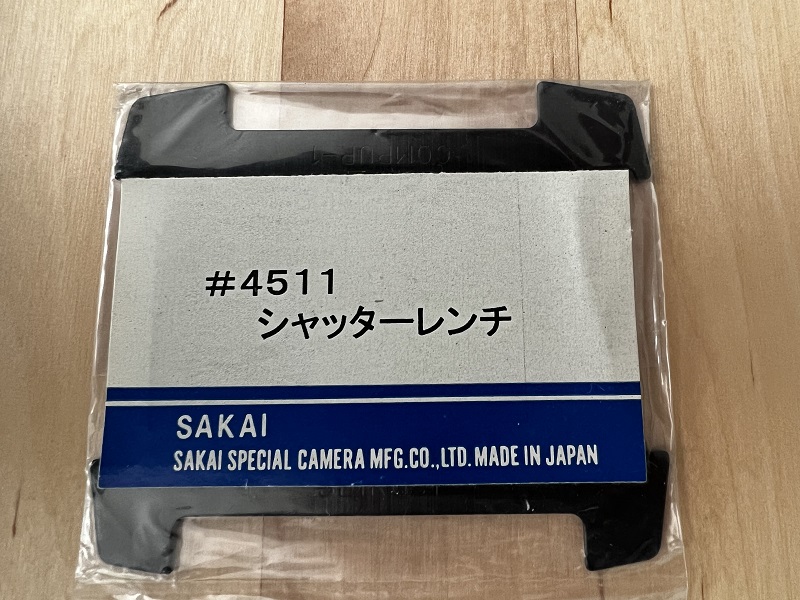

Second question: this came with the camera. I don't read Japanese--anyone know what this is and what it's for?

The stroboframe quick release in good but not for the vx, up to a light 4x5 field camera( crown graphic)
The second thing is a shutter retaining ring wrench (locknut)

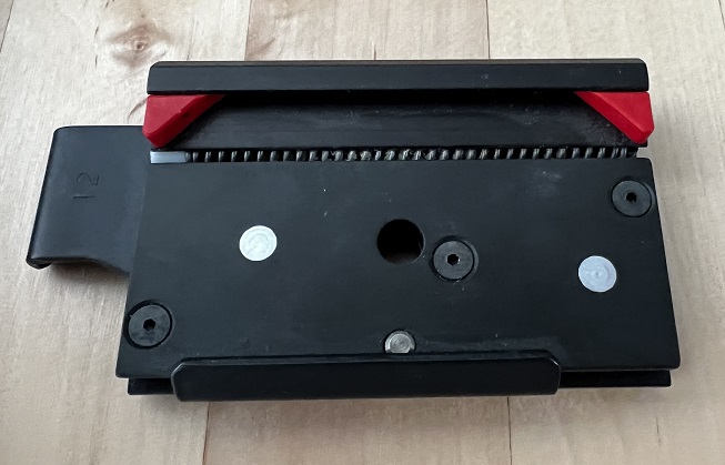

The VX125 which have a telescoping rail use a special quick release.
Please post a photo of the other side.
Edit: I suspect that is the quick release for your camera - if it has the telescoping rail.
Here it is:
That is the correct quick release for the VX125, IIRC the dovetail of the telescoping rail slips in and displaces the red tabs and hence locking. I've also seen people modify the dovetail itself to fit directly into an arca swiss clamp.

The 4511 is a shutter wrench... used to tighten the retaining ring on the back of the lensboard
