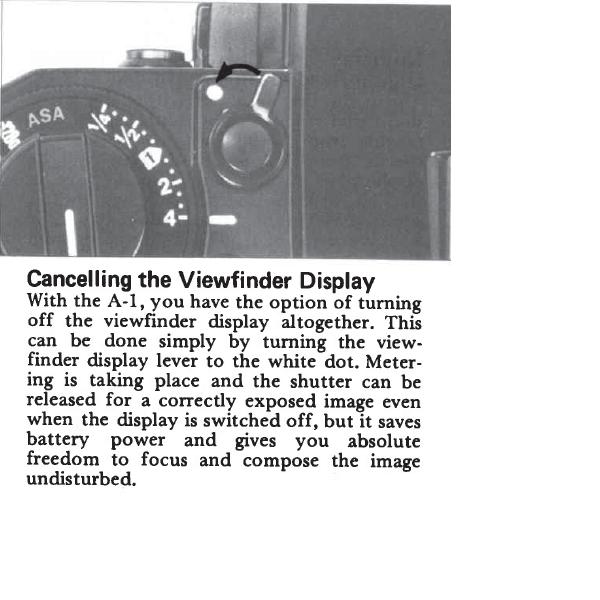

The Canon A-1 is a great camera. (I have two of them!) As long as it works, and doesn't have the annoying "squeak", you son will have a good camera to learn photography. There are also lots of great FD lenses out there which can be obtained at a good price. I would suggest sticking with the A1 and maybe looking into getting a new lens, or perhaps some darkroom equipment!
The A1 can be used in an all manual mode:
1. Set the camera to TV so you can now set the speeds manually
2. Disengage the aperture ring so you can now change the apertures manually
3. Switch off the Viewfinder Display. (See attached jpg.) Metering still takes place, but you don't see the suggested value. Also, because the camera is now in fully manual mode, you are free to set whatever exposure values you want.
Voila, a fully manual camera!
