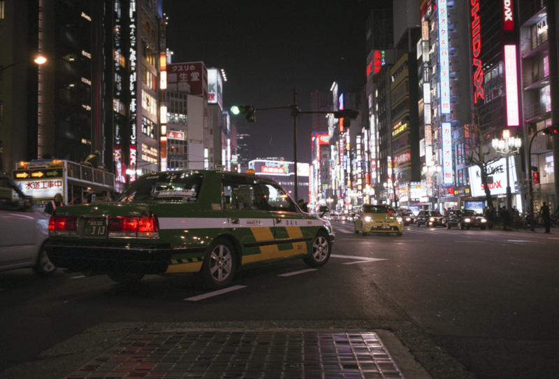

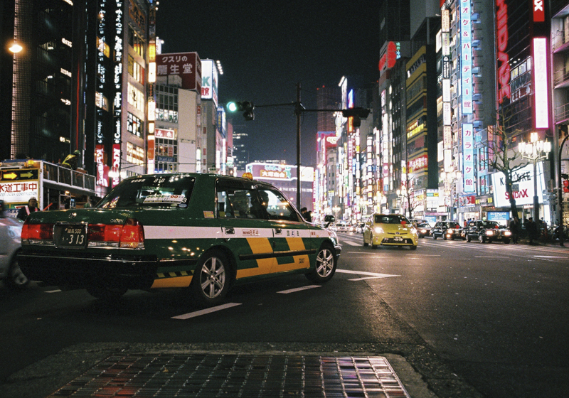

The first image was scanned by my lab and the second one is a result of Vuescan and ColorPerfect.
I locked the film base color after reading it from the film leader then scanned the film raw, with no adjustments in VueScan and converted the tif to positive in ColorPerfect using it's profile for Natura1600 film. It was considerably darker, so I added a stop of exposure in Ps. But still, my scan is nowhere close to being as vivid as the labscan.
Am I doing something majorly wrong here?

I like your version better, it looks more natural ( at least on mine calibrated monitor ). Lab version has more contrast and less details in highlights than yours. Attached is your file + I added curve in PS and clicked on auto.

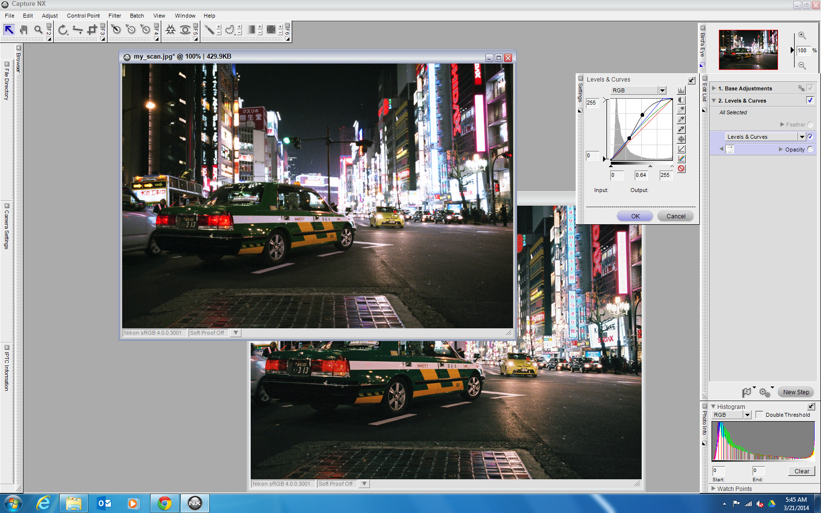

Don't try to make this too complicated. Locking exposure and film base when you start a roll is good, I use those options most of the time. Just make sure you get the black point and white point set correctly for each image then get close with the color balance, either manual or auto or right click on a neutral grey point. Forget about all the film options and just use the color negative default of generic color negative. Scan and save as a a jpg (or tiff if you wish) then edit the tone curves in a good image editing program to suit what you want. In many cases the individual color curves will need to be non-linear to get the desired result. See the screen cap below. I used Nikon Capture to edit your scan to look similar to the lab scan you like. Yours is on top and you can see I tweaked the green and blue color curves and then did quite a bit of twisting on the tone curve to get the contrast up. It's really quite simple once you get the hang of it and you don't need to screw around with color profiles that aren't really accurate or representative anyway...... VueScan is an awesome tool and offers much more than other scanning software that I have used but you need to know how to get the best out of it then know when to move on to your image editor.

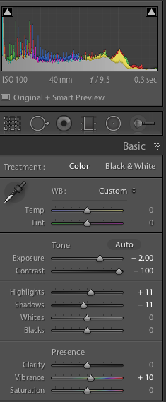

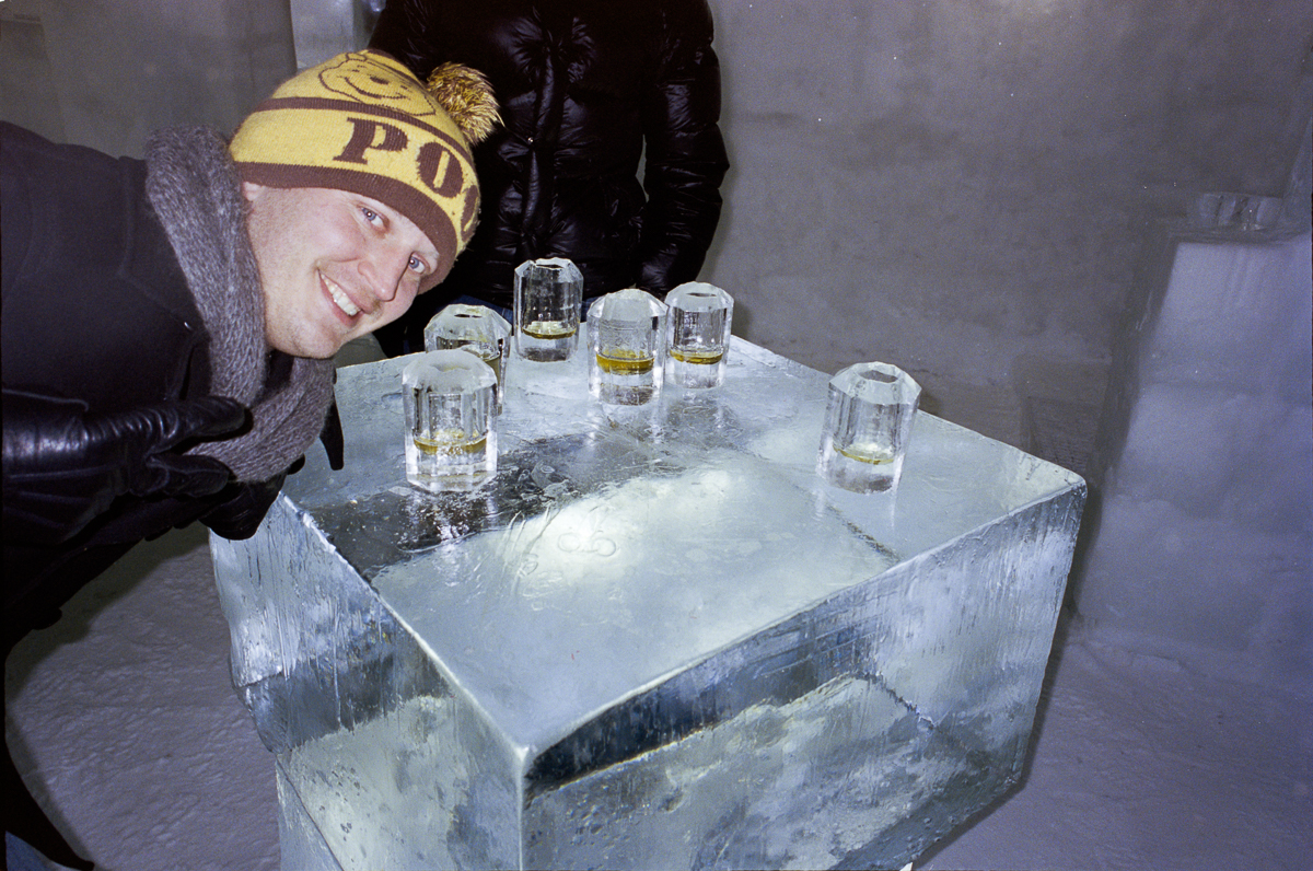

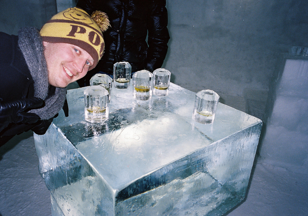

Lamar, I tried again and don't really get close.
First one is the lab scan, second is my scan.
Linear tiff with MakeTiff
ColorPerfect inversion with white balance adjustment
then added the adjustments in the screenshot in Lr. But still my photo looks flat compared to the lab scan.
I tried adding medium contrast curves in each of the channels, but that doesn't work either.
any other suggestions or tips?

Some of it may be their scanning equipment. It may get better raw data to start with. I think if you can play a bit with manually tweaking points on the tone curve you can make it look a good bit better. It takes some practice. I don't use Lr so I don't know its capabilities. I use DxO Optics Pro and Capture NX. Both allow me to do whatever I need to the tone curves. In addition DxO has some great tools for getting the most out of shadows and highlights without loosing detail.
